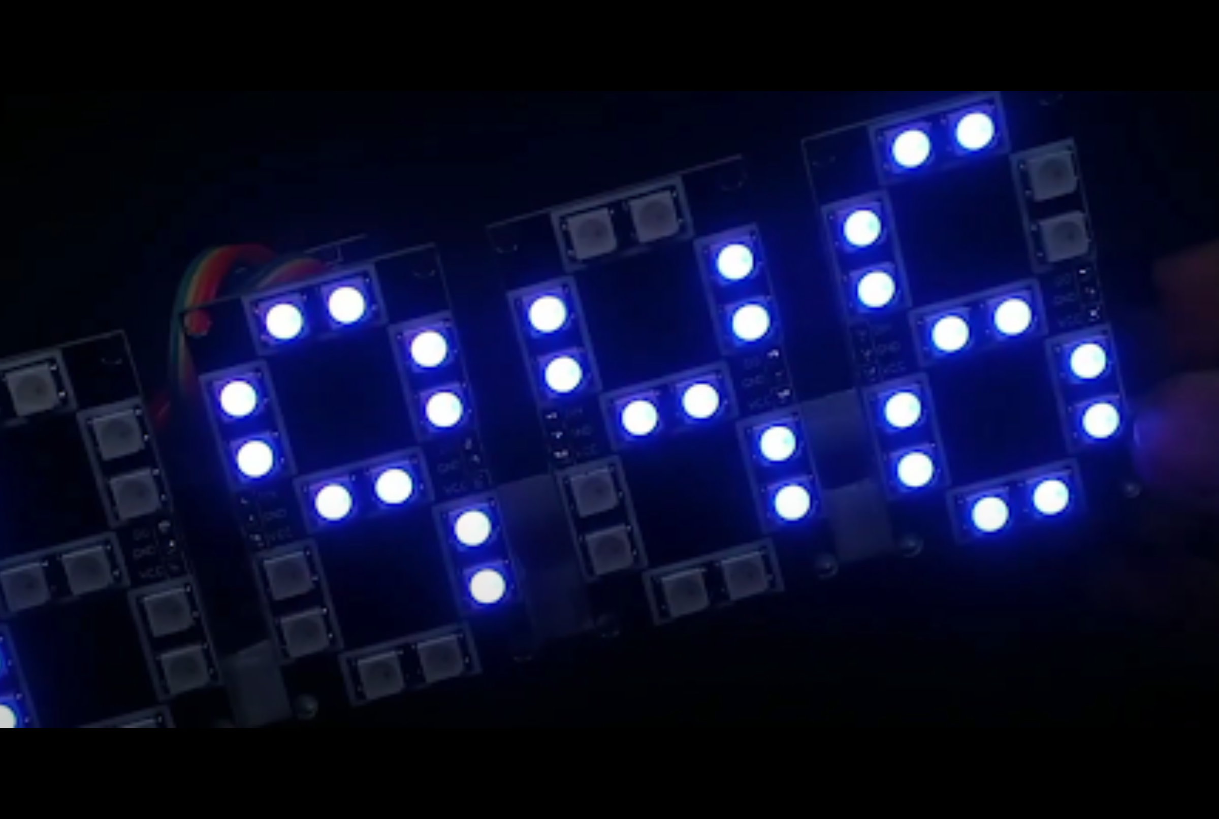

Step 10: Different Emojis Through Dot Matrix
These are some different emojis we try to create and show on this project.
Step 11: Text Scrolling on Dot Matrix
