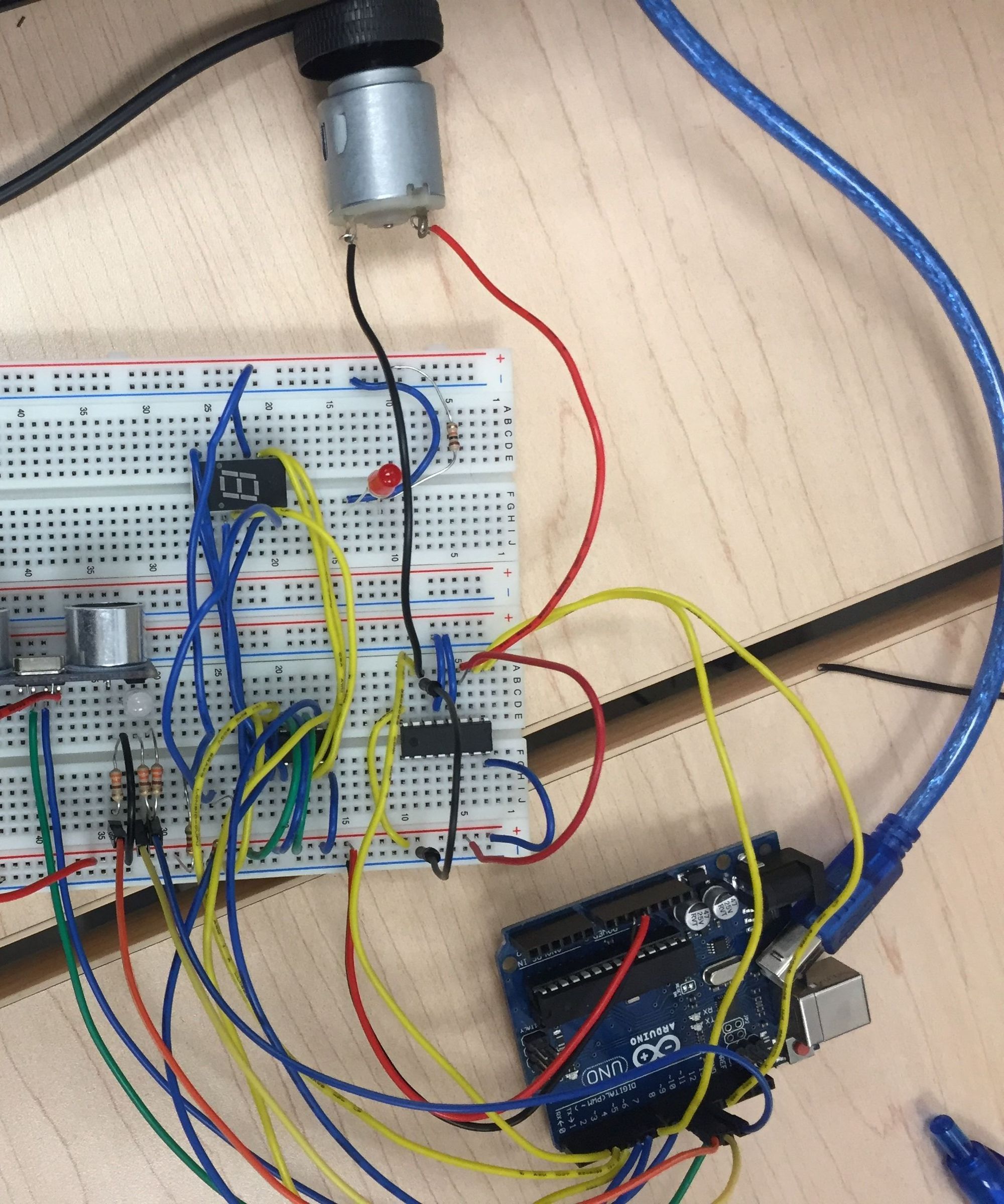

Step 2: Step 2: Setting Up Dice Layout
*Make sure you put a wire from the 5V pin on the arduino to the RED positive rail on the breadboard and the GND pin to the BLUE positive rail on the breadboard.*
First, you will want to set up the LED's in a dice layout like I have done in the picture. After that, you will put a resistor on each of the short pins on the LED's. Then connect longer wires from the long pins of the LED to the digital pins on the Arduino. Personally, I put them in random order from pins 2-7 & 9. Then, to install the button, you will want to put it on any free space on the breadboard like I have done and connect it the way I have connected it. Connect the blue wire to pin 8. For the buzzer, simply find another free space and wire it as I have done. The yellow wire connects to the ground rail and the red wire connects to pin 11 on the Arduino. Congrats, you are done the Dice part of the project. Move onto the next step for the optional dot matrix part of the project.
Step 3: Step 3: 8x8 Dot Matrix
In this step, you will create a small dot matrix to spam a bunch of numbers when you win (get a 1 on the dice).
You will follow the diagram to make sure you wire it properly. Make sure that the part of the matrix with the numbers is on the bottom when you are wiring it. Replace the pins it tells you to put in the Arduino with,
Pin 9 - 10
Pin 11 - 13
Pin 12 - 12
