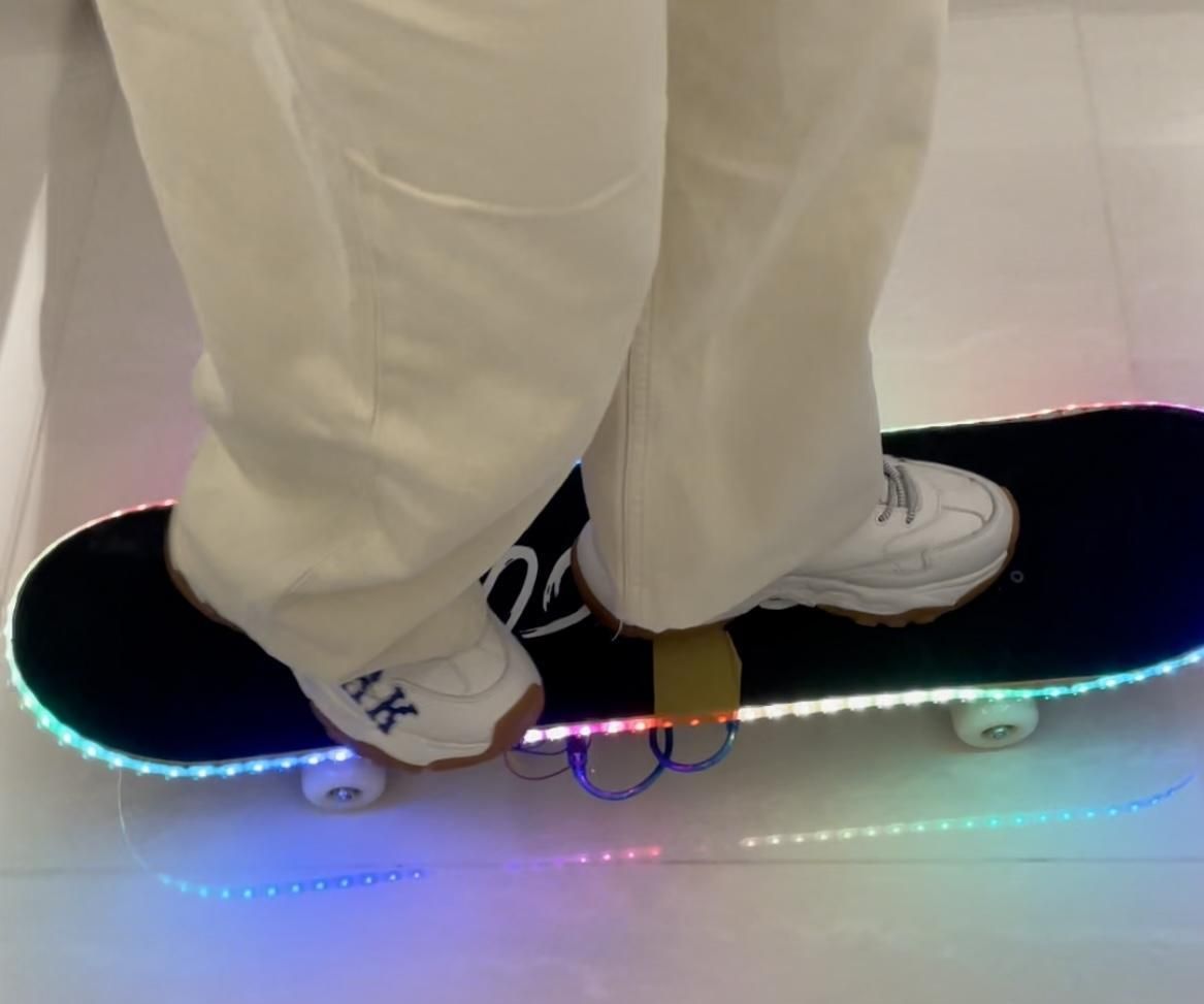

Use tape to stick the whole board and the portable charger underneath the skateboard, so while skating, it works at the same time.
Step 8: Finish Product
This is how the product looks like!!!
You may also take pictures using long exposure.
