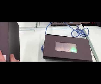

Step 7: Making Theremin Enclosure/Theremin Wiring Part
The main body of the theremin is a paper box. I then proceeded to cut 7 slits, spaced it apart, with a knife and scissor. Then I test fit the LED's.
Connect your orginal wire with another one to make it long enough to plug into the hole you just made.
Step 8: Light Theremin
Now that it's all wired up let's try out our new Light Theremin :)
