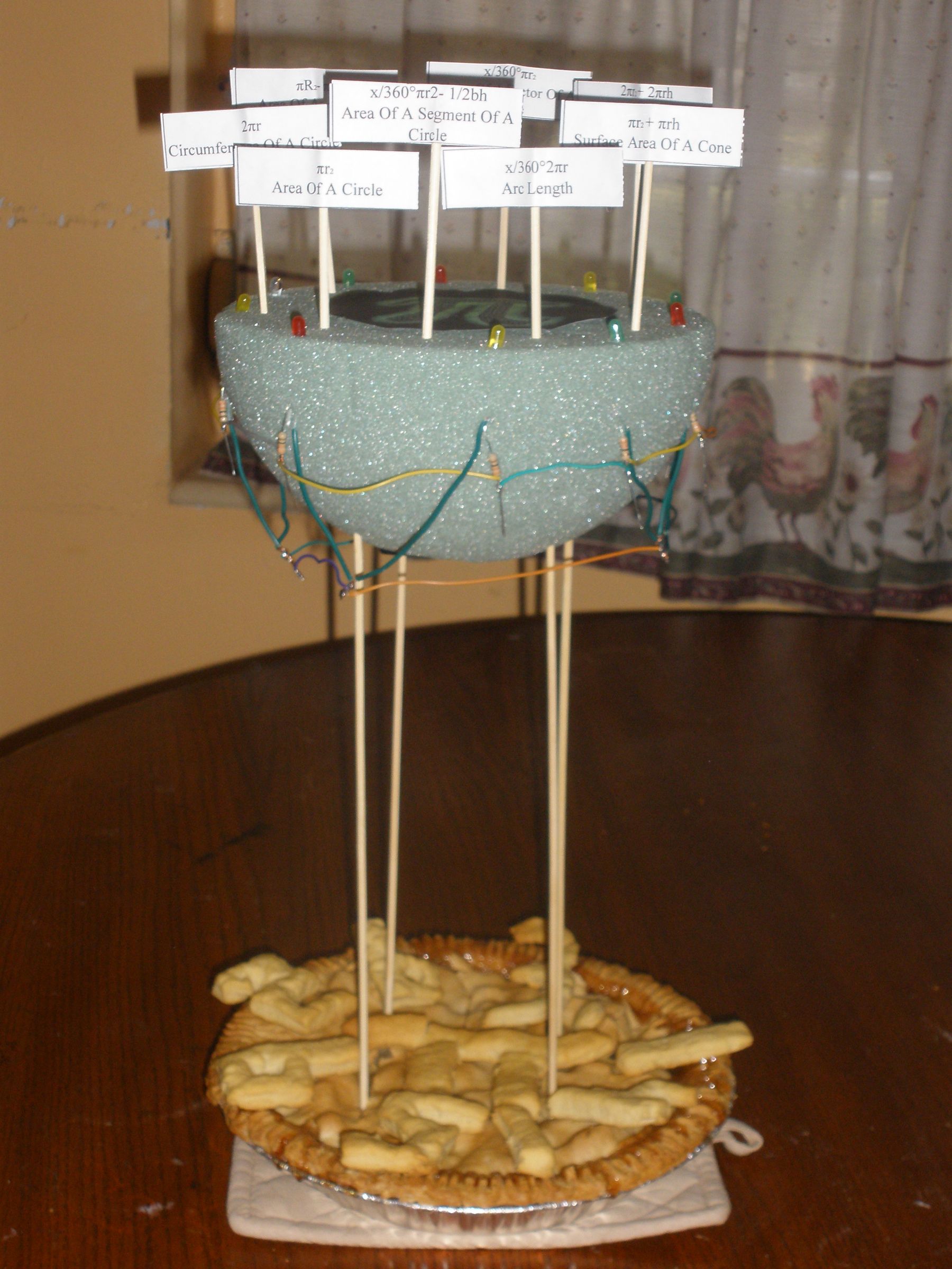

Step 5: Finished Product
The Finished Product Should Look Like This
