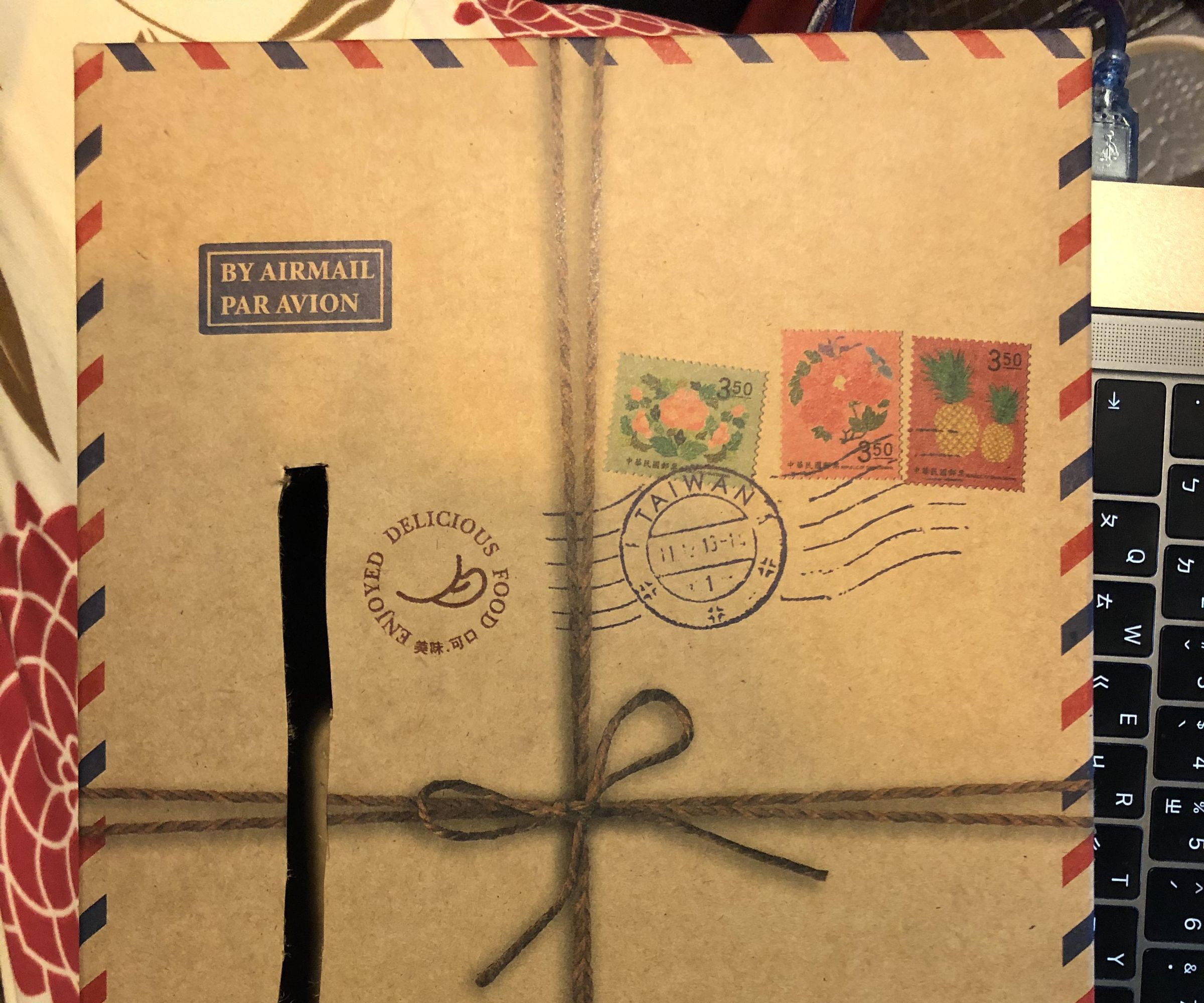

So now the LED light and the speaker will turn on when the phone is taken, and it will message my mom.
I put it in a box to cover the cables and other stuff to make it prettier and neat. You can add some decorations to the box but I think white is clean and my brothers won't know that it is a machine, it probably works better.
