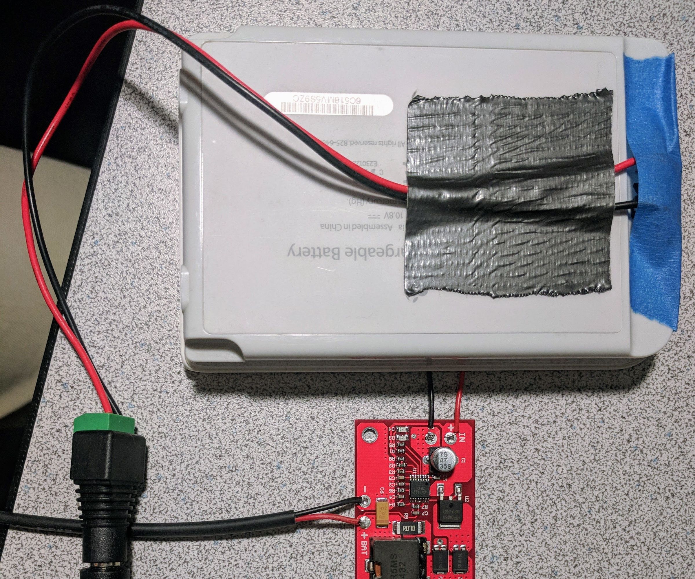

This change add an adjustable current output, suitable for battery charging. The current can be changed though the serial terminal using 'O' and 'L' key. The output voltage is fixed to 14V in the firmware. This makes a simple battery charger possible.
