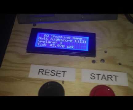

The LCD is an serial LCD it uses only 3 pins on Arduino.
Connect the ground to ground on arduino, the 5v to 5v out on arduino and the read pin to pin 1 on Arduino.
For the start and reset button i used Arcade buttons (they are big and i like them)
The reset button is added between the ground and the reset pin on arduino.
The start button is added between ground and analog 4 pin.
The game has a game switch to choose game mode. There are 3 types of games right now,
1. Quickfire
2. Timed mode
3. Rapid fire
For this i used a rotary switch to switch game mode.
They are going to be added to digital inputs on Arduino so the incoming signal is going to ground and the three game signal is going to digital pin 2, 3 and 9
