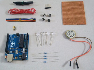

STEP 1: Parts and Tools
Here is all you will need:
(1) Arduino UNO R3
(4) LEDs (Red, Green, Blue, Yellow)
(4) Push Button (small)
(1) PCB Matriks / Perfboard
(1) Speaker 8 ohm (0,5 watt)
(4) 100 / 330 ohm resistors
(1) 9V battery
(1) 9V battery box with on-off switch
(4) Spacer 0,5 cm
(1) Project enclosure (I'm using "Kitchen Ware" box)
- Breadboard
- Shrink tubing
- Jumper wire
- Rainbow wire (optional)
- Male header extended
- Blackhousing / female 1x1 header (optional)

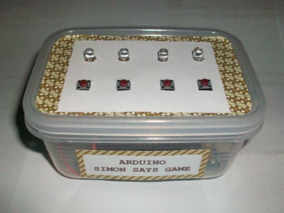

STEP 6: The Enclosure
Step 1
Drawing the pattern on "Kitchen Ware" Box with marker for placing the spacer for Arduino. It's really helps for drilling. (See image 1 and 2)
Step 2
Be careful when you drilling the "Kitchen Ware" Box, because it made of plastic. It easy to melt if the drill get hot, but it's okay you can tidy it up by using a small cutter knife.
Step 3
Put the Arduino to fit with the box, and draw a pattern for jack power and USB socket. (see image 3)
Step 4
Drawing the pattern on the top of the box with marker for placing the push buttons and LEDs. It's really helps for drilling. (See image 4)
Step 5
Don't forget to make a hole for the speaker. I put my speaker on the other side of the box.
Step 6
There will be some scratch and some little cracks on the box, you can covering it with the colour paper or paint it.

STEP 8: Finish !!
You can let the box being transparent or you can paint it, but for me I covered it with Batik pattern for looking better and because Batik is a National Culture and Identity of Indonesia :)
Don't forget to give me a feed back or advice because I'm just a beginner.
