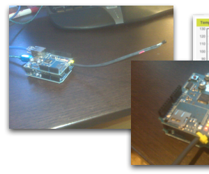

Set-up
The Arduino Uno and Ethernet Shield are simple to connect, the Ethernet Shield plugs into the top of the Uno board and by plugging in the USB cable, both are powered and ready to go. The temp sensor requires a little breadboard work or soldering. I choose to create a little cable (~6 inches) to keep the temp sensor away from the heat coming off the boards. This DS18B20 sensor is great because it can be powered with the data signal using parasite power. I recommend reading up on the data-sheet on this option, but essentially the sensor grabs a little power off the signal line when it is a high logic level. So two-wires can be used, a ground and the signal with a 4.7k pull-up resistor on it to 5V. I chose the Arduino Uno's signal pin 7, since it is not being used for anything on the Ethernet Shield. I used enough wire for about 6 inches of length and once connected, used heat-shrink tubing to wrap it all up. (Note: I've tried putting these temp sensors right on the main board, but the heat from the power regulators and chips affects it greatly.)
