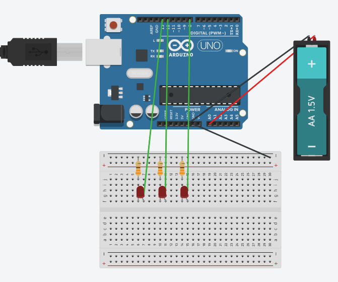

Introduction: Arduino Temperature Sensor Project
This circuit simulates a thermometer
The top number on the LCD Screen is the room temperature
The bottom number on the LCD Screen is the desired temperature
The LED light turns on when the desired temperature is lower than the room temperature. This simulates a fan.
One potentiometer controls the LCD display
One potentiometer controls the desired temperature
24 * Jumper Wires
1 * Arduino Uno (And USB Connector)
1 * LCD Screen
1 * LED light
1 * Temperature Sensor
2 * Breadboard (Small)
2 * Potentiometer
2 * 330 OHM Resistor

Step 2: Build
The circuit:
* LCD RS pin to digital pin 12
* LCD Enable pin to digital pin 11
* LED to digital pin 8
* LCD D4 pin to digital pin 5
* LCD D5 pin to digital pin 4
* LCD D6 pin to digital pin 3
* LCD D7 pin to digital pin 2
* LCD R/W pin to ground
* LCD VSS pin to ground
* LCD VCC pin to 5V
* 2 * 330 resistor:
* ends to +5V and ground
* wiper to LCD VO pin (pin 3)
