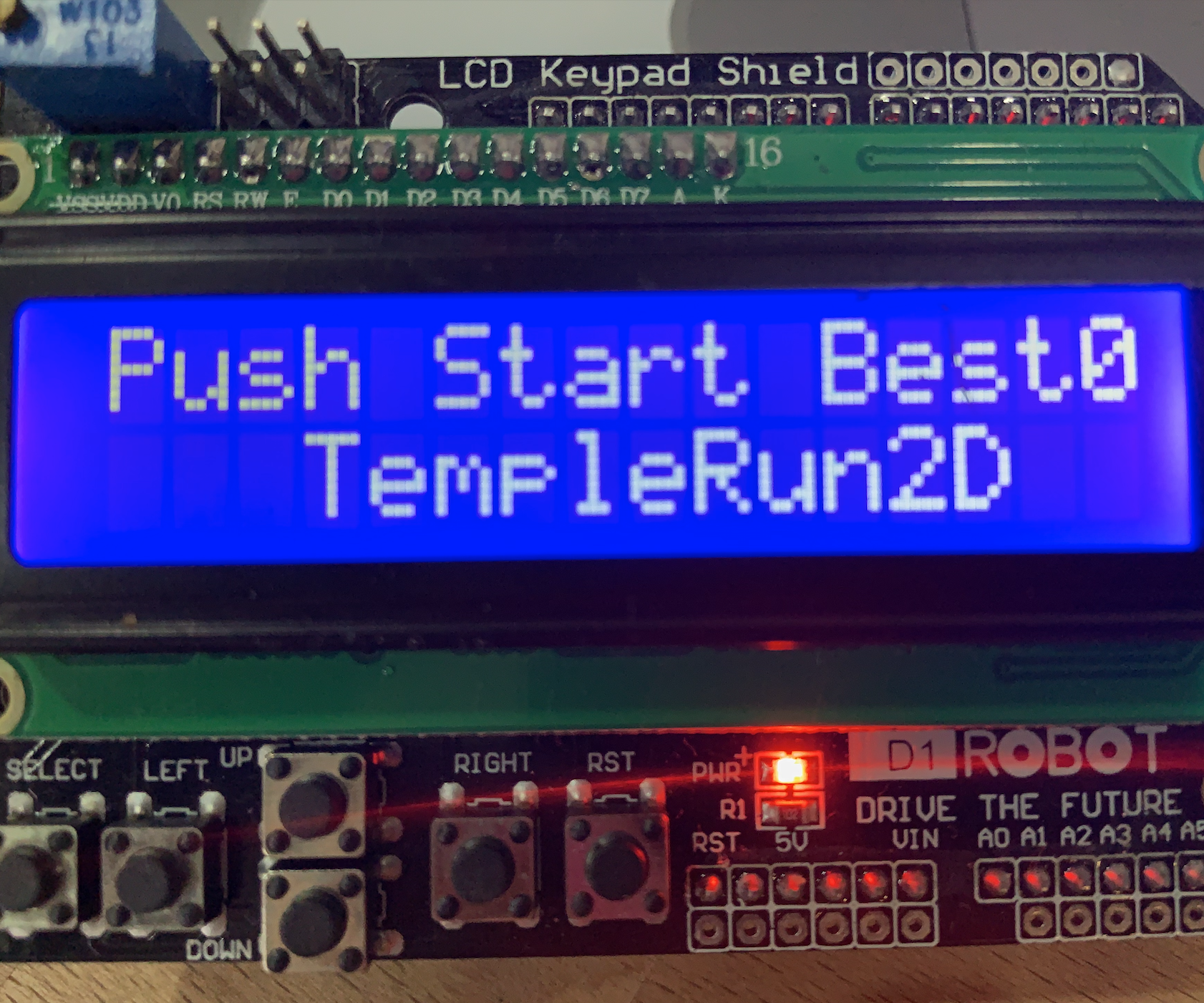

Introduction: Arduino Temple Run Uno LCD Keypad Shield
About: My name is Bennett
This is a chrome dinosaur game but changed by me.
I changed the form of the character, I turned it into a fatter character, I also changed the look of the obstacles, it was only a few brick walls, I changed it into cactuses like in the original game.
https://junho85.pe.kr/639
This is the old version that I changed
Step 1: Materials
For the materials, you will need an Uno and an LCD keypad shield.
This is the code of the game.

lcd.setCursor(3,1 );
lcd.print("TempleRun2D");//增加了第二行遊戲名稱
