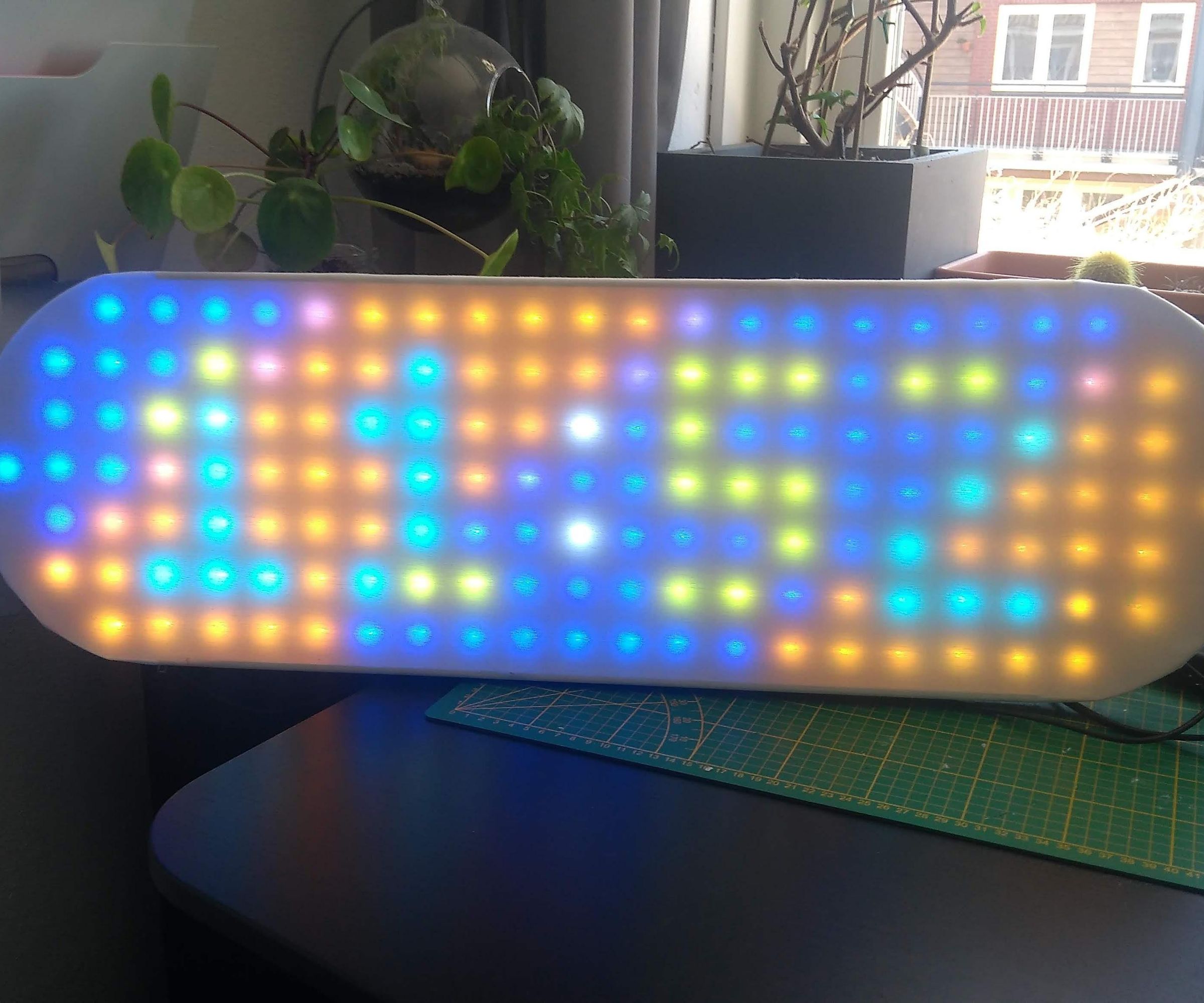

I've adapted the original design and used this to program a 24x12 pixel LED clock using an Arduino, WS2812B's and a 3D printed holder for the LED's which can be found at https://www.thingiverse.com/thing:5138944

Inspired by https://www.thingiverse.com/parallyze/designs but designed completely anew to fit the particular LED strip I had lying around. The key to this is that the LEDs aren't facing frontward but shine through a little gap off to the side. They will light up the little square pixel they are projecting into so with the right diffuser it looks quite nice as if the whole square is lighting up evenly. Pixels are about 16mm x 16mm in this design.
I had a couple of tries at various models, including circular and filled in (just printing a single layer of white PLA for the LED to shine though) but at the end I settled on a simple design where the LED strip is held in place and projects light into squares of light. It works both sides - if you want a soft effect you can use a paper sheet as a diffuser, but in the end I opted to leave everything open because the colours pop a little more. Even then I still have the paper glued to it, it helps keep everything together, but just let the back side face away from the wall.
White PLA works the best. I also tried black but this gives a dimmer display. In both cases there is some light bleed from one pixel to the next, its less when using white PLA. If you really wanted to stop light bleed then probably need to double the wall thickness which doubles the print - this took about 5 hours for a single 12x12 pixel panel.
The LED strip folds back at the top (scary at first but works fine), and then at bottom I bridge the gap to the next column with some soldered wires. You could just loop the LED strip across to the next column (Parallyze does this) which would save a lot of soldering and make it somewhat more reliable in the process, but there are a couple of LEDs which never do anything in that case and I like the open wires in this design.
LEDs are wedged in place and are pretty stable. I did end up printing a couple of clips which you can wedge into and across the rows which help keep the strip from falling out but this is strictly optional.

  • I have two variants, the standard and a 'backwards' (this one) depending on which way I want to hang the clock paper side to the wall or away from the wall.
Step 5: Enjoy!
I think the end result is quite nice! See the Youtube videos for a quick demo. Any questions or comments, please let me know!
