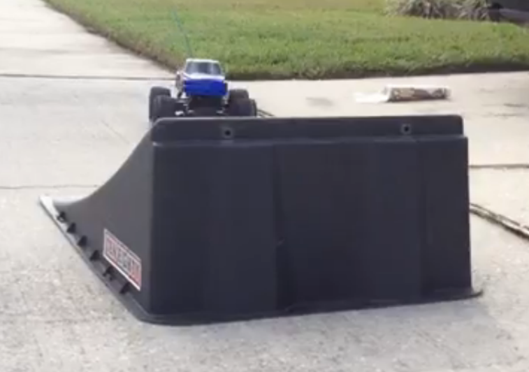

So far, here's the only video I have of the vehicle: Anti Locking Brakes, And LCD telemetry!
