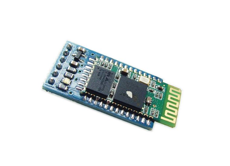

Step 3: Bluetooth
Everyone plays motion games on their mobile ever wondered what it would to be like to control stuff using motion control . In this instructable I'm going to show you how to build a android motion controlled  robot that transmit video through wifi or through VHF . This robot can also be controlled over a pc or laptop.
If you liked my project vote for me in the contest.
