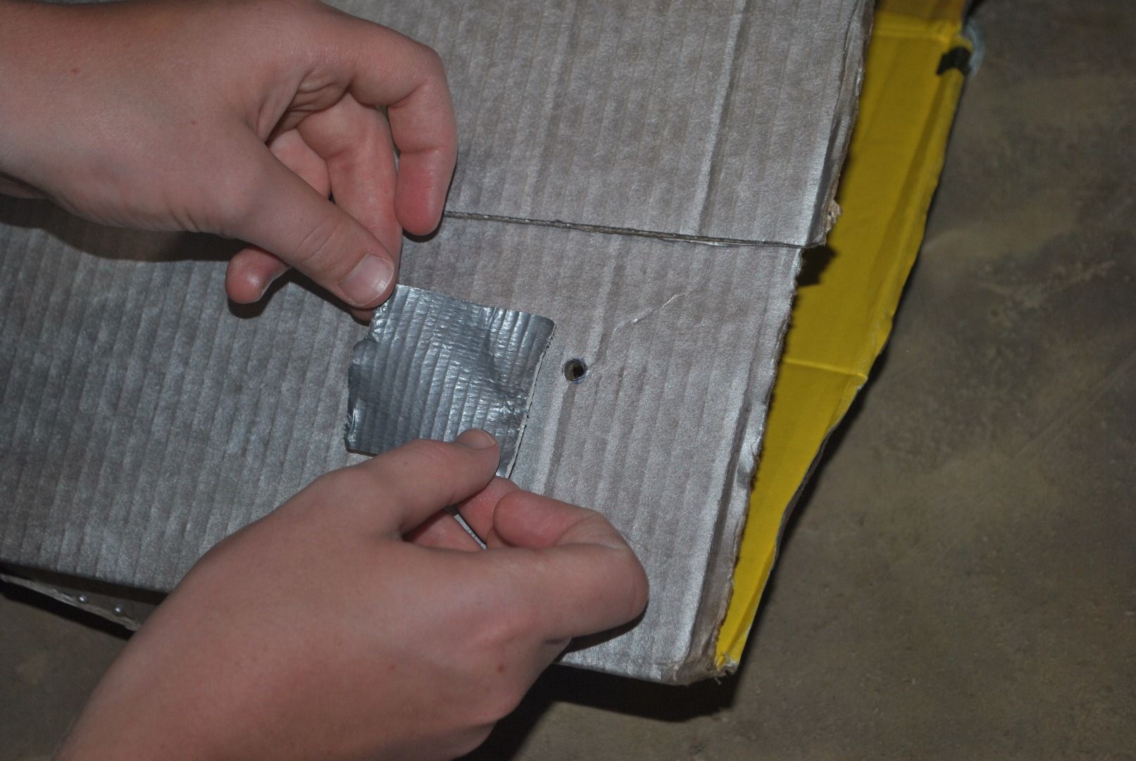

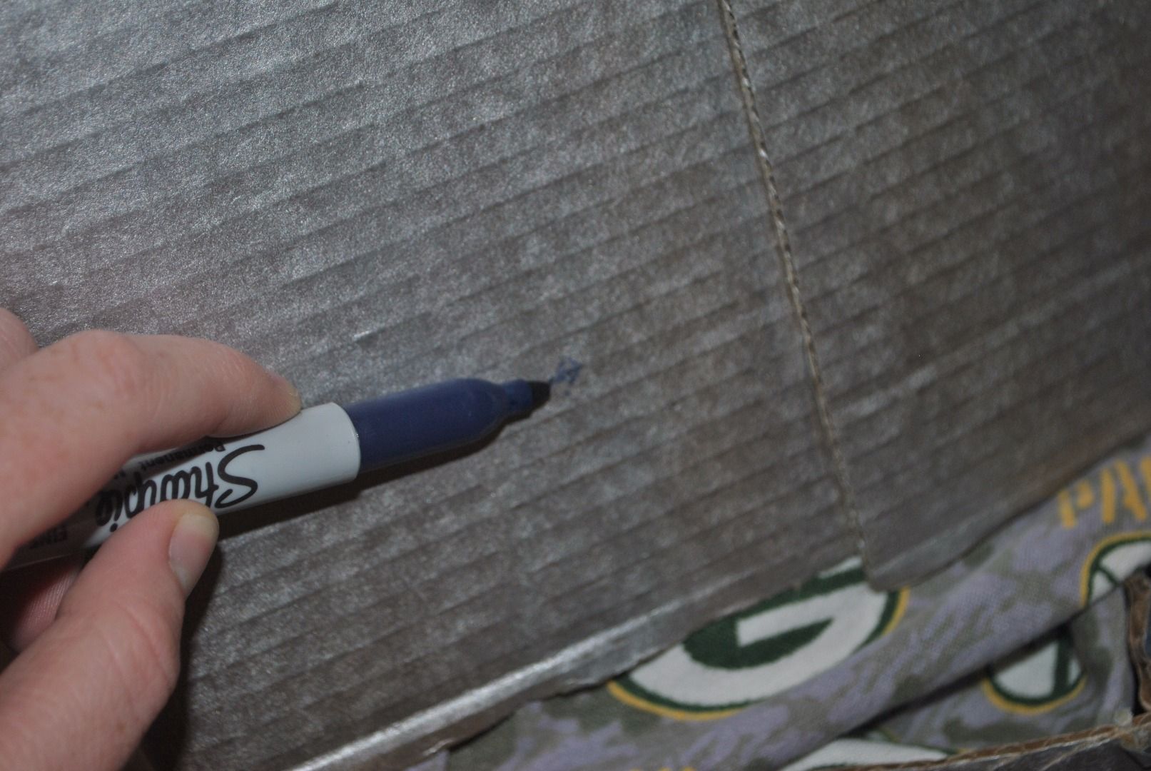

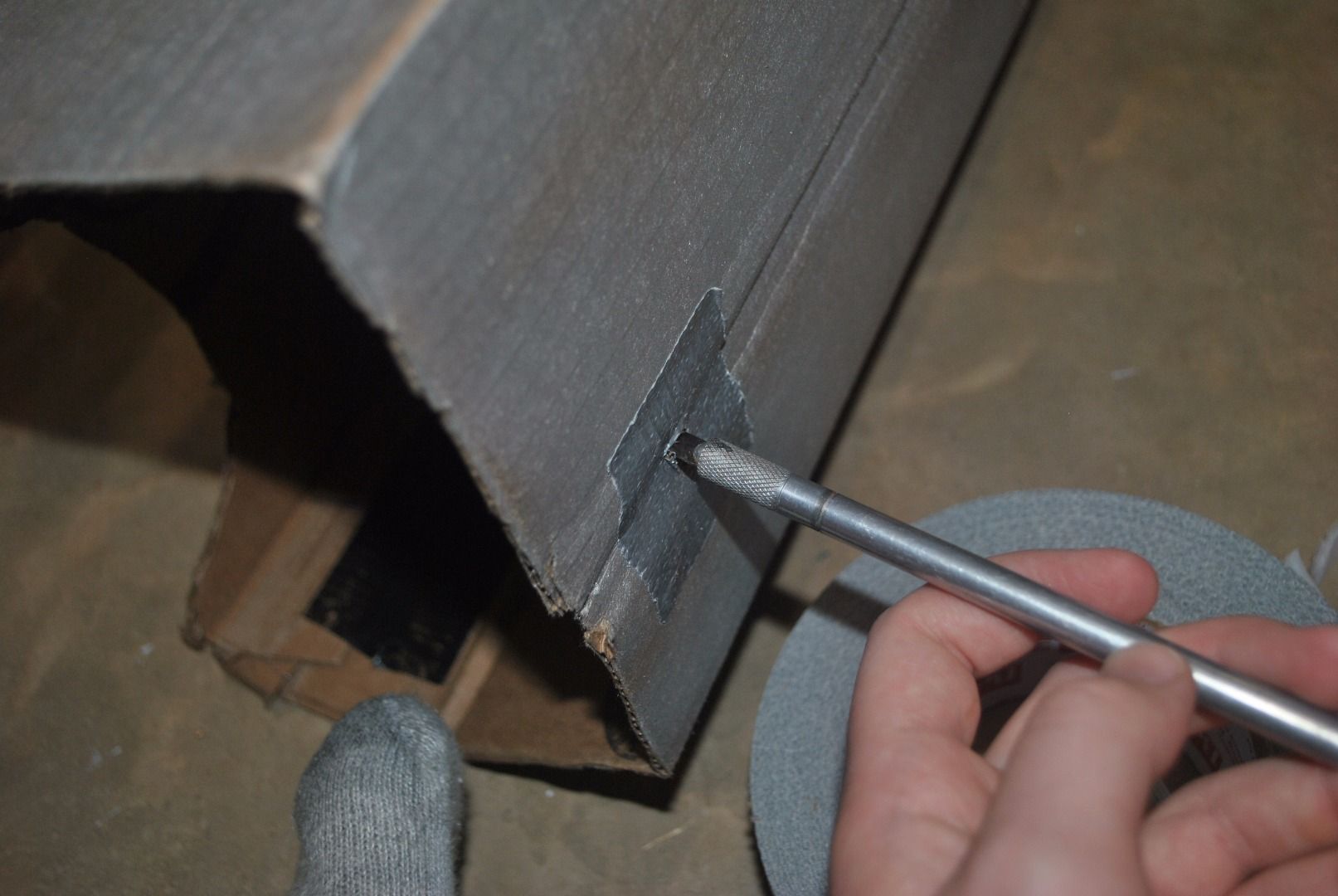

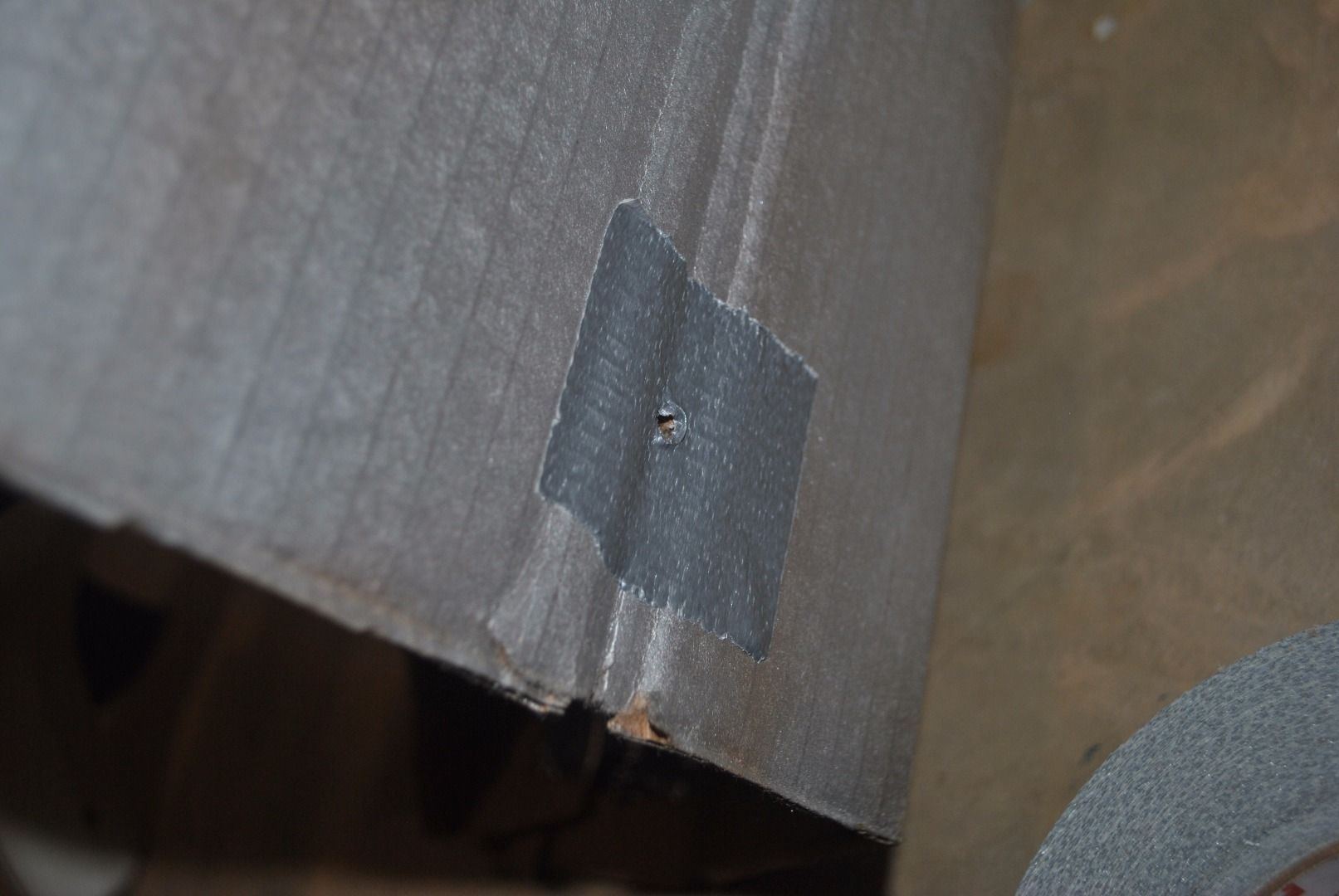

For this step we will be attaching all the limbs and parts together. We're going to start off with the stiff joints(the elbows and knees). Take two limbs that are attached such as the shoulder and forearm. Cut two 4'' strips and hot glue the ends to the inside of the limb pieces. Put some duct tape over the top too. Do the same for the other piece you're attaching. Now take the strips and overlap them by about an inch. In the middle punch a hole with your awl and stick the bolt and washer and stuff. Tighten it, but keep it loose enough that you can comfortably bend the joint. Once satisfied, put a dab of hot glue on to prevent it from loosening. Repeat for the other side. Now test it out by slipping on whatever newly attached pieces you have and bending them. I found that for the arms you want them a little bit stiff, but for the legs you'll want them to be pretty loose. Now repeat for whatever stiff joints are left. We now move onto the flexible joints which we use paracord for(attaching the shoulder to the chest, and thighs to chest). First put a hole where you where you want the paracord to come from. Put a small square of duct tape on each side of the hole to prevent ripping the cardboard. You'll need to make the hole bigger by using your Exacto knife.

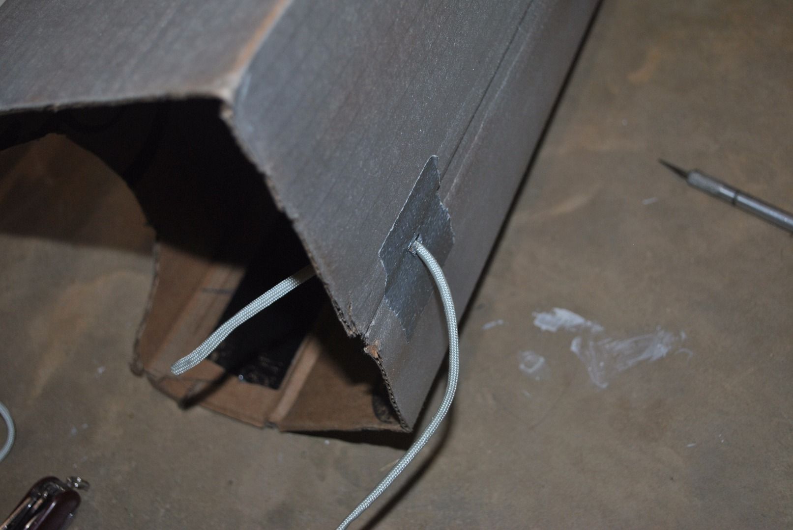

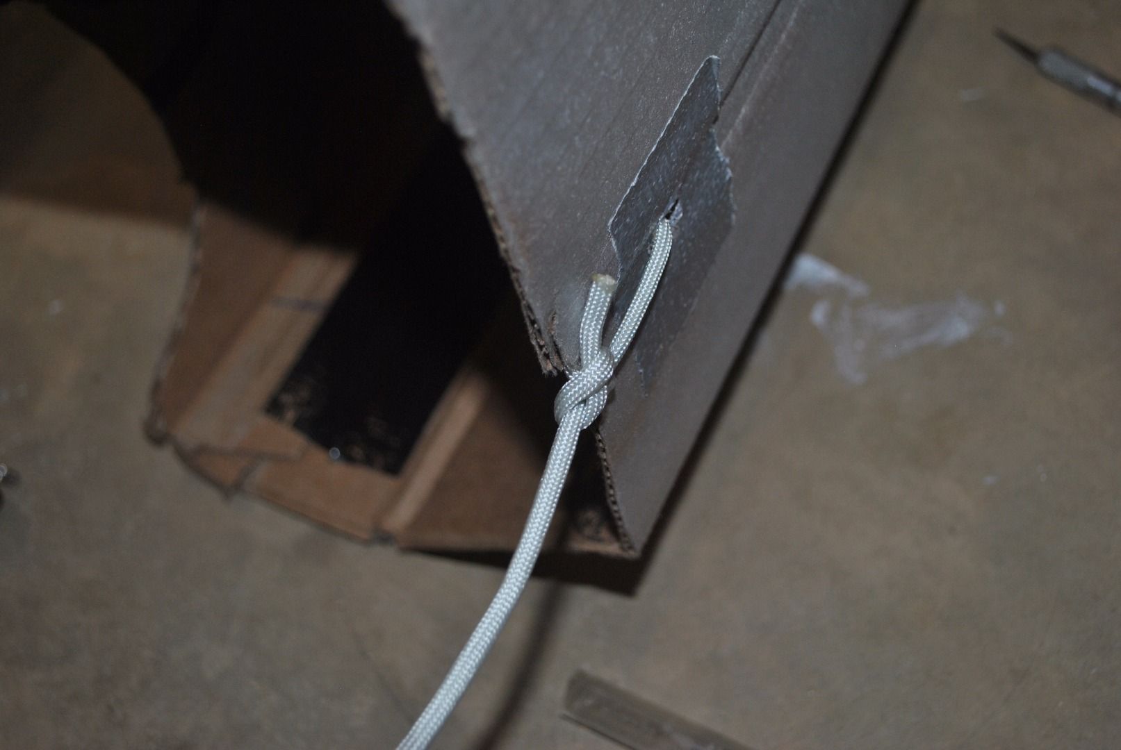

Now put the paracord through the hole.
And tie a square knot.
Remember to fuse the ends.
I did this once on each thigh and twice on each shoulder.

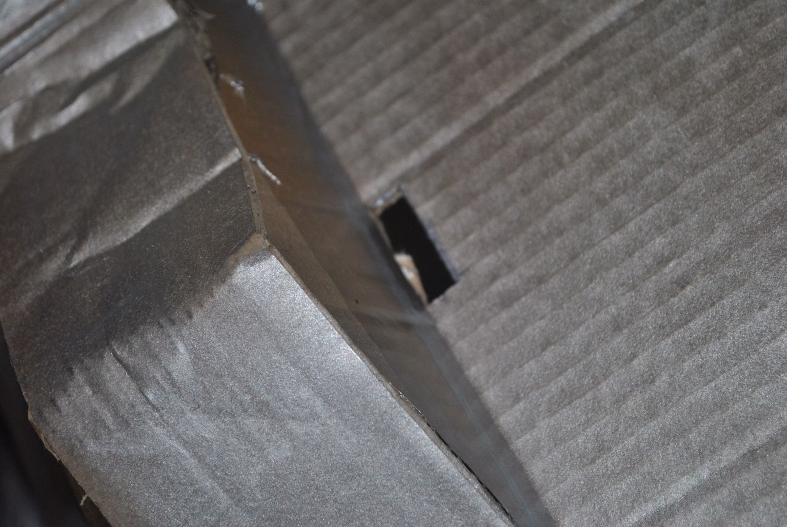

Now make the holes in the chest so you can detach the legs so you can get the costume on.

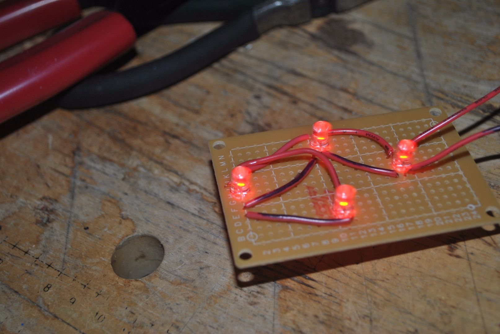

Step 9: Wiring the LEDs
Warning! If you're really hardcore and want to add LEDs then this step is for you. This step is not for the average costume maker.

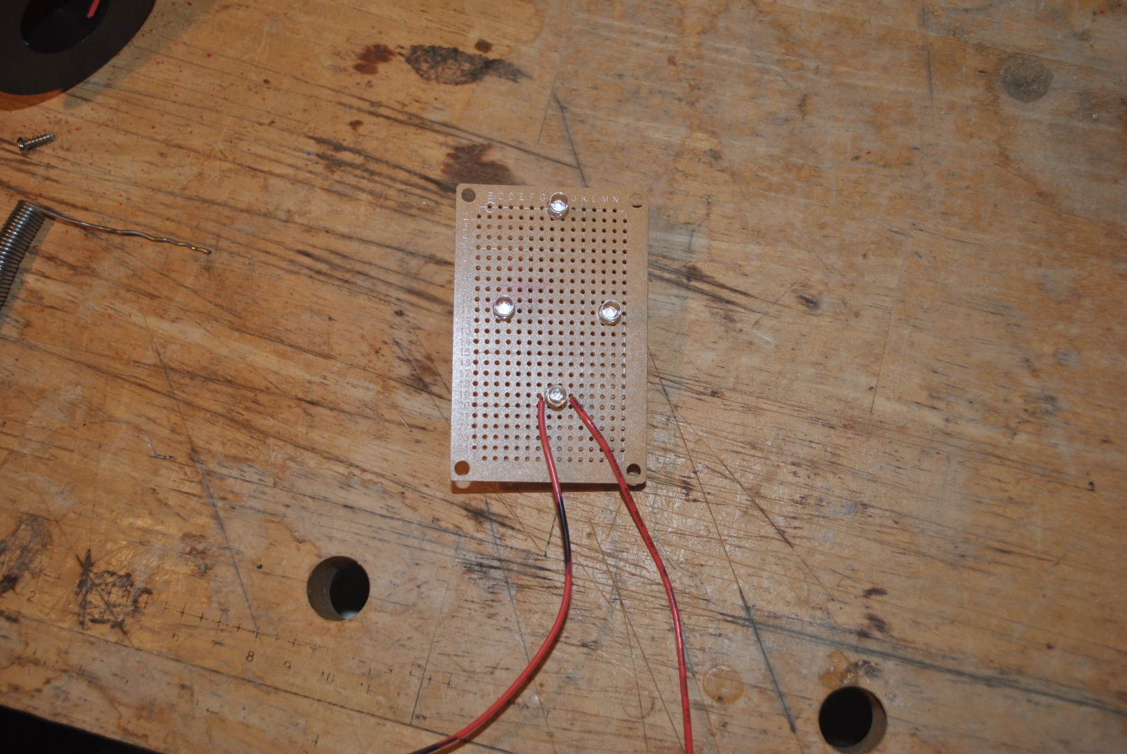

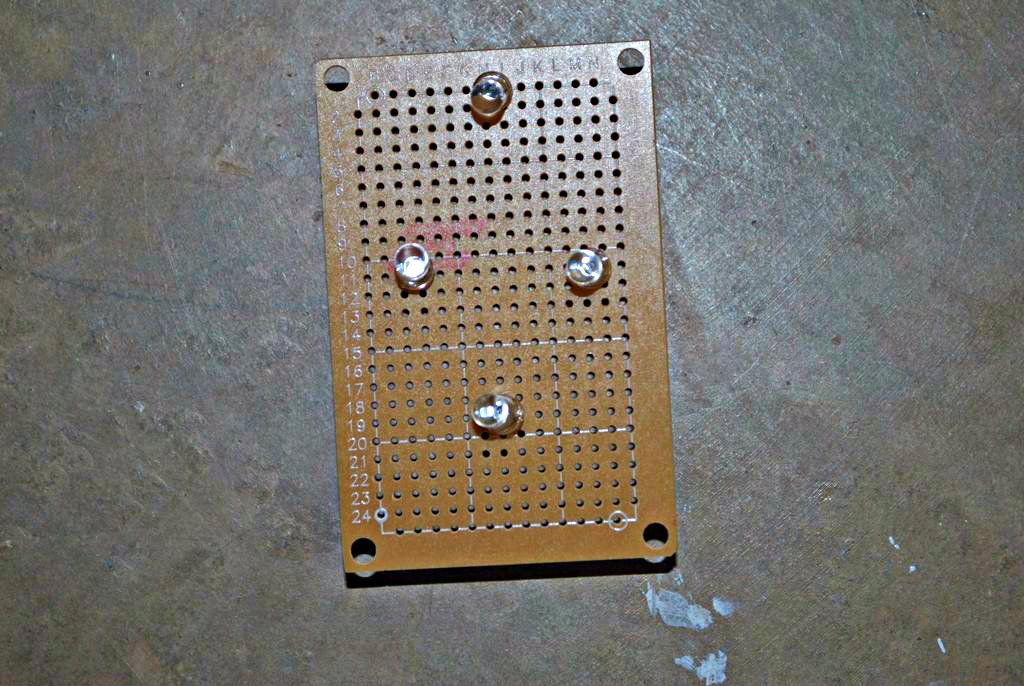

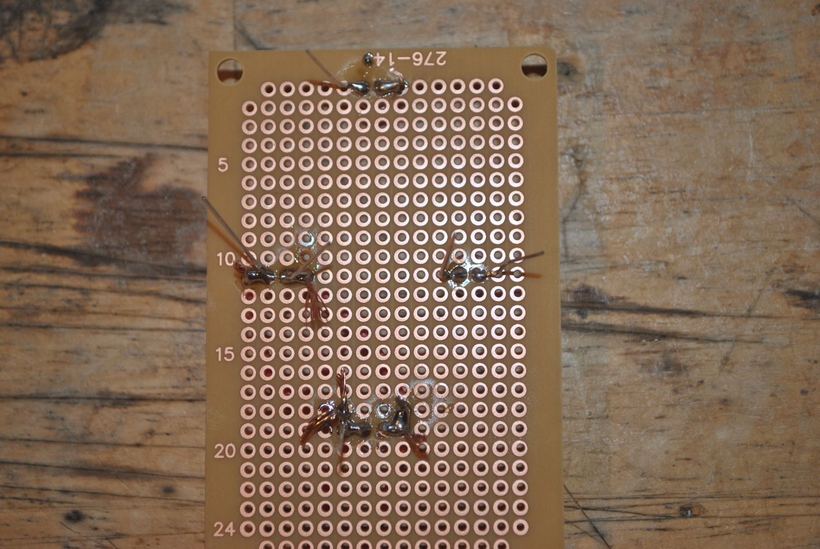

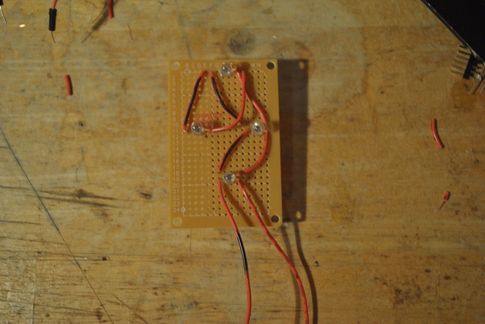

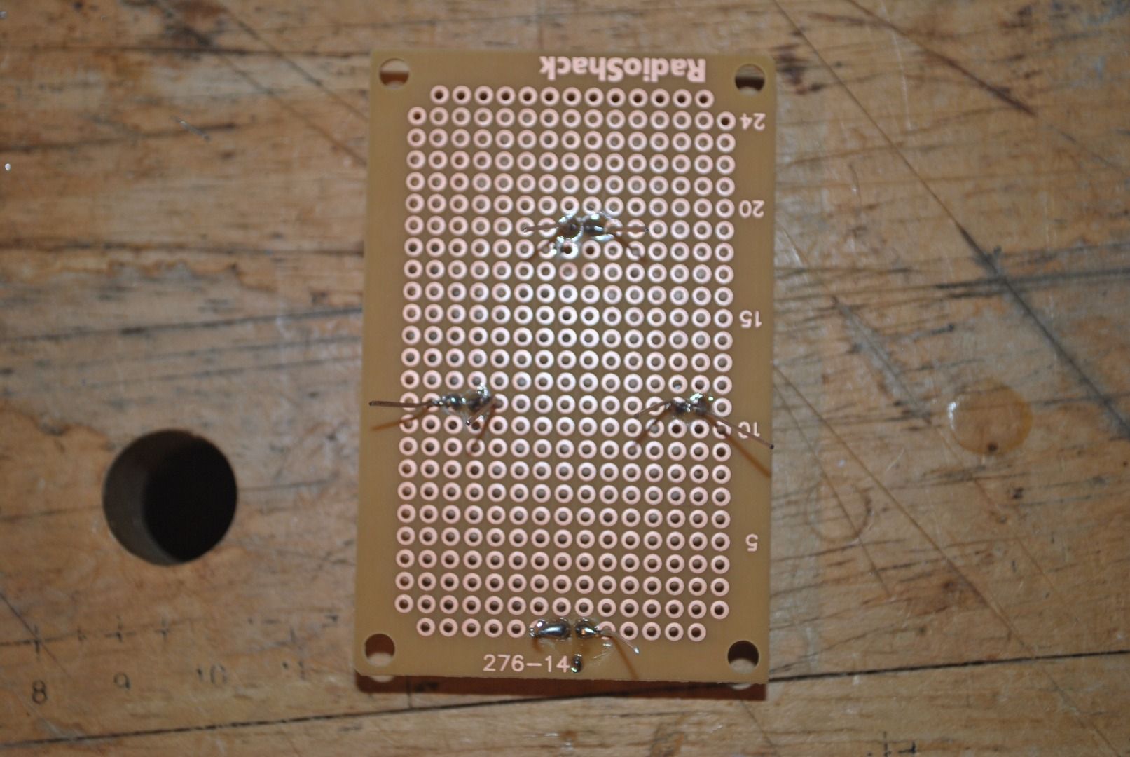

So, first thing first, solder the LEDs to the pc board. Make sure they are flat against the board when you solder them

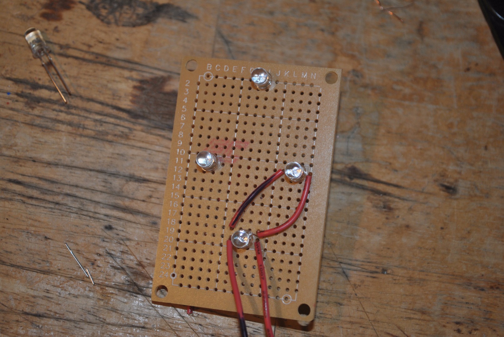

I made sure to put all the negative leads on the left. I then added the power lines. And just kept adding jumpers and solder bridging them. The wire with black marks are negative.

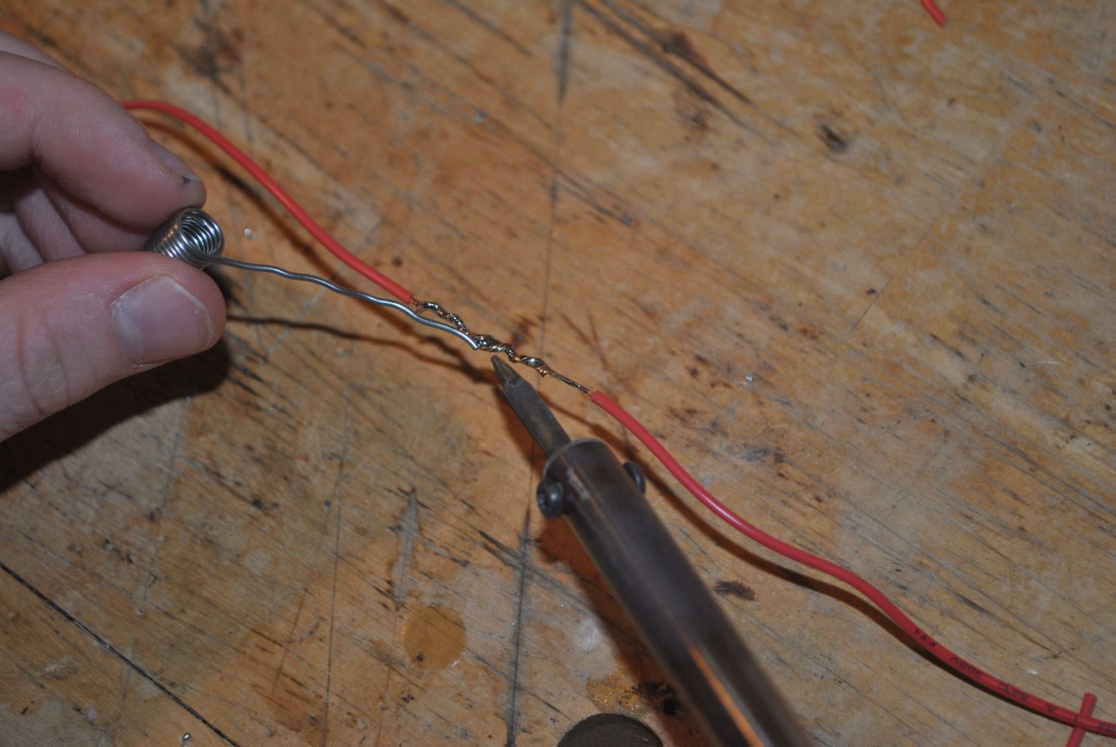

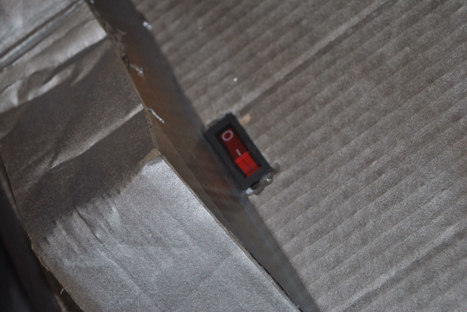

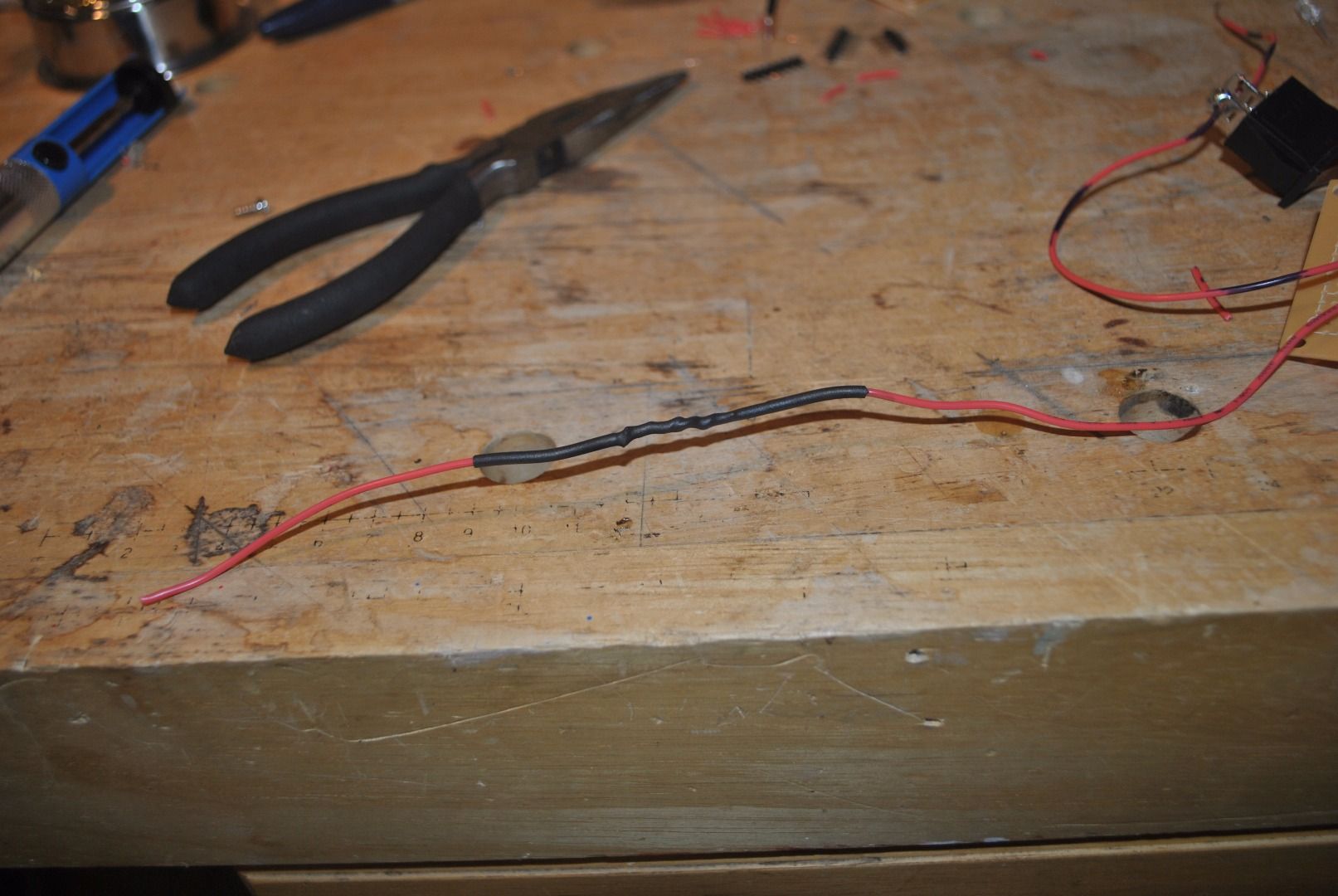

Now we add a power switch to the negative and a splice to the positive. You can find a really good Instructable that I used for splicing here.

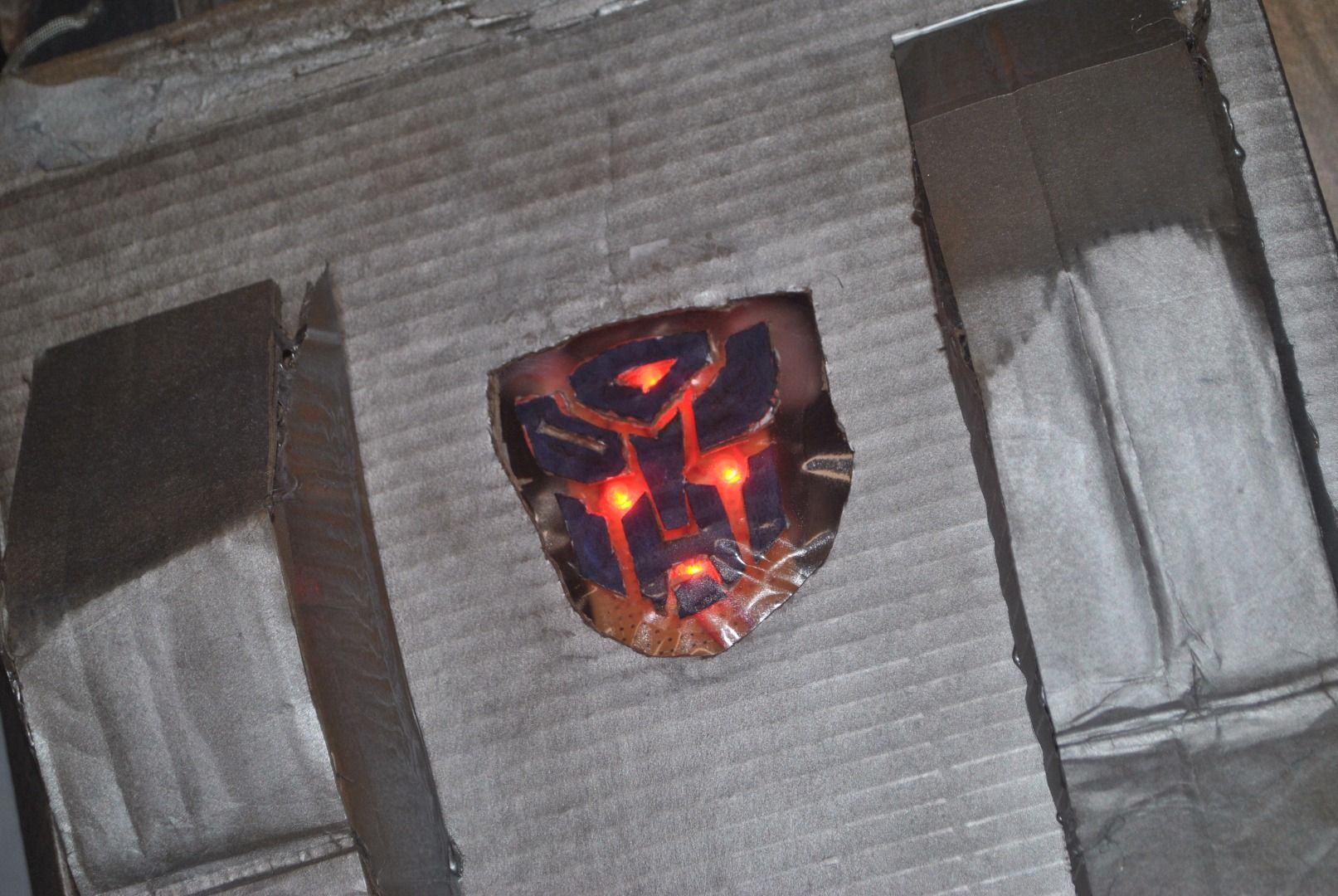

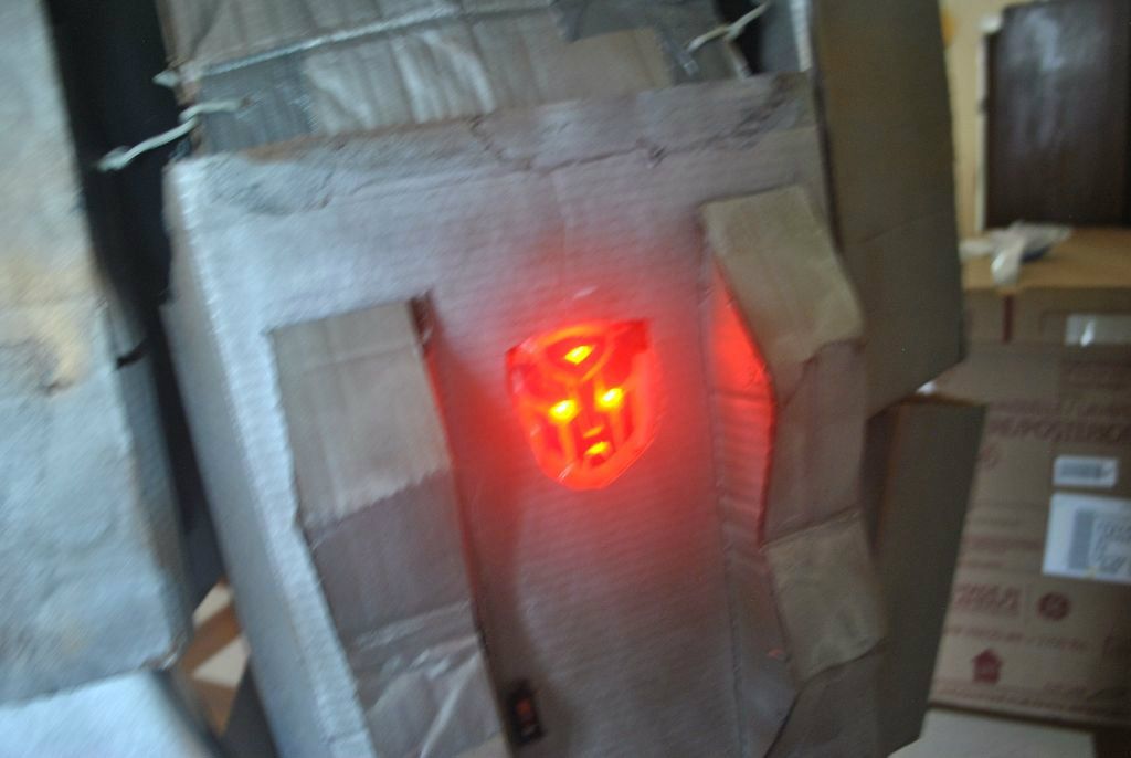

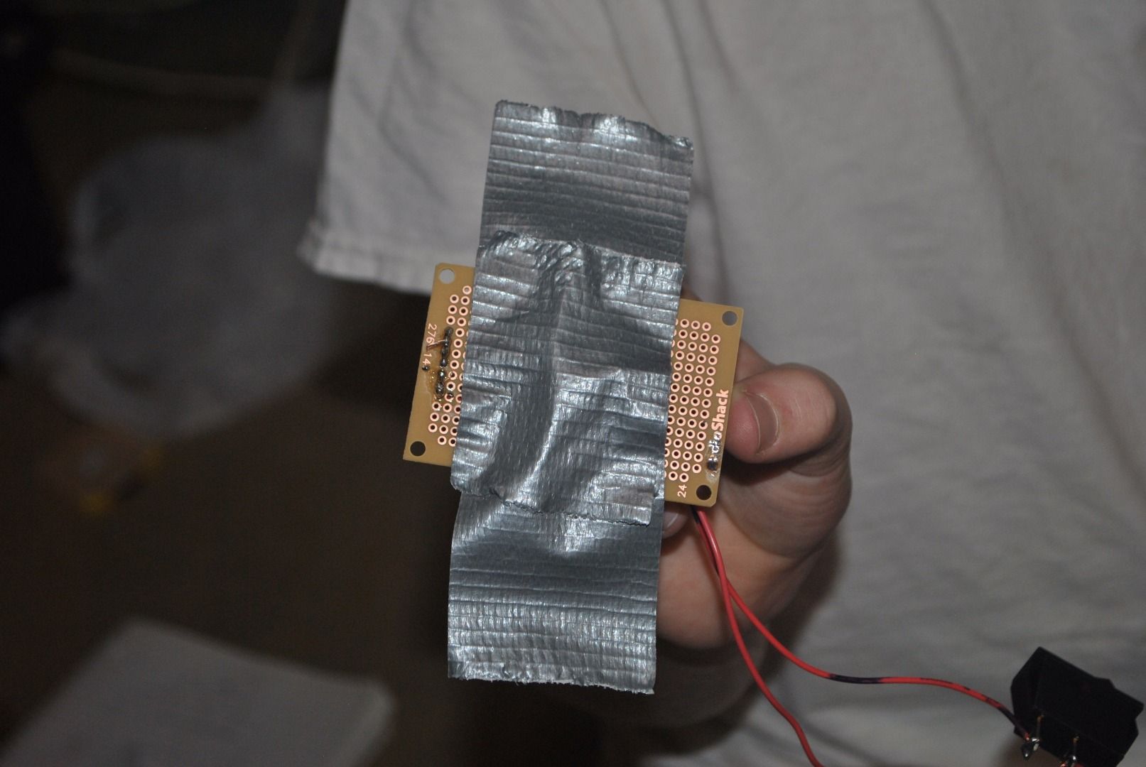

For the power supply I used 2 3v C2032s. They're really compact, so they were perfect. I couldn't find any holders at my local RadioShack, so I wrapped electrical tape around the batteries and wire. To attach the circuit to the costume, I crudely duct taped the pc board to the back of the symbol.
I did it so the LEDs lined up under the eyes, the the little triangle on top, and one LED at the bottom around the mouth.
I then made a little hole for the switch. And hot glued it in.
I then just taped the loose wires and batteries down to the inside.
Now you're done! You have an awesome Transformers costume that lights up!
