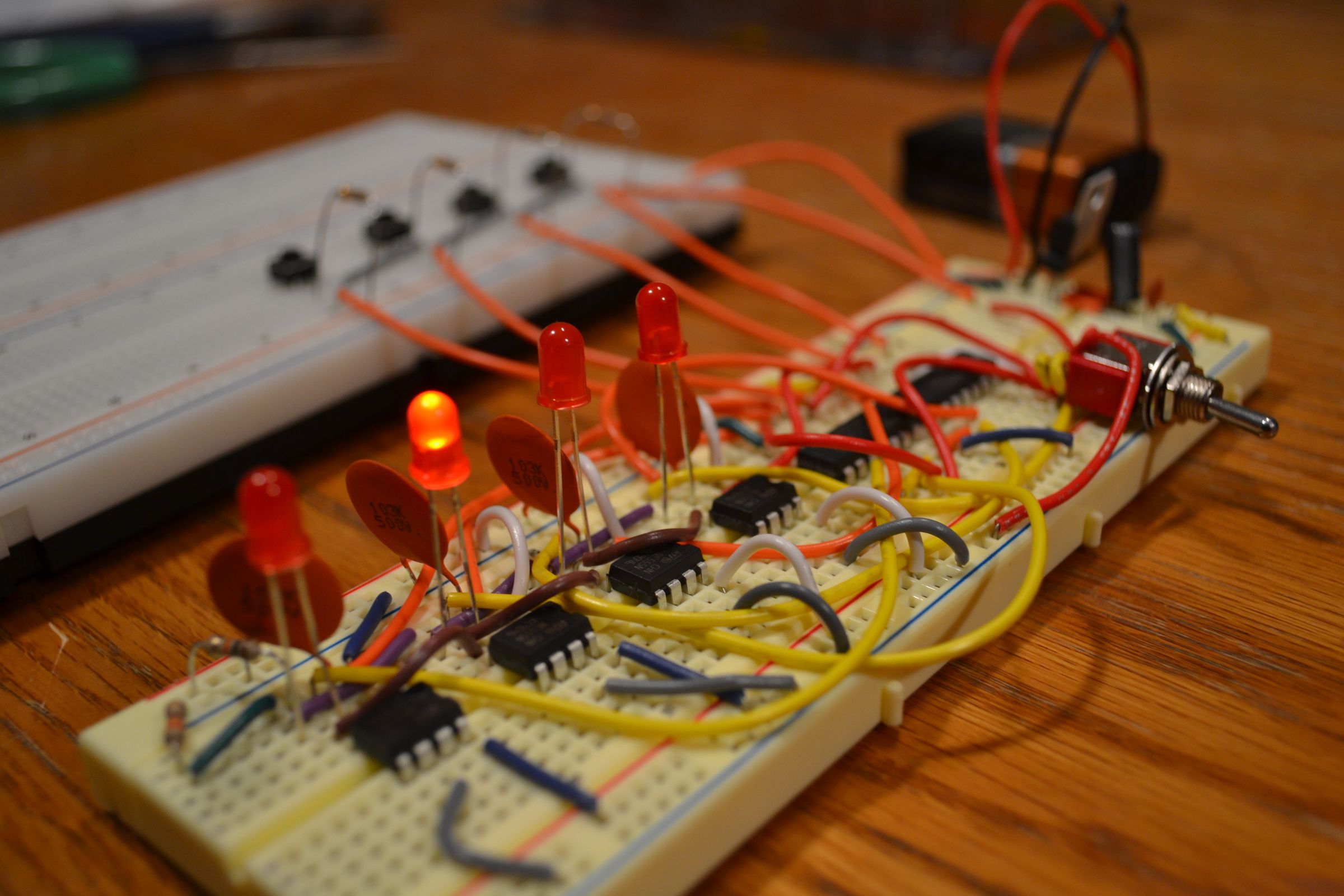

Step 4: "Hello World" PICAXE
After all that software issues and stuff, I bet you want to get started sticking things into a breadboard. Well now is the time for that!!! :D
Set it up according the diagrams above(note the ground and voltage-in pins... they are exactly opposite of the 555 timer so be careful!!!).
(I soldered jumper wires to the socket and I highly suggest you do so, too)
We'll blink an LED on for one second, turn it off for one second, and turn it back on again in a loop.
The code is relatively self-explanatory:
CODE "HELLO WORLD"
_____________________________________________________________________________________________________
| main:
| high 1
| pause 1000
| low 1
| pause 1000
| goto main
Just in case you're wondering, the 1 in front of high and low stands for "Logic Pin 1". Take a look at the pin-out (C.0, C.1, C.2, C.3... etc., think of it as "logic pin 0, logic pin 1, logic pin 2, logic pin 3...).

IMPORTANT:
Make sure you have the IRremote library by Ken Shirrif installed... get it here:
https://github.com/shirriff/Arduino-IRremote
Upload the sketches at the bottom of the page to the board and chip and set up hardware accordingly. Test it out.
If the maximum functional range between the glove and base modules to the "brain" module is not far enough, then your infrared LED's might need a little upgrade.
If the umpire works and you're happy with the range, then I guess you're done!!!
If you want, you could put the brain into a enclosure like I did.
I've lain out the groundwork, and its up to your to do the grunt work!!! ;-)
GRUNT WORK
-Figure out how to shrink the glove module circuit and fit it into a glove
GRUNT WORK TIPS
-Use two or three coin batteries instead of a bulky 9V
-Use several pushbuttons wired in parallel
Even if this isn't the most PERFECT thing in the world, you still learned some stuff about PICAXE, right? No? Fine.
But hey! Maybe if you do the grunt work, you can comment your new and improved version of this robot umpire and then nobody else has to do the grunt work!
Take a look at the schematics and outlines above.
