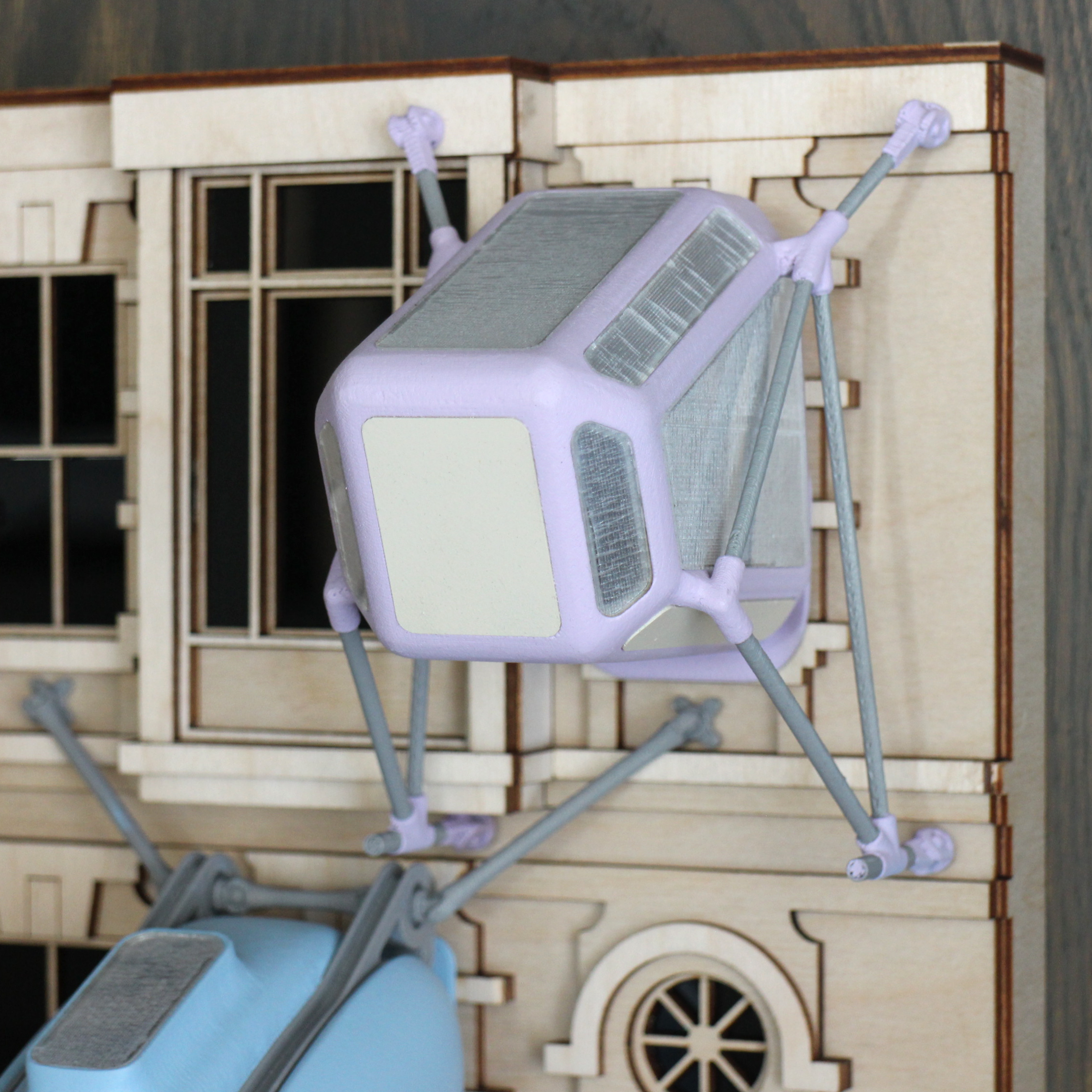

Assembly and finishing are two crucial skills to have when it comes to just about any kind of making. With 3D printed parts, there are lots of options for creating different kinds of finishes.
The image above is from a speculative architecture project of mine. It's an ABS print that's been sanded, bondo'd, and painted with matte spray paint. The wooden façade and window panels are laser cut. There are tons of options for finishing!

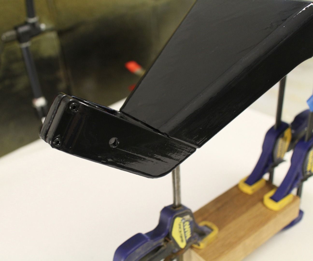

When FDM printed parts are finished, they have small ridges on the surface. This is an unavoidable result of the building process- single layers of filament welded on top of each other. With epoxy finishing, we can smooth out these ridges while creating a shiny surface and even stronger adhesion between the layers at the same time.

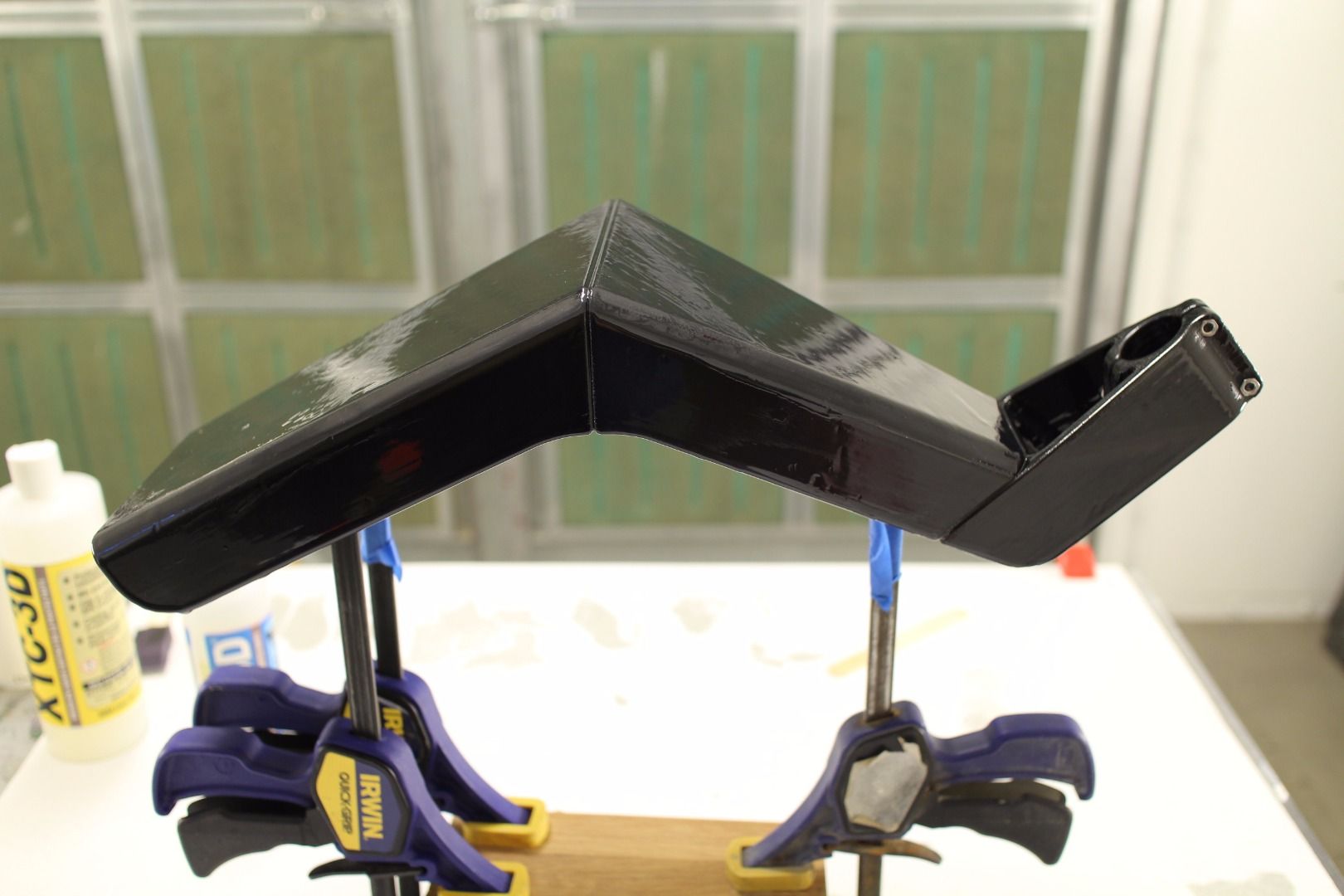

I used a product called XTC-3D which is a 2-part epoxy resin to finish the piece. It's got relatively low toxicity, is easy to mix, and has about a 20 minute working time so it's easy to control. It's fully cured in two hours, which is desirable when you're going to be doing multiple passes of sanding and finishing.
First Coat:
Like proper finishing with just about any chemical and any material, multiple coats make for the best results. The epoxy fills in the gaps and uneven textures in the surface of the part, but since the part is uneven, the coated surface is uneven. For best results, at least two coats are usually needed.

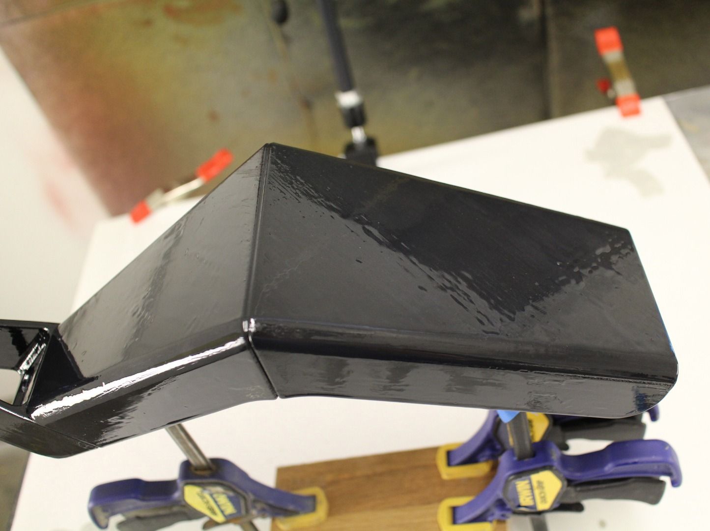

Second Coat after Sanding:
After sanding down the first cured coat, I apply a second coat. I found that wet sanding wasn't really necessary, and that a soft 220 grit sanding block did a good job evening out the finished surfaces. A hard sanding block is necessary for the big flat surfaces- if you use a soft block here, the uneven surface will remain.
Third Coat: Complete
After three rounds of wet-sanding and finishing, the final result is pretty smooth. The epoxy is very viscous once it's mixed, so it's hard to get a perfectly smooth finish with it.

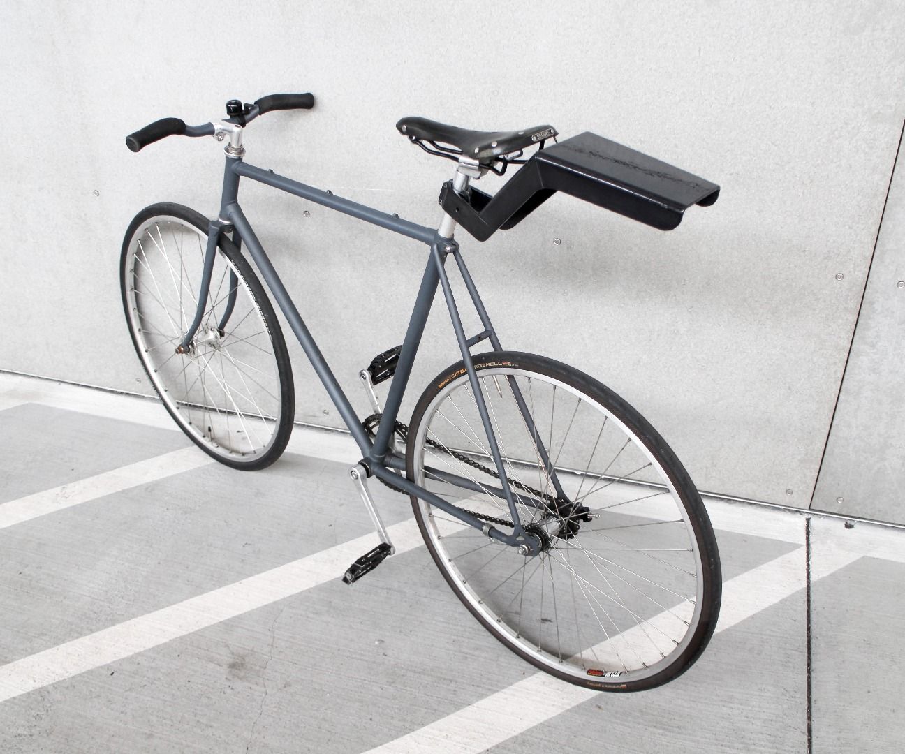

Step 4: Ready for a Ride!

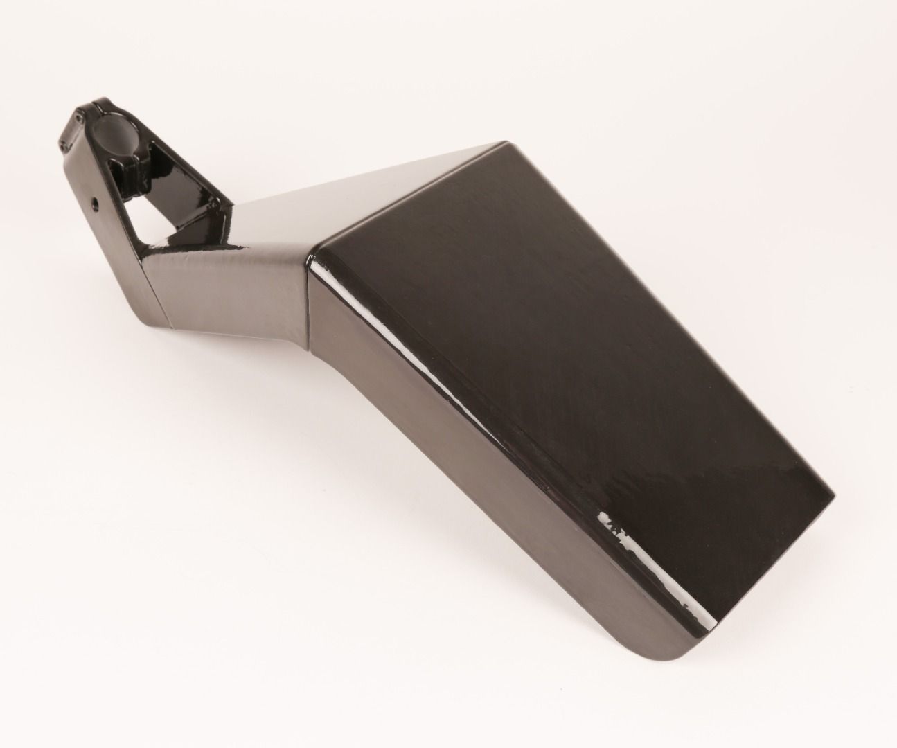

The black color of the PLA means that with a glossy finish, the part is basically a mirror. This really makes all the little bubbles and imperfections in the surface show up. I would imagine that in white or another color, this finish would appear much more uniform.
In any case, there is no trace of any ridges, and the smooth, glossy finish will make it easy to clean and wipe off any mud.

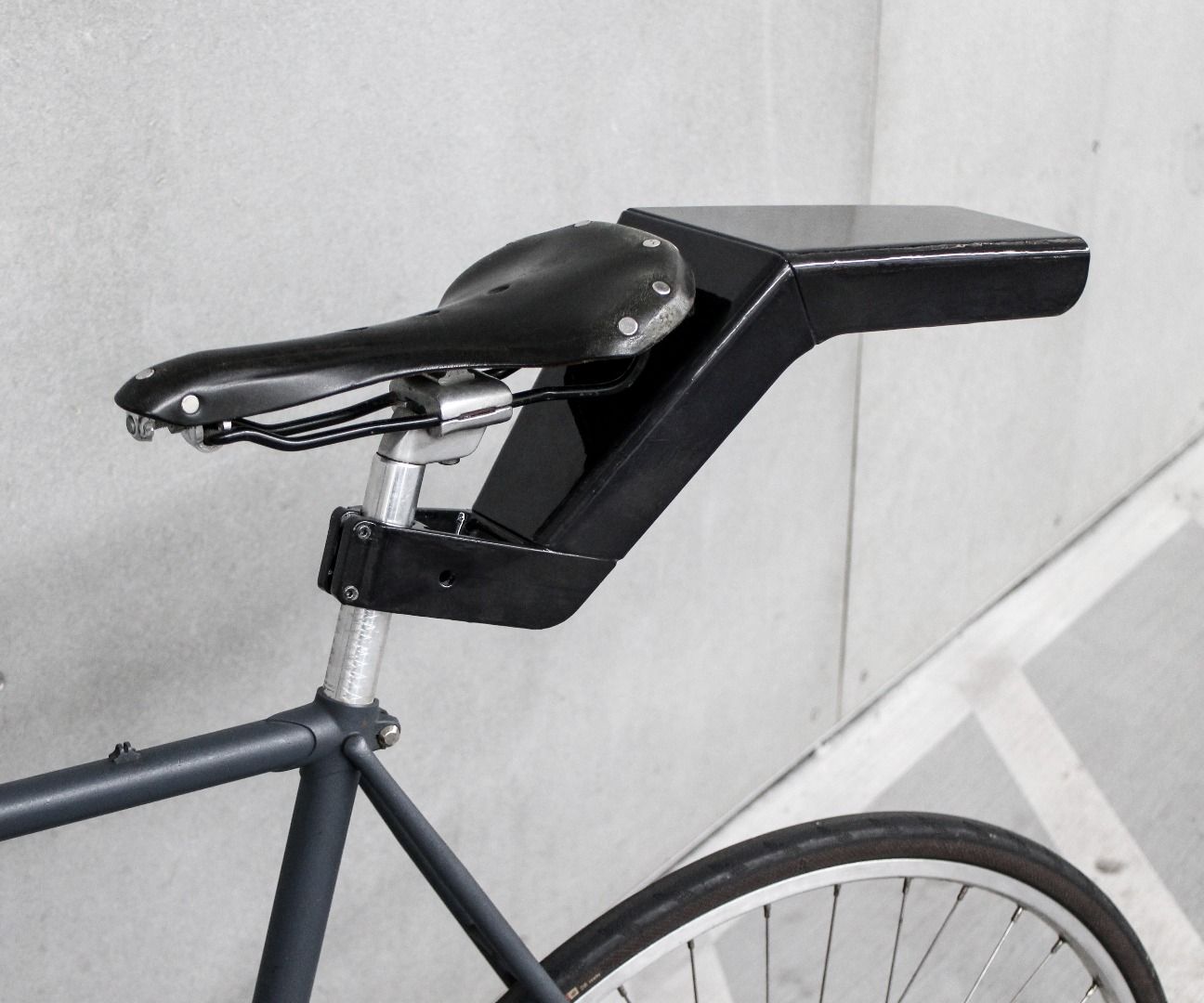

The clamp part attaches pretty easily to the seat post. All you have to do is spread the clamp a bit to snap it on, then insert the screws and tighten them in place.
I'm happy with the finish, and it keeps the mud off of my back, but the form of the part still feels a bit boxy to me. I think for round two I might try out Fusion's Sculpt Environment to make a more organic form.
