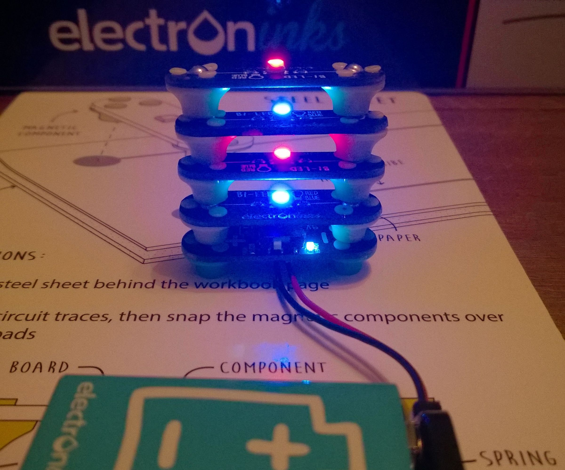

Introduction: Astable Multivibrator (LED Flasher) With Circuit Scribe
An astable multivibrator is an oscillating circuit between two resistor-capacitor circuits in which the on/off state of both RC circuits is not stable.
That is, two circuits turn on and off with the use of transistors. In this circuit, we demonstrate the state of the circuits with two LEDs that blink back-and-forth!
In this Instructable, I first demonstrate how to build the complete circuit on a breadboard using two NPN transistors and two LEDs. Once that circuit is built, I demonstrate how we can break the circuit out onto a circuit we will draw with your CircuitScribe pen!

Step 12: Connect Power, Watch the LEDs, and Onto Drawing!
Now we can safely connect our power source, and observe the rapid blinking of both LEDs.
And now for the fun part … we get to draw the transistor and LED parts of our circuit.

Step 20: Power It Up, and Enjoy the Light Show!
YOU'RE DONE!
Connect your battery, turn on the switch, and watch your LEDs blink!
Congrats!
