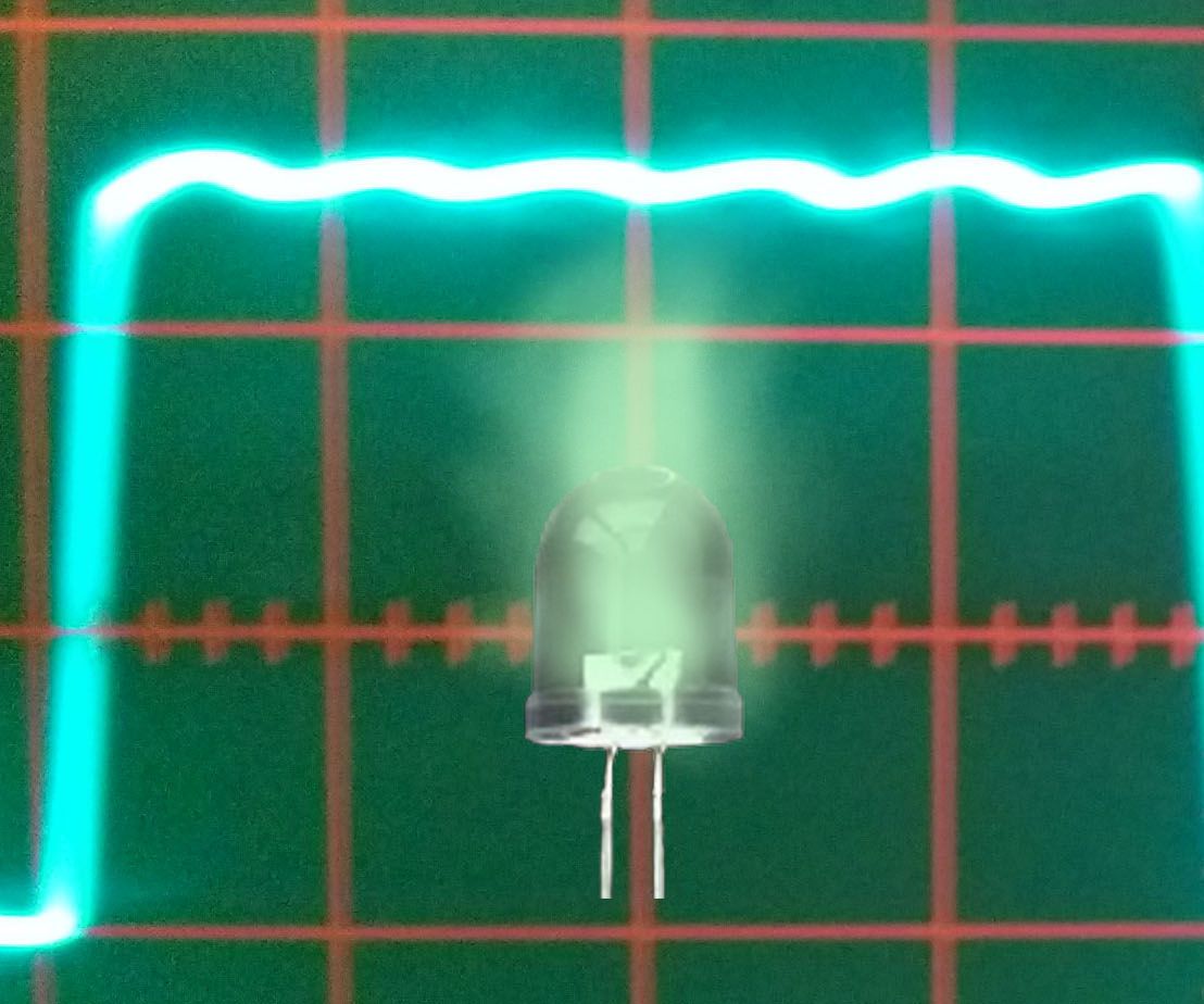

4. At this point, the LED should have a dim glow somewhere between fully ‘on’ and fully ‘off’. That is, the emitted optical power should be between max and min (Pmax and Pmin as described in Startup 3, Step 8). If you modify the program by removing some of the PORTB = 0x01 statements, then you should be able to see different brightness for the LED.

Figure 9: Photos of an oscilloscope display. Left: An unsymmetrical waveform from Pin 12 when using only one PORTB = 0x01 statement in the Lifeline program. Right: A symmetrical waveform using the three PORTB = 0x01 statements. The horizontal scales differ between the left and right side by a factor of five; however, Pin 12 spends the same length of time in the zero state for both the left and right side.

PORTB = 0x01: Sets the B0 output bit to 1 which the MCU circuitry converts to Vcc on pin #12 (for the DIP package of the ATTiny2313A). The LED illuminates. Keep in mind that this command also sets B1-B7 to zero which can affect pull-up resistors or physical pins depending on the bits in DDRB – in this case, it disables the pull-up resistors since zero is written to an input.
PORTB = 0x00: Sets all of the bits in B to zero. The LED extinguishes. Keep in mind that this command also sets B1-B7 to zero which can affect pull-up resistors or physical pins depending on the bits in DDRB.
