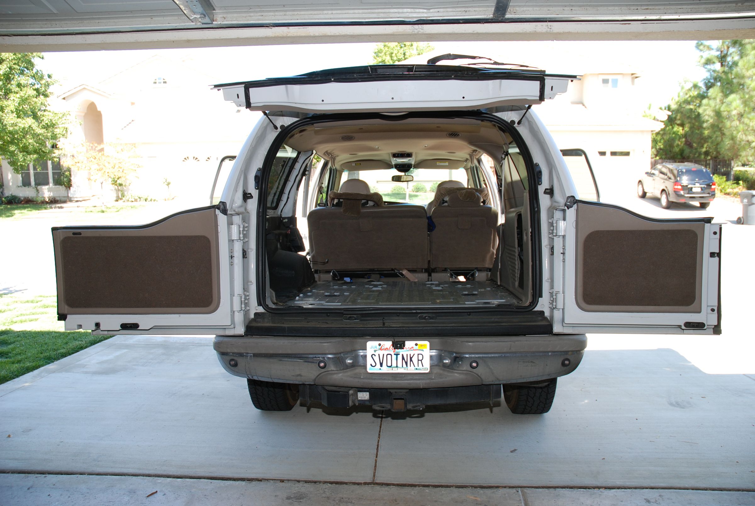

Applying RAAMmat to the rear Dutch doors and left side panel area took multi-hour sessions. (I only went after one side panel in the cargo area because the other is taken up by a ginormous rear air conditioning system I had NO intention of messing with.)
Working the adhesive mat firmly on to all the contours of interior paneling was critical to quieting things down though.
Step 3: Progress on the First Layer of Aluminum/butyl Mat...
I planned only one layer of aluminum/butyl and one of ensolite foam for everything but the floor panels.
Step 4: Applying the Ensolite Foam Layer(s) Was *much* Faster!
Using quick rough measurements and the spray adhesive, applying an ensolite foam layer over the aluminum/butyl mat went relatively quickly.
