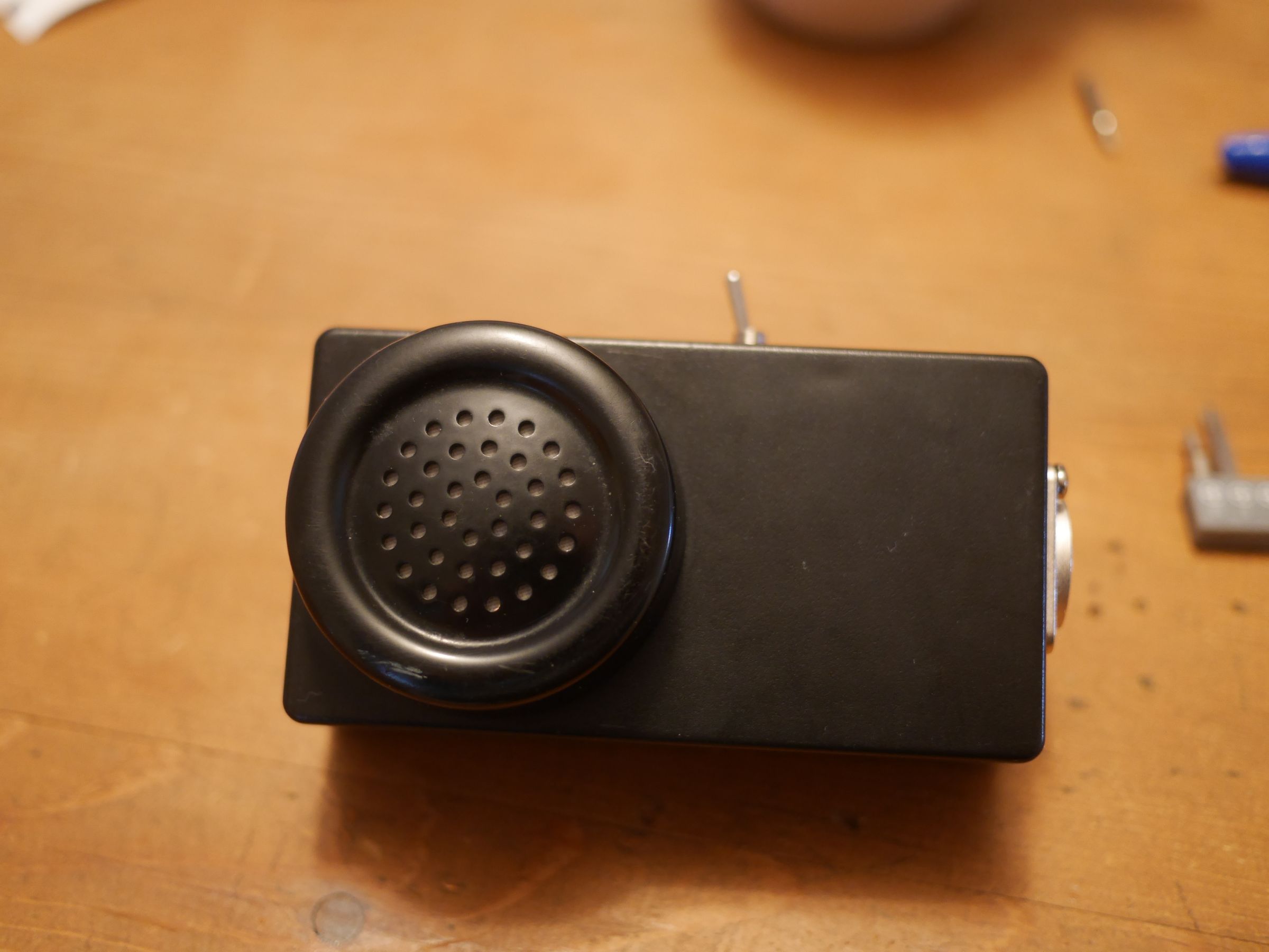

Step 1: First Version of the Speaker Microphone
Initially I kind of threw this mic together mostly just to hear it. I created it simply by wiring the speaker part of the headset straight to a mono 1/4" jack.
I used some acrylic I had kicking around to mount the 1/4" jack. I realized ahead of time that the 1/4" jack wouldn't fit inside the phone headset, so I cut the acrylic bigger then needed on purpose. When I widened the headset end with a heat gun the acrylic was the right size.
This sounded better than I expected! So, on the next steps I'll show you how I re-did the mic to look a little better. Ok, maybe this version was bad ass, but I wanted a balanced signal and didn't feel like somehow getting a small transformer inside the headset.
Step 2: Making It a Balanced Microphone
First thing - to make it a balanced signal I wired the 1/4" jack directly to a 600:600 ohm audio signal transformer.  I followed exactly trusty RaneNote 110, scroll down to the section "The Next Best Thing"
http://www.rane.com/n110fig2.gif
The audio transformer came from eBay.
Step 3: Making It Look a Little Nicer
Step 4: Adding a Stand Attachment and Final Shots
I added a way to attach the mic to a mic stand. I used a cheap mic clip and a 90 degree metal bracket. Just bolted it on.
