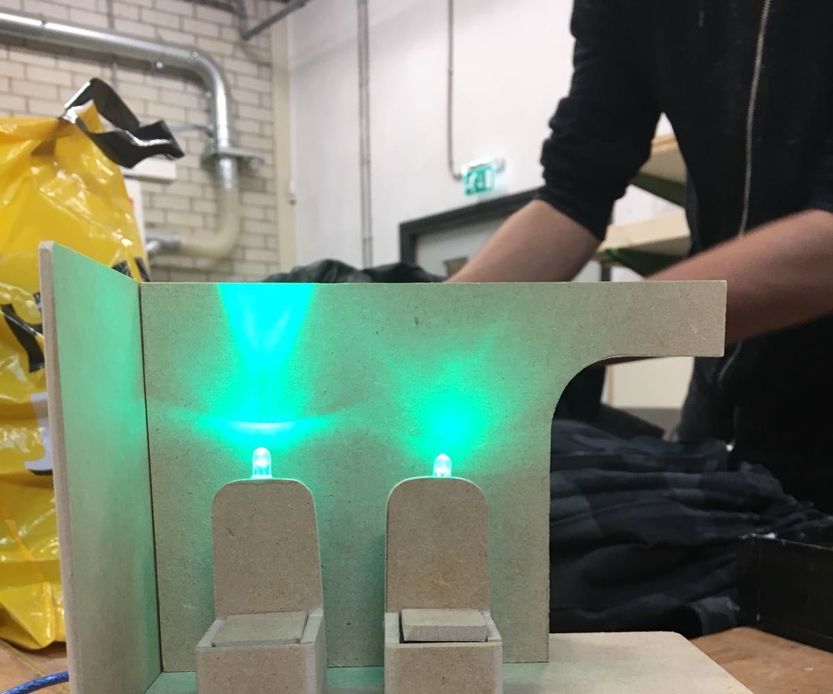

      Meeting the RGB leds:
      The RGB leds have 4 pins.
      Red, green, blue and ground pin.
      In order to save some space on the arduino, we can connect the 2 RGB leds together. So we only will use 3 pins.
      We can connect and solder the RGB leds on a protoboard like in the image.
