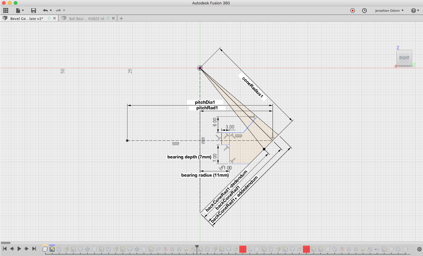

First, create a sketch in the Right plane. This will be the profile of the gear or cross-section. Using the parameters listed above, draw the lines you see there with the parameters on the annotated screenshot above.
Click on the pictures at the top of this step to zoom in if you're having a hard time reading the inline picture above.
You'll use the SKETCH > Sketch Dimension tool to enter the parameters. When you double click on a dimension, you can start typing the name of the parameter and it will come up in a list.

This particular gear is designed to press-fit a 608ZZ ball bearing, which is what the dimensions of the ledge on the middle of the profile are for.

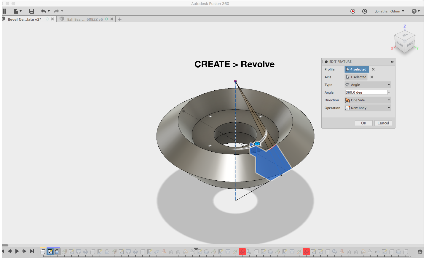

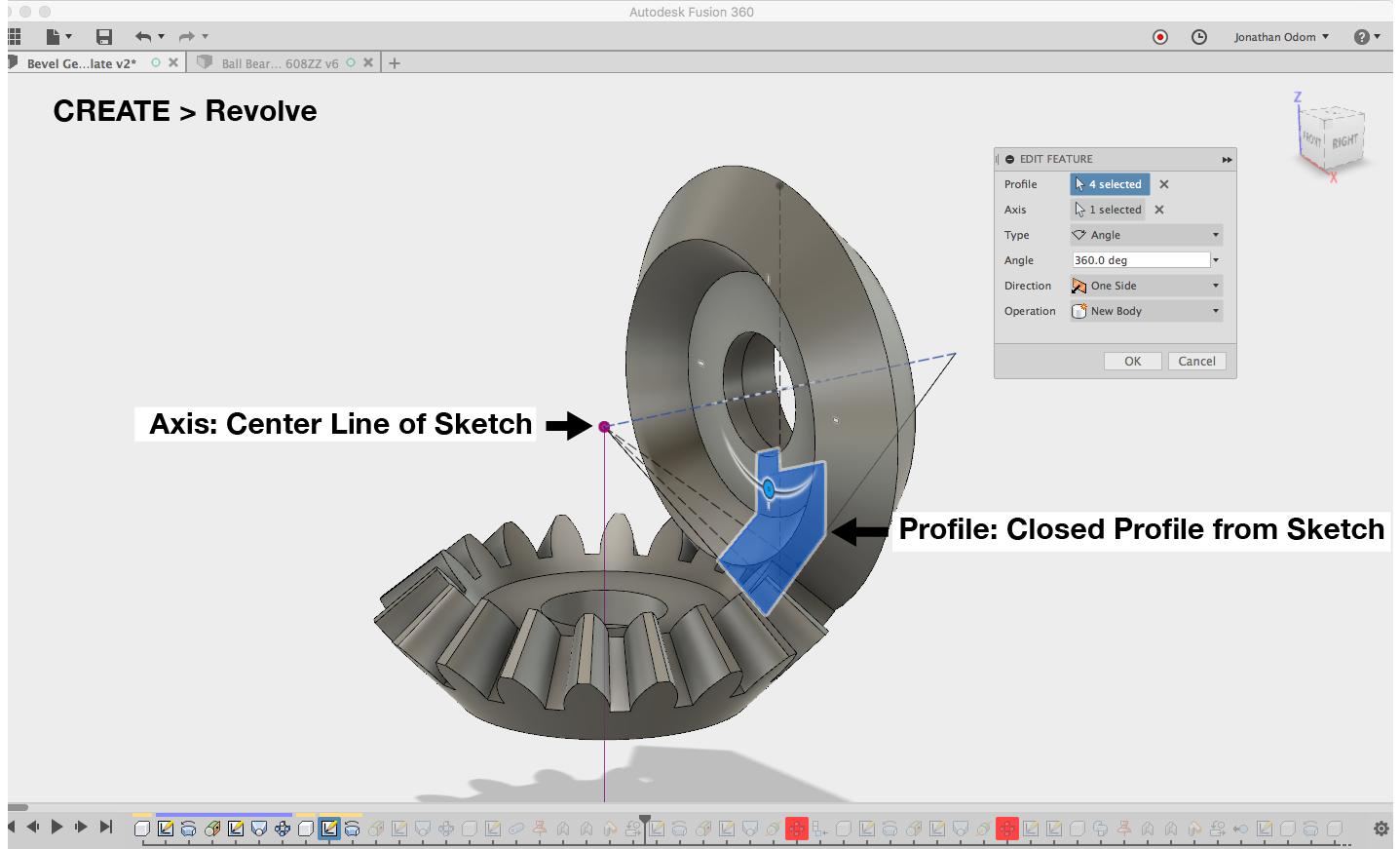

When the profile is finished, go to CREATE > Revolve to revolve the closed profiles that make up the cross-section. The Profile is the closed shape as shown above, and the axis is the first vertical line drawn in the sketch.

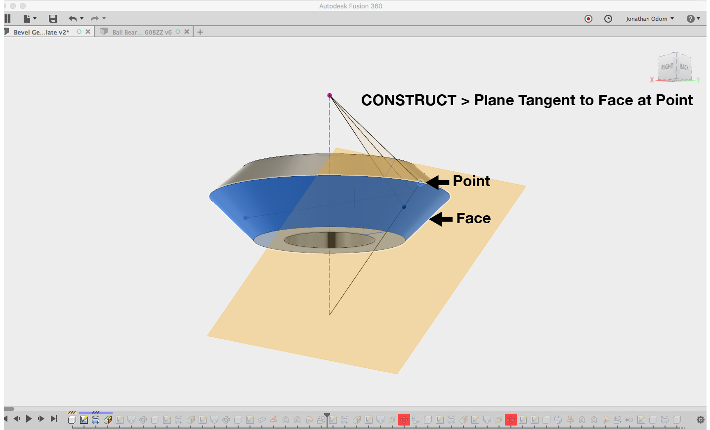

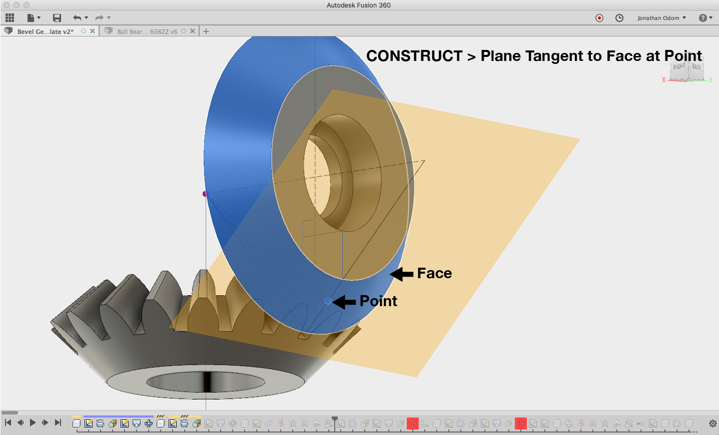

Next, you'll need to draw the tooth profile. To do this, show the first sketch in the Browser, then CONSTRUCT > Plane Tangent to Face. The Face is the underside of the gear shape, and the point is any point on the sketch that intersects with the Face.
SKETCH > Create Sketch and select the plane you just made as the Sketch Plane. SKETCH > Project / Include > Project the lowest point on the vertical line from the previous sketch. This will serve as the center point of some concentric circles.

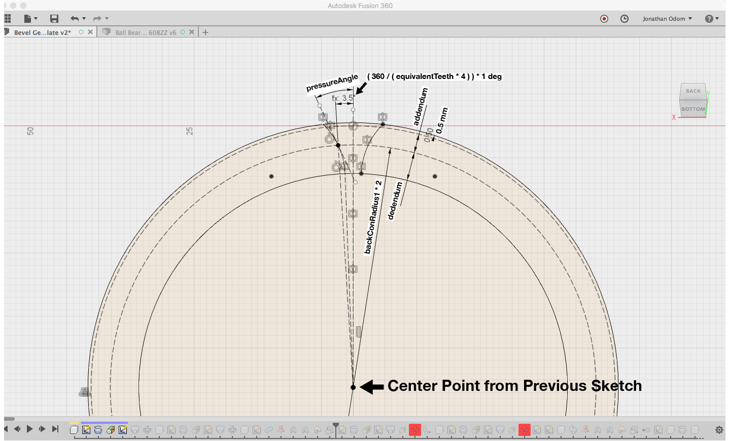

This sketch will be the profile of the tooth. Using the parameters listed above, draw the lines you see there with the parameters on the annotated screenshot/.

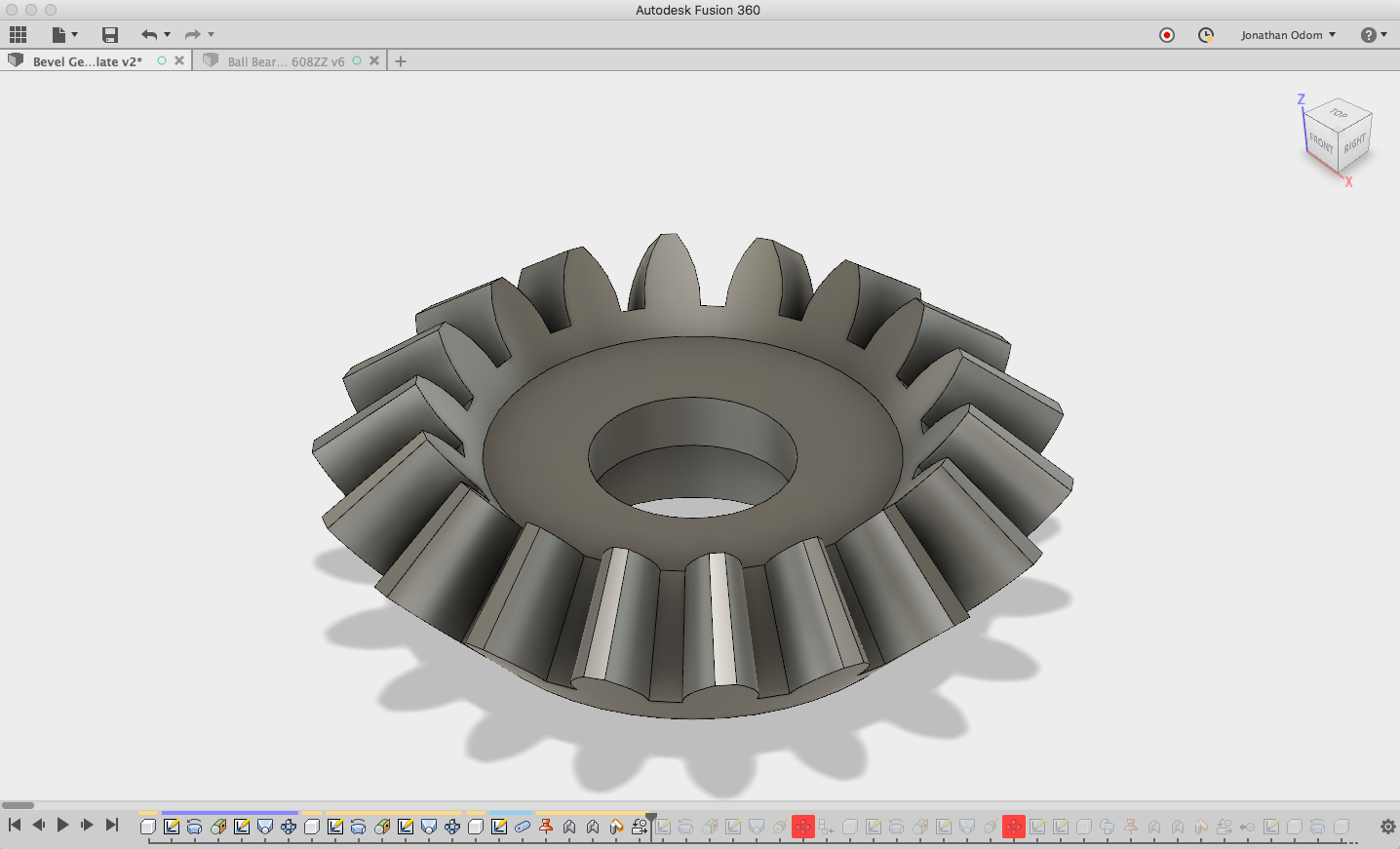

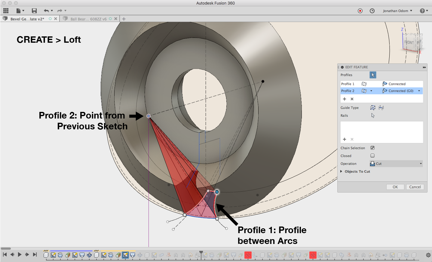

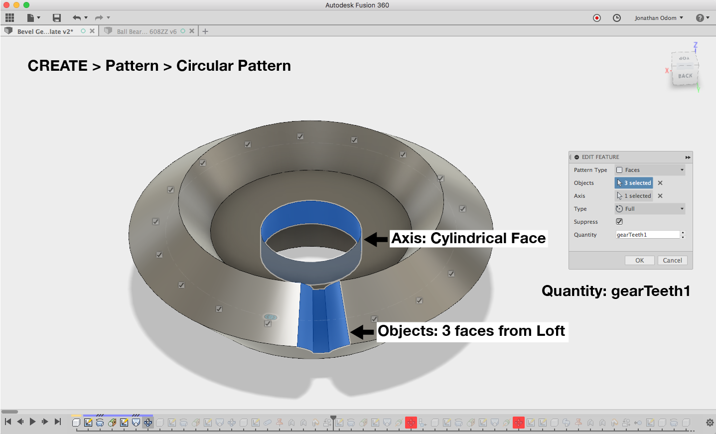

Now that you've got the tooth profile, you'll use CREATE > Loft to cut the shape out of the body of the gear. Profile 1 should be the closed profile from the most recent sketch, and Profile 2 will be the point at the top of the vertical line from the first sketch. This will cut out a tapered shape.

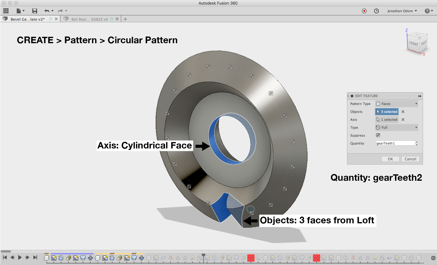

Now that you've got your tooth feature cut out, CREATE > Pattern > Circular Pattern to make all the teeth. Objects will be the 3 faces that make up the cutout, and Axis will be the cylindrical face in the center. Quantity is the parameter gearTeeth1.

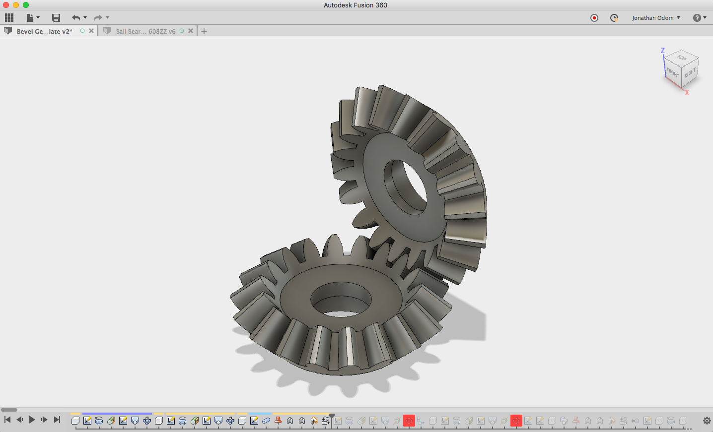

You should now have your first gear finished.

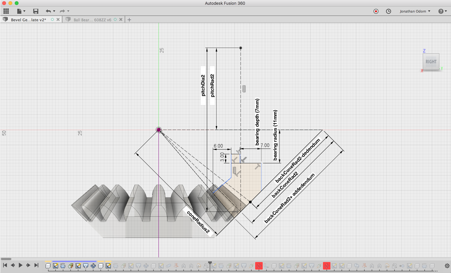

Next, you'll need to draw the cross-section of the second gear.
First, create a sketch in the Right plane. SKETCH > Project / Include > Project the point at the top of the vertical line from the cross section of the first gear. This will be your starting point for the second gear, ensuring that it meshes properly.

When the profile is finished, go to CREATE > Revolve to revolve the closed profiles that make up the cross-section. The Profile is the closed shape as shown above, and the axis is the first horizontal line drawn in the sketch.

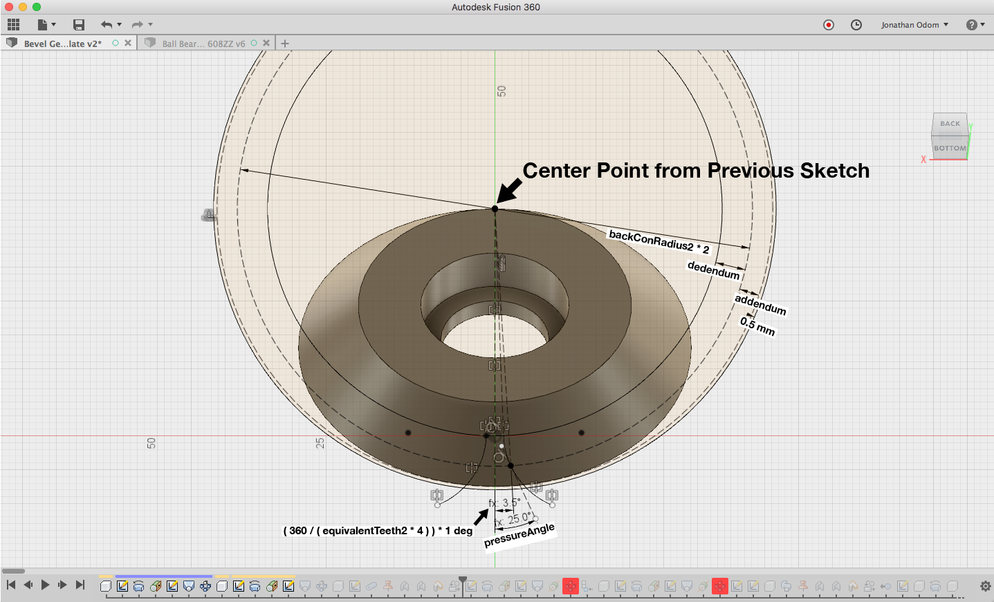

SKETCH > Create Sketch and select the plane you just made as the Sketch Plane. SKETCH > Project / Include > Project the point farthest to the right on the horizontal line from the previous sketch. This will serve as the center point of some concentric circles.
This sketch will be the profile of the tooth. Using the parameters listed above, draw the lines you see there with the parameters on the annotated screenshot.

Now that you've got the tooth profile, you'll use CREATE > Loft to cut the shape out of the body of the gear. Profile 1 should be the closed profile from the most recent sketch, and Profile 2 will be the point on the far right of the horizontal line from the first sketch. This will cut out a tapered shape.
Now that you've got your tooth feature cut out, CREATE > Pattern > Circular Pattern to make all the teeth. Objects will be the 3 faces that make up the cutout, and Axis will be the cylindrical face in the center. Quantity is the parameter gearTeeth2.

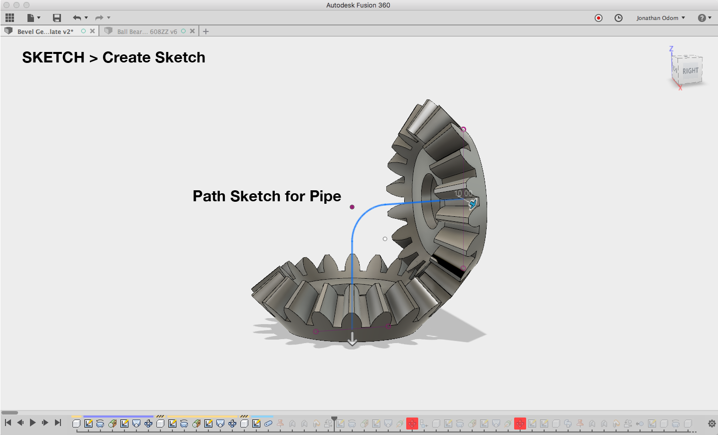

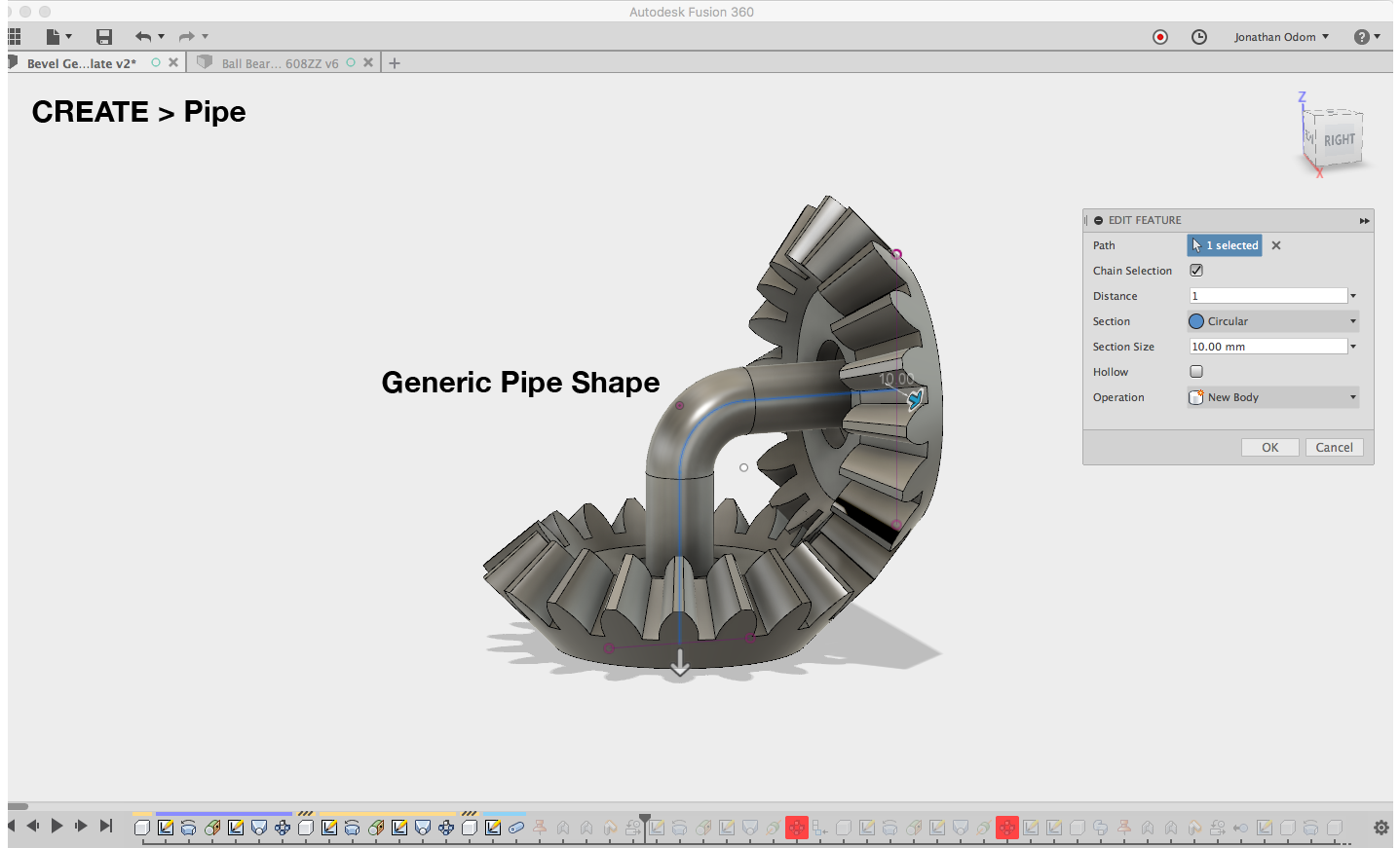

To make the gears move, you'll need a stationary component to join them to. For this example I just made a pipe from center point to center point of each gear.
SKETCH > Create Sketch on the plane you drew the first sketch on (Right), project the gears to give yourself some lines to work from, then draw the shape of a pipe from the mid points of the lines from the gears.
Scrub the video demo to 14:30 if you need a little help drawing these lines.
CREATE > Pipe, then select the path line from the previous sketch. The Section Size is arbitrary for the purposes of demonstrating the movement, but this pipe could be edited to press-fit the ball bearings.

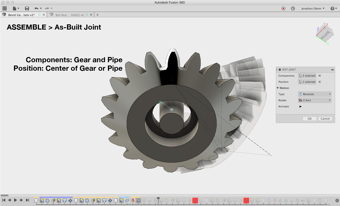

With the pipe component finished, right-click on it in the Browser and select Ground from the list. Go to ASSEMBLE > As-Built Joint and click one gear and the pipe. For Position, click one of the circular edges of the gear.
Repeat this step with the other gear.

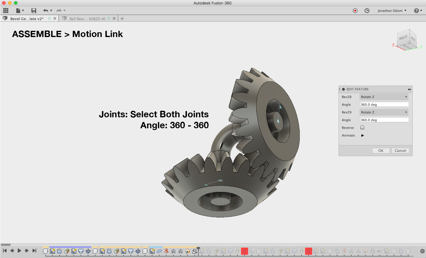

To see how it will move in real life, you can use a Motion Link. First, rotate one of the gears so that it meshes properly with the other one. Click on one of the joints, then set the angle to 360 / (number-of-teeth/2). Since there are an equal number of teeth and gaps (assuming the gear teeth parameter is an even number), that's the correct math.
ASSEMBLE > Motion Link, then click both of the joints. The default setting is 360º and 360º, which works in this case.
Right-click on a joint, then select Animate Model from the list and watch it spin!

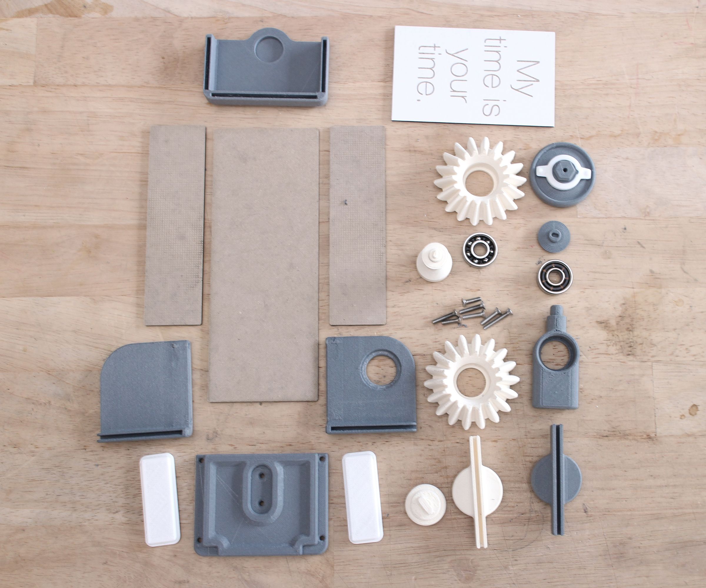

Step 8: Assembl the Crank Axle
The best way to put it together is to assemble the crank axle first. There's a little "spring" that fits inside the knob that acts as a clip- there are divots in the bracket that catch points protruding from the spring. This lets the sign stay at the proper angle at 180º increments.
- Press-fit the spring as shown.
- Insert the knob in the bracket with the hole in it as shown, then press-fit the "knobShaft" into it through the hole.
- Use an M3 X 20 screw to lock them together.
- Press-fit "gearSide" into the "knobShaft". This may need to be adjusted so that the rotation puts the sign in the right place later. You can do this by holding the knob and turning the gear slightly.
- Press a 608ZZ bearing into the "post"
- Insert the "shaft" into the opening on "gearSide".
- Press the bearing on the "post" into the end of the "shaft" so that the shoulder is on the gear side.
- Press the "endCap" into the other end of the bearing.
