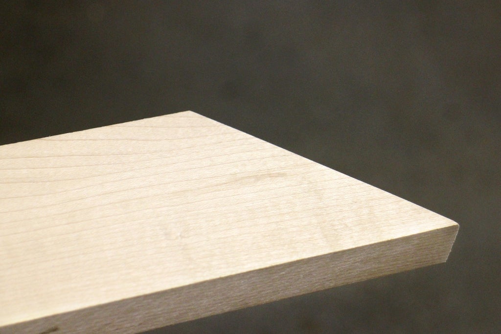

Bevel
A bevel is an angled cut relative to the face of the material. This can be an angled cut along the entire side of a plank of wood, or cut at the end of the wood. The picture above is a bevel cut into the end of a piece of wood.

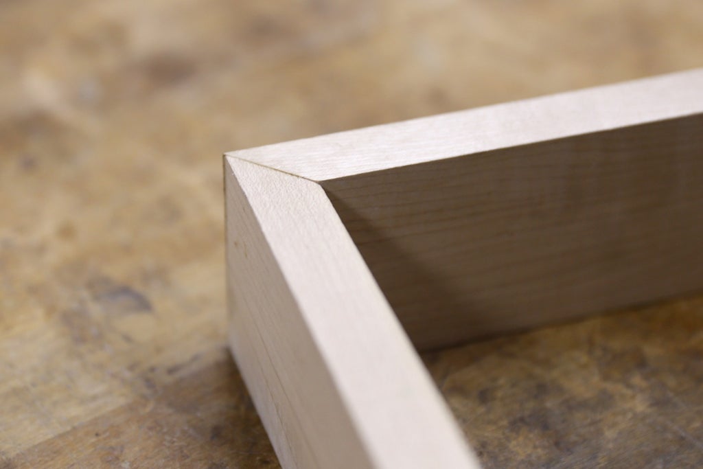

Mitre
A mitre is an angled cut cut relative to the square side of the material. This is most typically seen on wood picture frames. The image shown above is a typical mitre.
