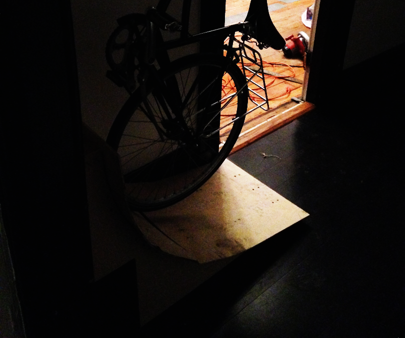

Introduction: Bike Ramp & Hook
A new method to store bikes in the home. Convenient and fun!
Step 1: Acquire Materials
Step 2: Build Ramp
Cut cardboard to 16 2' by 2' pieces
Stack 2' by 2' cardboard layers and fasten together with bolt
Draw ramp outline ramp
Use Exacto to cut ramp layers based on drawn outline
Cut cardboard to 6 2' by 3""
Stack ramp cardboard layers
Draw support beam outline (approx 1'' by 3'' slit)
Use Exacto to cut 1" by 3" slot across 16 pieces
Step 3: Build Wall Hook
Cut 10 3" by 8" pieces
Stack layers and fasten with bolt
Cut 8 5" by 5" pieces
Stack layers and outline hook
Use Exacto to cut out stacked layers of hooks
Measure width and length of non-curved end of hook
Cut by same width and length into middle of fastened cardboard stack
Step 4: Finishing Touches
Drill screws into stack of hooks
Glue non-curved end into rectangular space
Glue together 3" by 8" cardboard layerstack to make support beam and then glue to in slit on ramp
(Optional) Re-cut ramp so middle is staggered to provide track for bike wheel
