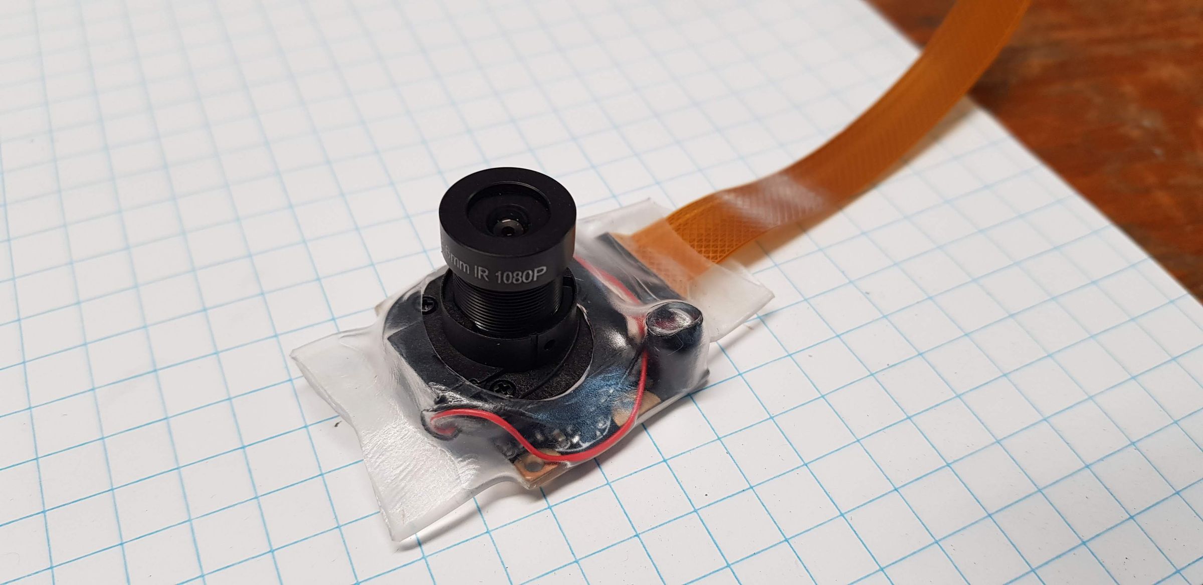

The BikeCamera is a video camera for your bike. I designed BikeCamera so that it is small, modular and easy to fit to your bicycle helmet or motorcycle helmet.
I decided to build my own video camera for cycling when I couldn't find a camera that could do all of the things I needed. Actually, I wasn't able to find a single camera that can do ANY of the things I wanted.
Your BikeCamera will give you excellent video quality, long battery life and very large storage for video files. You can also hide most of the components and keep a nice sleek-looking helmet.
The features of BikeCamera that I wanted are:
- Small enough to attach to outside or inside of a bike helmet
- Looks nicer than a Go Pro style action camera because most parts can be hidden
- Several hours battery life for long recording sessions
- Able to use very large memory cards.
- Fully configurable and controllable via a nice web interface
- Good quality video
- Windows file explorer and website download of video files
Have a look at this video to see what the BikeCamera can do.
NOTE about the video:

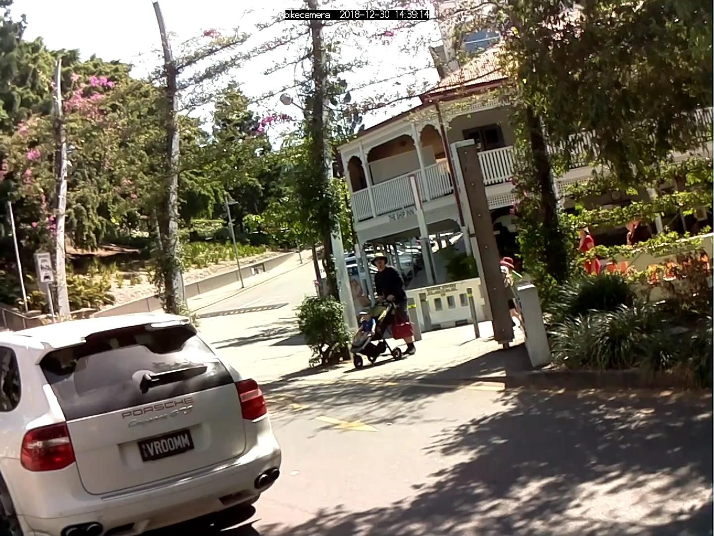

The sharpness of the video on YouTube is much worse than the real-life recording. BikeCamera video defaults to Full HD and looks very sharp. Car number plates and street signs are easy to read. On the other hand, the colours and brightness of the YouTube video are fairly accurate.

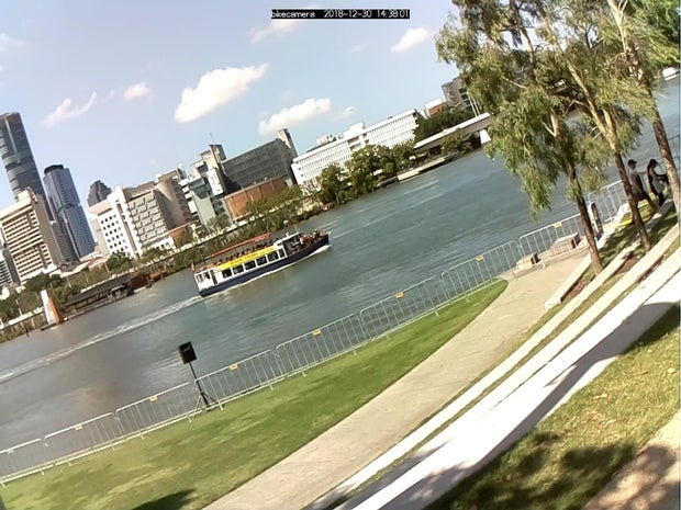

Some snapshots:
You can easily read the license plate of the Porsche. VROOMM!

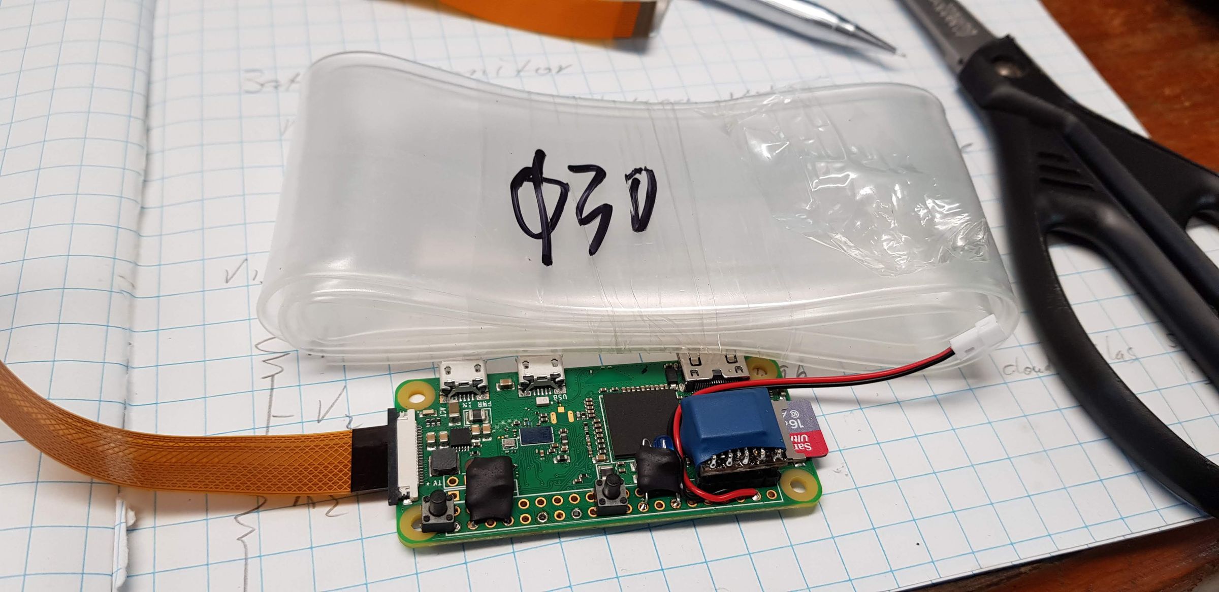

Highly recommended:
- Heat gun, hair dryer or some other way of shrinking the heatshrink tubing.

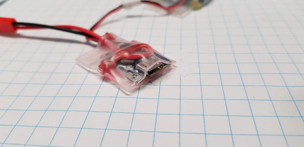

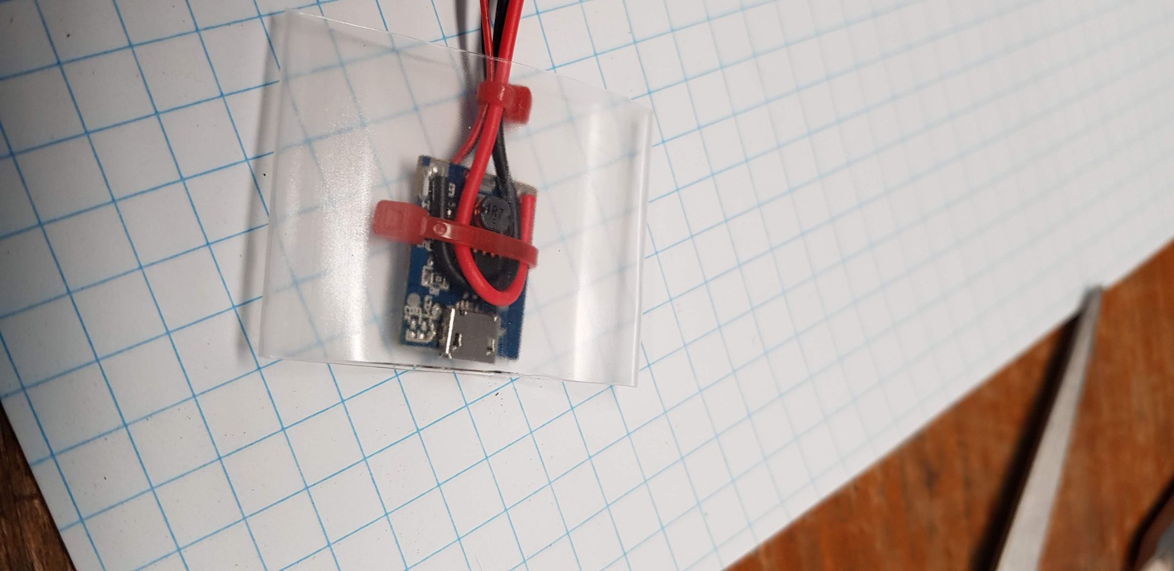

- A LiPo 1S 3.7V battery pack. See battery sizing section below.
- A USB charging module

- Clear heatshrink, 30mm diameter
- Other heatshrink as required

Step 3: Battery Sizing
You need to size your battery based on how many hours you want to record between re-charges. I like long pushbike rides, around 4 or 5 hours long. This means I need a large capacity battery to ensure the camera records for the whole ride. If you commute to work and it's 15 minutes each way, then a much smaller battery will be fine.
Battery life table
Use this table to work out what size battery storage you need
WARNING: USB battery bank storage numbers are highly misleading. In my experience, if you divide the advertised rating by 10 you get a realistic mAh rating. Seriously. I have no idea where they get their capacity rating numbers.

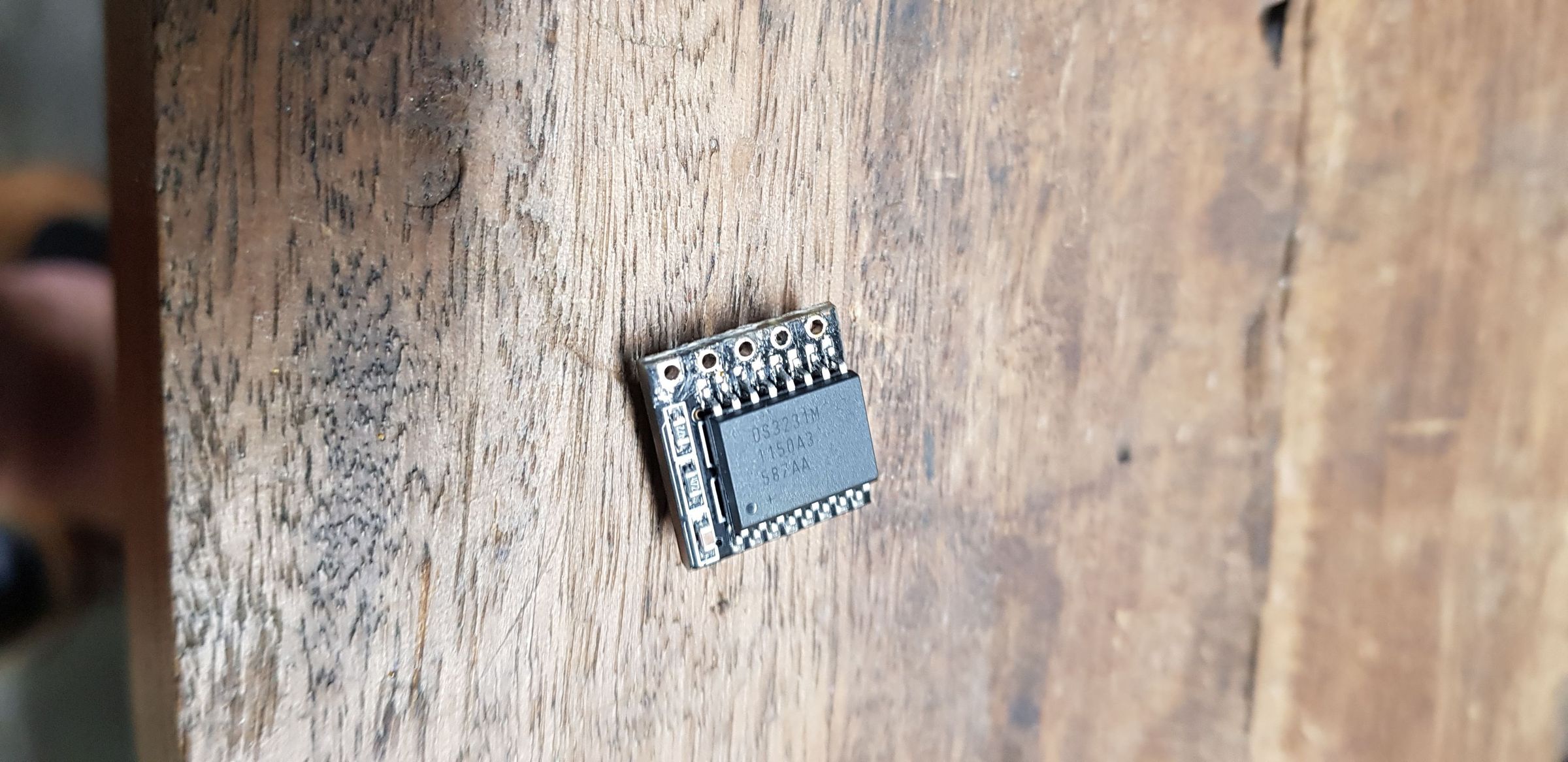

Step 5: Real Time Clock
Deciding about the Real Time Clock (RTC)
BikeCamera uses a Real Time Clock (RTC) module to store the time and date when it is powered down. The Pi has no way of storing the time and date on its own. Under normal circumstances, the Pi sets the time and date using a system called Network Time Protocol (or NTP). The Pi contacts a NTP server on the internet every time it is powered up.
This works fine for most Pi applications because the Pi will be powered up with some type of network access. For this project however, NTP is unlikely to work reliably. The BikeCamera can easily be powered up away from home where there is no internet access.
Say you are on a ride and you decide to stop somewhere for an hour and have a leisurely lunch. You don't want your BikeCamera using up your battery, so you shut it down. Without a RTC the date and time on the pi will be wrong. Not wrong by a little way, either. The time and date will be complete rubbish.
For normal day to day riding, having inaccurate time and date is an inconvenience. But in the case of an accident or other important event it is very important that the time stamp on the recording is 100% accurate.
This is why, for most users, I strongly recommend installing a RTC.
So, for users of the minimal configuration: If you need the time and date to be accurate on your BikeCamera you MUST be within range of your WiFi when you power up the camera.

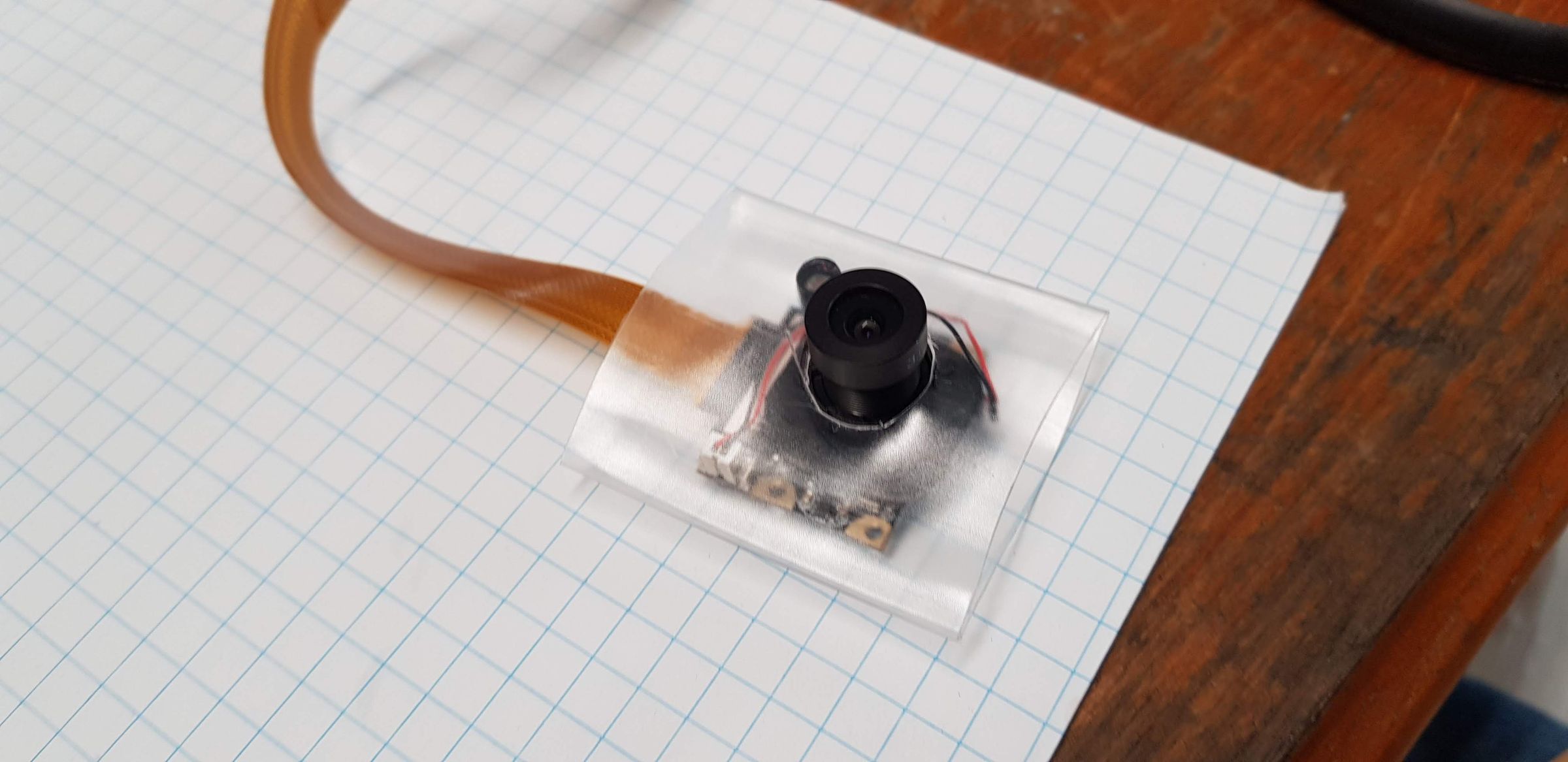

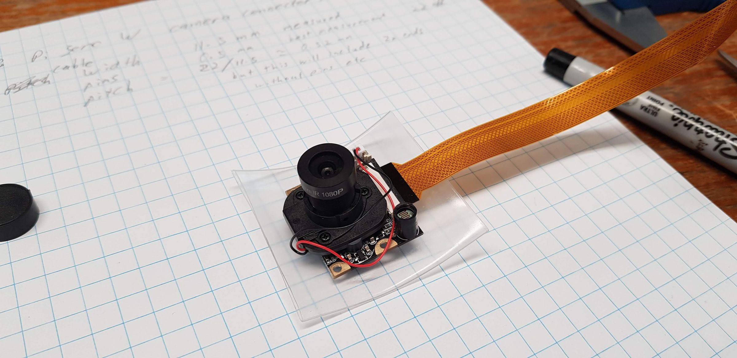

Step 6: Choosing a Camera Module
I recommend that you use the camera module detailed in the parts list, but you do have options.
For the BikeCamera, the camera module needs to be:
- Wide angle. The standard Pi camera modules are fairly narrow view.
- It must work for day and night.
- I will usually have well lit streets, so extreme low light sensitivity is not necessary.
- Clarity is important. I want to be able to read street signs and license plates.
There are several other camera modules available that are made for Raspberry Pi. You can use any of them without modification to the project, but be aware of the compromises.
Some camera modules may be advertised for Pi 3, Pi Zero etc. The camera modules can all be connected to any model of Raspberry Pi. The only difference is that the cable for the Pi Zero W is smaller on the end that connects to the Pi. The connectors on the camera module end are all identical.

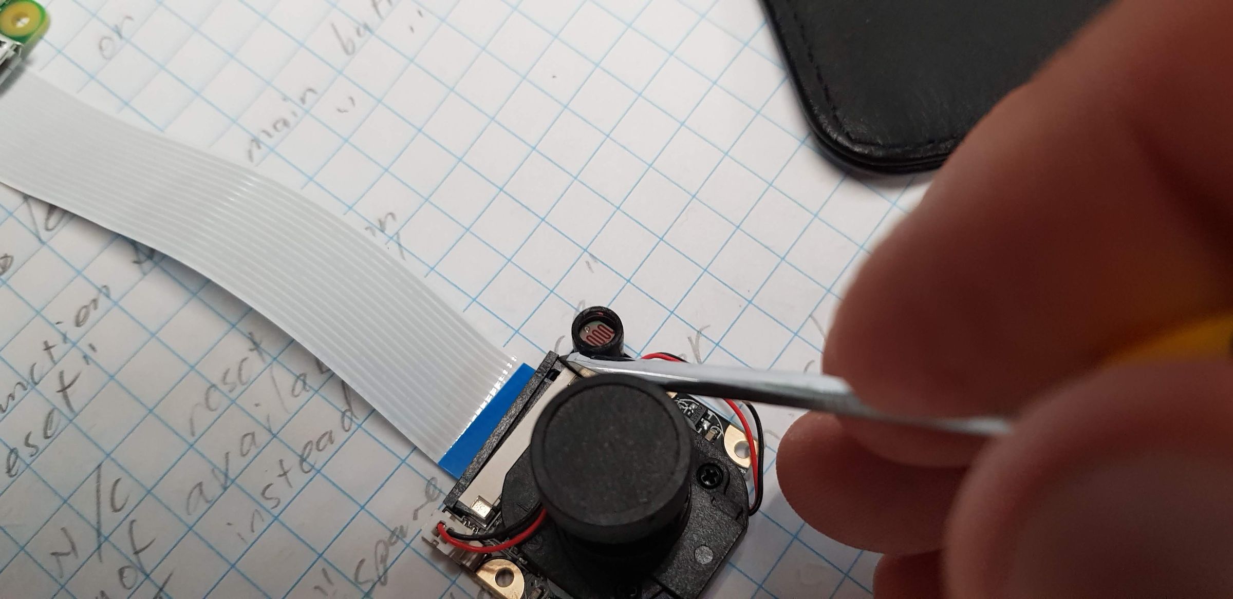

Step 7: Camera Cable

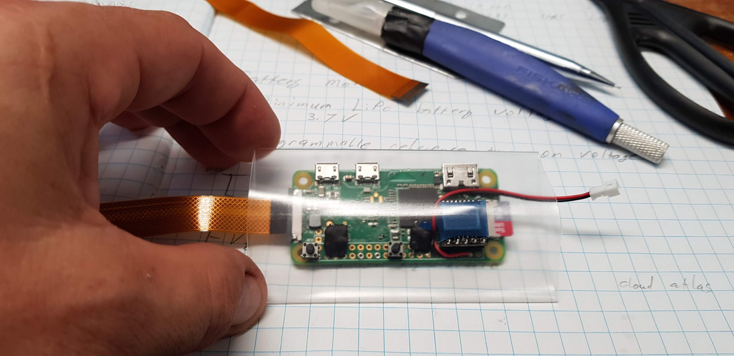

Warning: Be careful with the camera connector on the Pi! I have found this connector to be very fragile (i.e. I broke two of them). Once the camera is connected to the Pi, I highly recommend the following: If the cable must be disconnected, disconnect the cable at the camera end and never the Pi end. The connector on the camera module is larger and harder to break.
Let's start by connecting the long camera cable to the camera module. The module comes with a short camera cable already attached. The camera cable is the flat cable coming out of the module. The connector for that cable has a white part and a grey part. The grey part clamps the cable in place. The clamp slides a small way out, directly outwards in the direction of the cable.
Use something with a fine point, like a small screwdriver, to gently push the clamp towards the flat cable. The clamp will only move two millimetres or so. Any more and it will break. You should be fine, just take your time and don't force it. The old camera cable should now slide out without any force.
Slide the new cable into the connector. The metal contacts on the cable should face down, pointing in the opposite direction to the lens. Gently push the clamp back into place.
OK, now that you have practised with the bigger connector, it's time to try the Pi's small one. The procedure is exactly the same. Slide the clamp outwards with your small screwdriver (or whatever). This smaller clamp only moves about 1mm, not 2mm, so be careful.
Slide the cable all the way into the connector and slide the clamp back into place.
That wasn't so bad, was it?

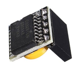

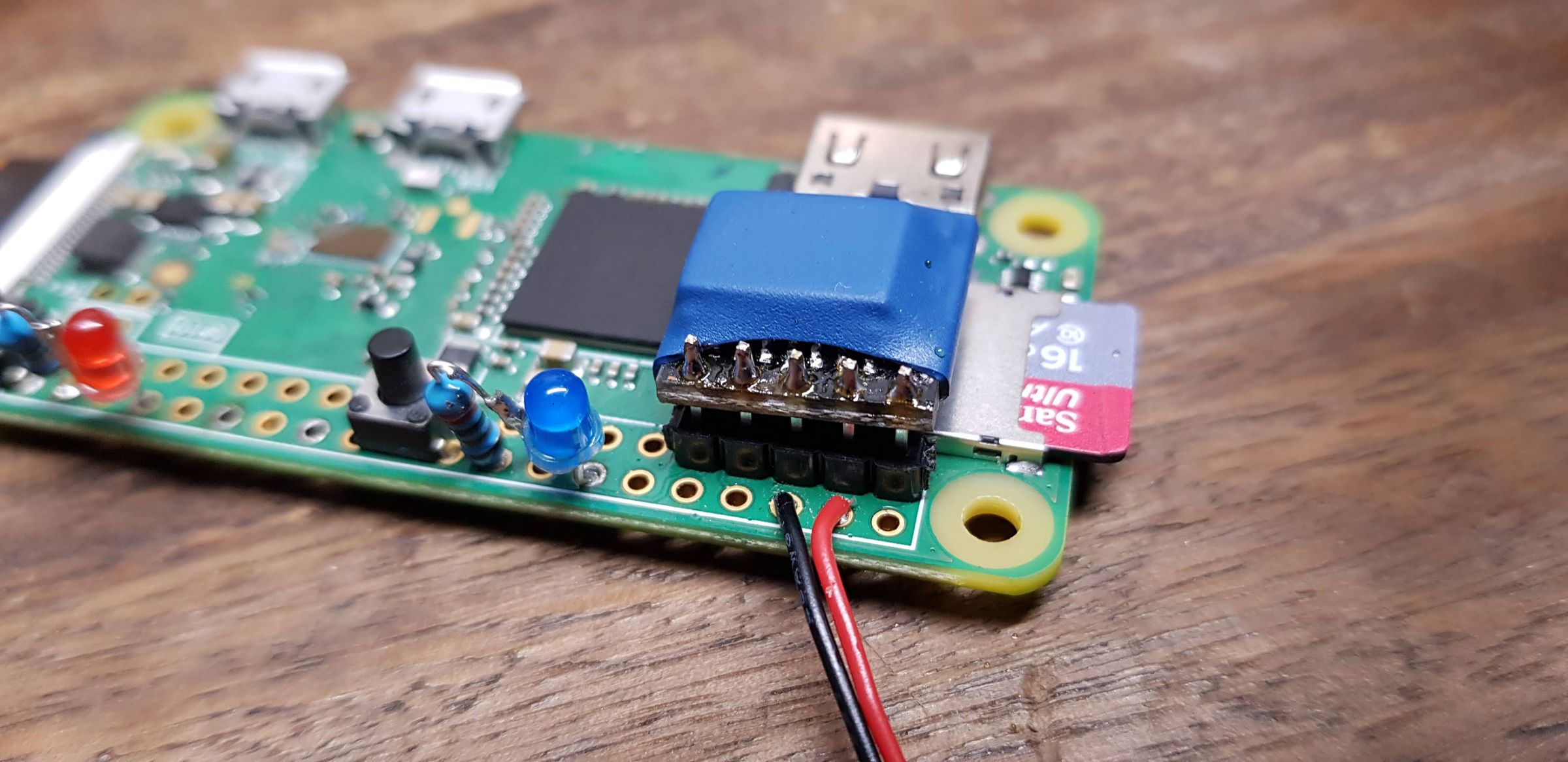

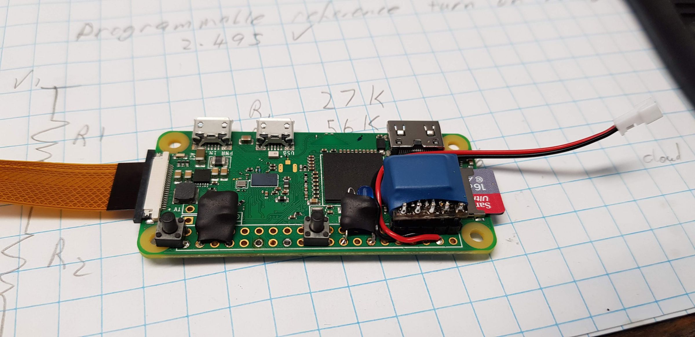

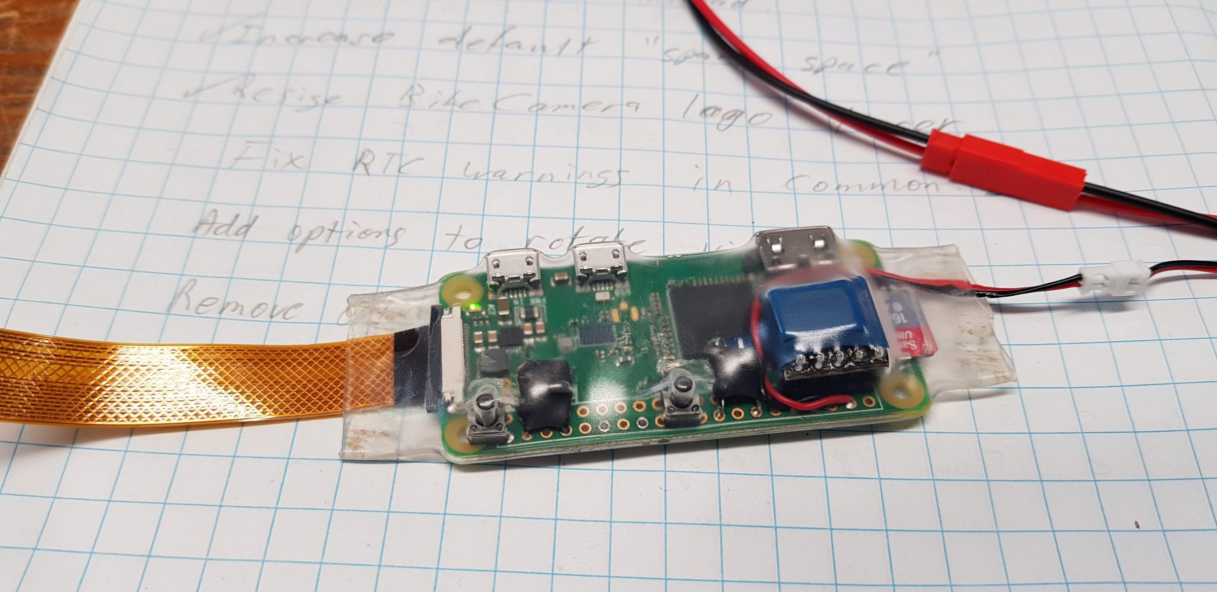

Step 11: Installing the Real Time Clock (RTC)
I connected the RTC to the Pi by soldering five header pins into the Pi. The pin connections of the Real Time Clock are aligned to match the pin connections on the Pi.
The pins you need are pins 01, 03, 05, 07 and 09. (Pin 07 is unused, but it will help mechanically support the RTC module.) Before installation, I insulated the RTC module with heatshrink. This is necessary to stop the RTC module circuity shorting out on the SD card holder shell.
You can now simply plug the RTC module onto the header pins.
I decided to make things a little bit more solid by unsoldering the header socket from the RTC and directly soldering the module onto the header pins. This is not necessary.

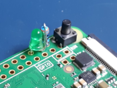

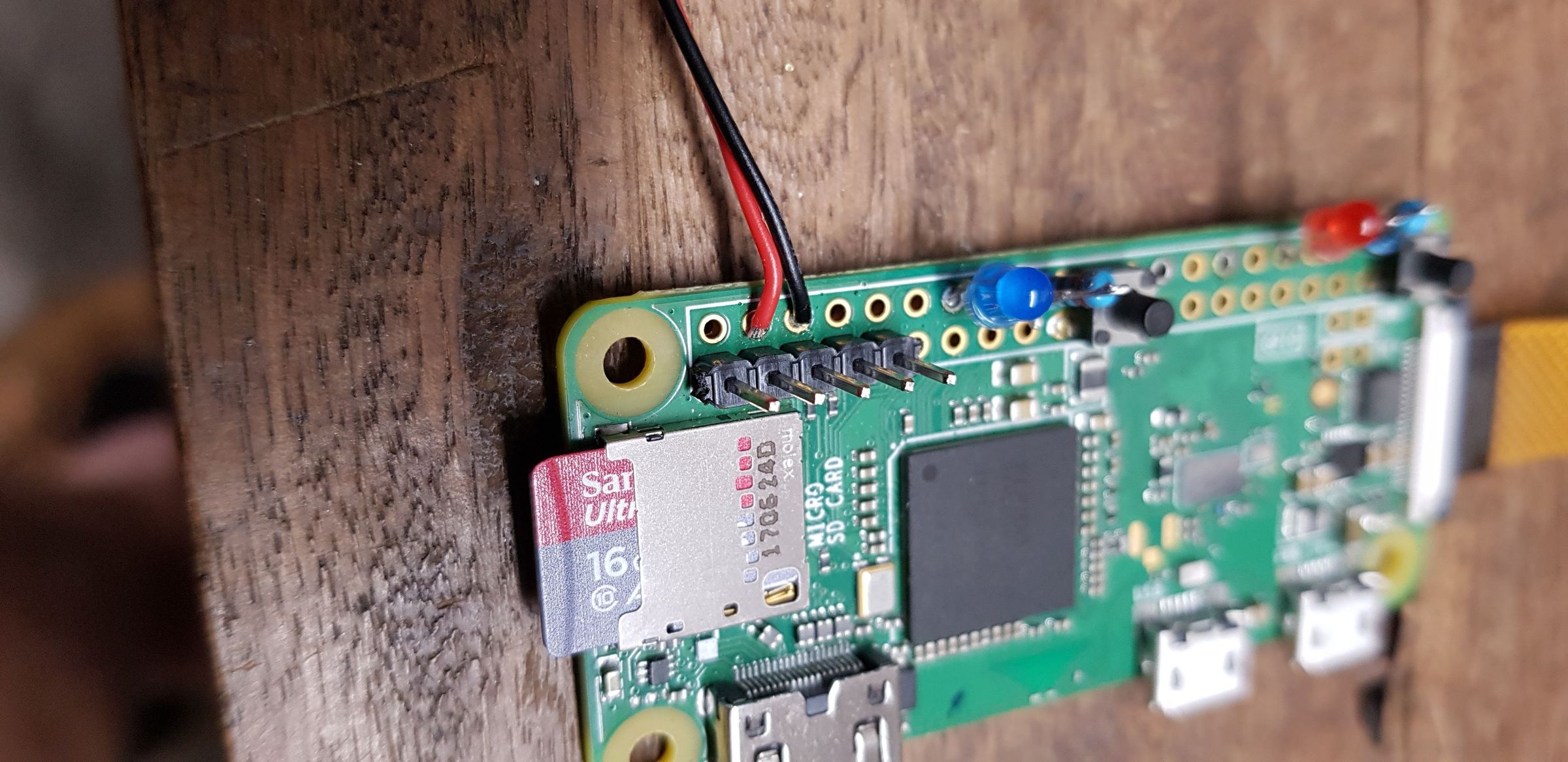

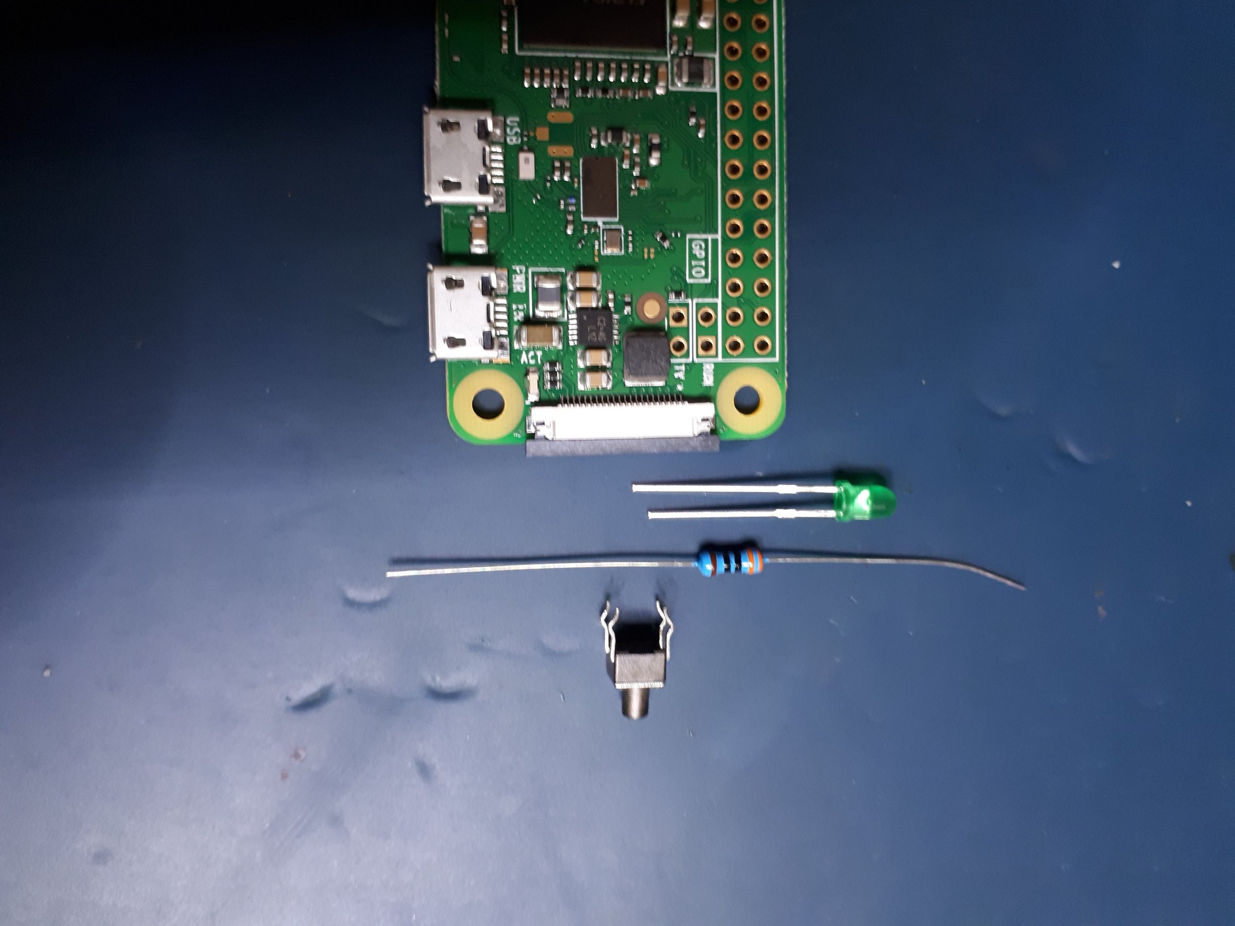

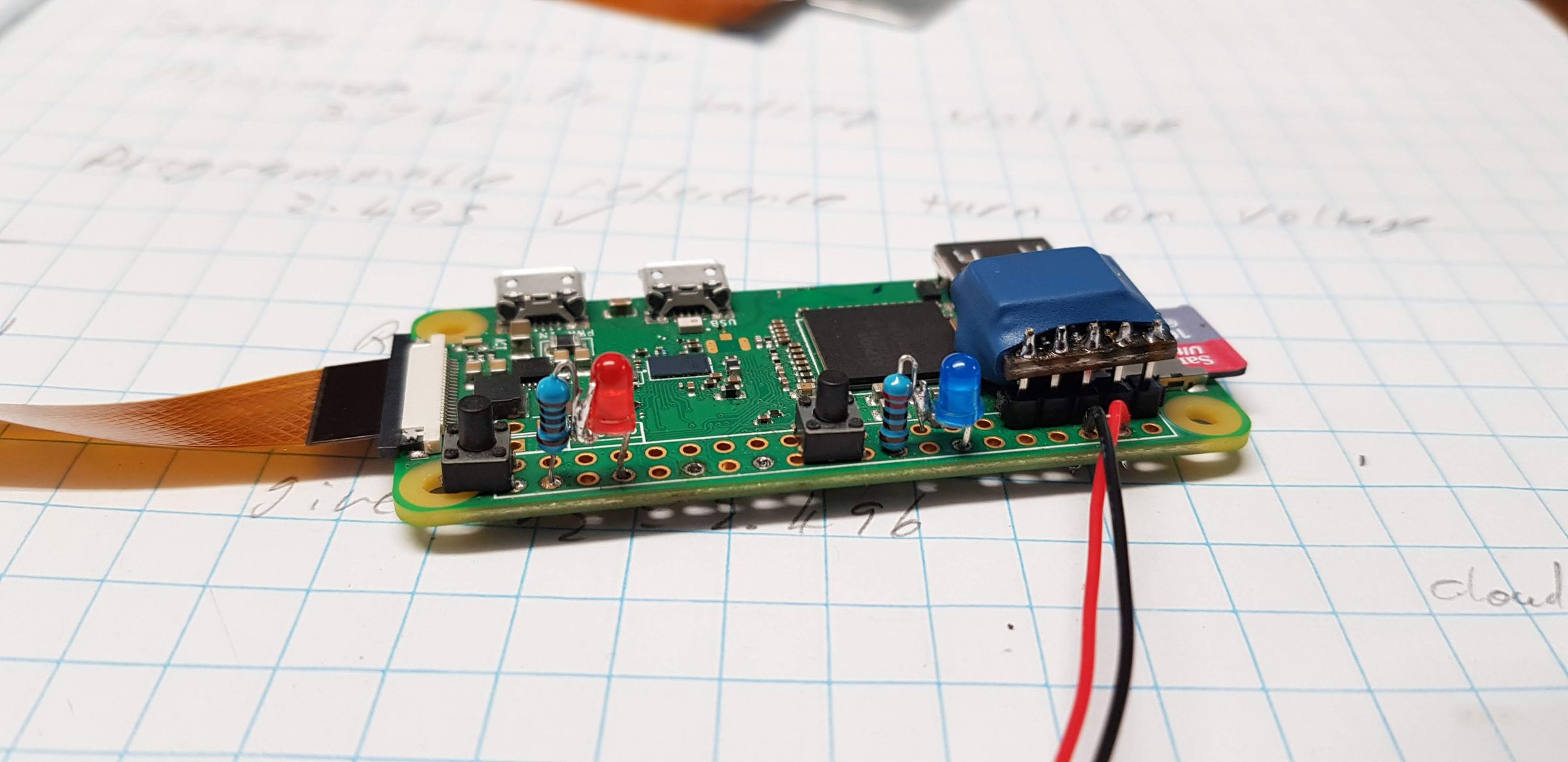

Step 12: LED Installation
The BikeCamera can have two LEDs fitted. One shows the recording status. The other shows whether a reset or a shutdown mode is about to be executed.
Any LED with standard leads can be used. You choose the colour and size that suits you.
Solder the resistor to the LED anode.
Solder the LEDs and resistors into the Pi GPIO connections as shown.
I have chosen the GPIO connections so that the resistor and LED fit comfortably onto the board. Leave a couple of millimetres clearance between the bottom of the components and the board. This will allow you to bend the components flat to the board after insulating with heat shrink.
Heat shrink the LED and resistor. Bend the LED and resistor flat to the board, towards the centre of the board.
Step 13: Pushbutton Installation
The push buttons are quite easy to fit. Use the type micro momentary tactile, size 6mm x 6mm. You can choose the height of the push button to suit you. I used buttons with an actuator 8mm high. To be honest, this was a bit too tall. Perhaps use 4mm or so.
You'll see that there are two sides of the button which have leads coming out. Cut off the two leads on one side of the button. Cut as close to the side of the button's case as you can.
insert the other two button leads directly into the GPIO connections as shown. The pins on the button are just slightly wider than the hole spacing on the Pi. You have to push the button down with a bit of pressure, but the fit is pretty good. Solder, and you're done.

Step 15: GPIO Power Connection
I used micro JST connectors for supplying power to my BikeCamera. The power is supplied directly to the GPIO pins, so the Pi no longer needs power through micro USB. The advantage of this is that the wiring is much smaller and more compact than using USB. The USB cable is rather thick and doesn't bend easily into place. And the USB connectors themselves are quite large, which means that you need to allow extra room to allow them to fit into your helmet.
The specific connectors I used are micro JST PH 1.25mm pitch 2 pin connectors.
First, get the male micro JST connector and solder it to the Pi. The positive (red) wire goes to pin 2 on the Pi. the negative wire (black) goes to pin 6.
Solder the female end of the micro JST connector to the outgoing pins of the LiPo charging board.
This step depends on the design of your charging board. For my board, I needed to unsolder and remove the outgoing USB type A socket from the battery charging board. Your board may have pad connectors for outgoing power. If you're using the USB connector pads, the outgoing power is the two outside pads. If you're not sure which pin is positive and which is negative, check HERE.

Step 17: Waterproofing the Pi
Use 30mm clear heatshrink tubing for waterproofing your Pi.
Cut the heatshrink tube so that it is approximately 15mm longer than the Pi. If you're using a USB connector to power your pi, try to slip the tubing over the Pi with the connector inserted. This will greatly help waterproof your pi.
Get your heat gun and heat the tubing evenly on all sides. There's no need to rush this step. Try to heat gradually so things are more under control. Now for the hot bit. When the tube has shrunk sufficiently, press the ends of the tube together so that they are flat. These flattened ends stick reasonably well to each other and form quite a good waterproof seal. Any wires or cables will be neatly sealed in place too.
If you have added buttons to your BikeCamera, test to see if the buttons still operate through the heat shrink. I found in most cases that they work fine. If they do not, then gently re heat the tubing above the buttons. Pinch on the tubing and try to stretch it and stand it up taller above the buttons. This always solved any problems I had.
If you need to use the micro USB socket for charging and you weren't able to cover your connector with the tubing, now is the time to cut away the tubing covering the USB power connector. Use a small craft knife or similar to cut a neat hole. I show this process in the video.

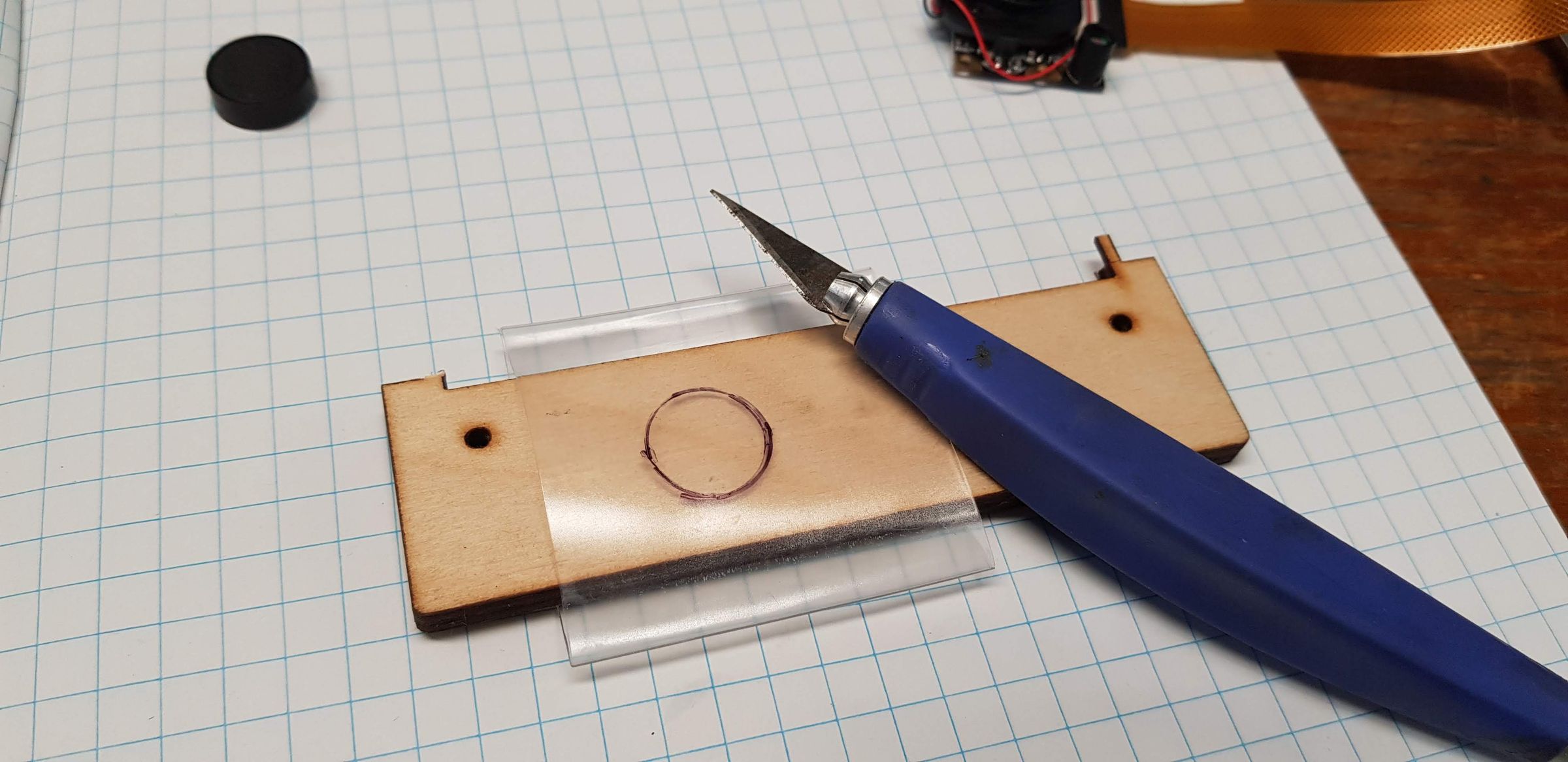

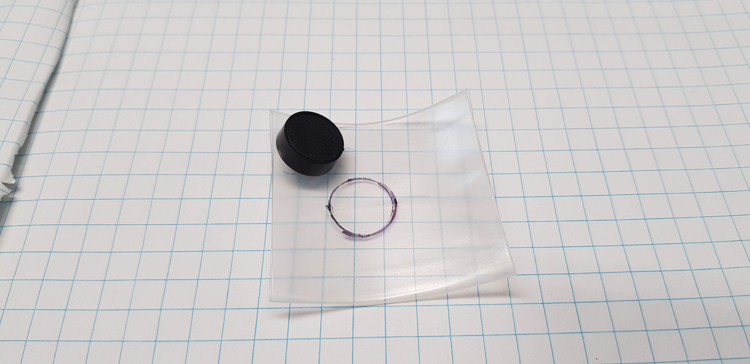

Step 18: Waterproofing Your Camera Module
Cut a piece of 30mm heatshrink tubing that is approximately 20mm longer than the module.
Cut a hole in the tubing for the lens. This hole needs to be about the same diameter as the lens. I used the lens cap to mark the hole. FYI, while the rest of the tubing will shrink, this hole will stretch significantly.
I placed a scrap of wood inside the tube while I was cutting the hole to make sure I didn't cut through both sides of the tube.
As with the Pi, seal the ends by pressing them flat while the tube is cooling. At the same time, tidy the tubing around the lens to make the seal as effective as possible. Yes, I know this would be much easier if you have three or four hands. Just make it up as you go along.
Step 19: Waterproofing Your Charging Board
You don't need this step of you are using a power bank.
For this board, cut the tubing 15mm longer than the board at one end only. The other end of the tubing should be flush with the end of the board, leaving the USB connectors exposed.
Gently heat the tubing and flatten the end to seal as per the other modules.

Step 29: Pushbuttons and LEDs
Power pushbutton and LED
The Power LED will be lit whenever the Pi has booted up. The Power pushbutton has three functions:
Reset. If the power button is held down for at least 1 seconds and then released, the BikeCamera will perform a reset. When in the Reset mode, the Power LED will flash slowly.
Shutdown. If the power button is held down for at least 6 seconds and then released, the BikeCamera will shut down. When in Shutdown mode, the Power LED will flash fast.
Factory reset. If the power button is held down for at least 15 seconds and then released, the BikeCamera will perform a factory reset. When in Shutdown mode, the Power LED will flash very fast.
Recording pushbutton and LED
The recording LED will be lit whenever the camera is ready to record video.
Press the button once to start recording. The LED will flash when the BikeCamera is recording video.
Press the button again to stop recording. The LED will stay lit.
