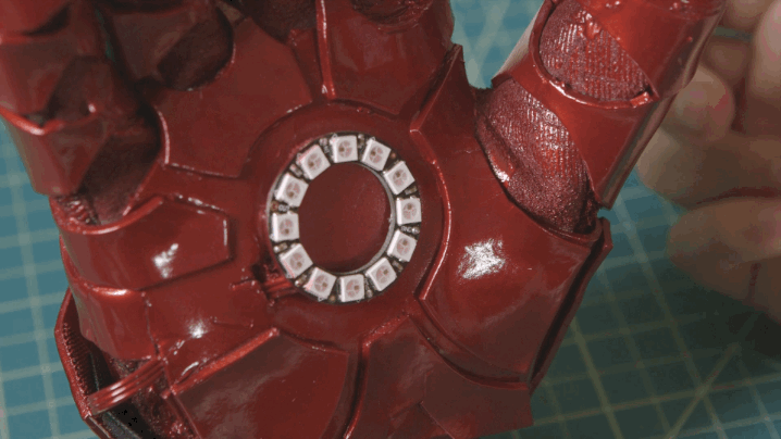

Step 3: Wire the NeoPixel Ring
OK by this point, the Lilypad MP3 should be able to play sound through the speaker you've attached. Now, we're going to work on hooking up the NeoPixel ring to make an awesome glove repulsor.
- Cut off a reasonable length of servo wire (or three strips of wire if you're not using servo wire) and strip ~1/8 inch from both ends.
- From the bottom side of the board, insert the servo wire into the NeoPixels pins.
- The red wire should go in the power (PWR / 5V DC Power) pin, the black wire in the ground (GND) pin, and the yellow wire in the input signal (IN / Data Input) pin.
You could alternatively use a 3-pin Molex, JST, or some other type of connector so the NeoPixel can be disconnected from the rest of the setup.
Photo credit: Adafruit

Step 5: Test the NeoPixel Ring
Time to test the NeoPixel ring. To do this, we'll need to upload new test code to the Lilypad MP3's microcontroller.
- Connect the 5V FDTI programming cable to the Lilypad and a computer.
- Grab the Arduino NeoPixel test sketch from our GitHub repository and open it in the Arduino IDE.
- In the Arduino IDE, click on Tools and make sure the board is set to "Arduino Pro or Pro Mini (3.3V, 8 MHz) w/ ATmega328".
- Yup, that's right; you need a 5V FDTI but use the 3.3V board setting... it's a bit unusual.
- Upload the sketch to the Lilypad MP3.
- Note: Make sure the Lilypad MP3's power switch is set to ON. You'll get a sync error otherwise.
- Disconnect the FDTI cable, connect the LiPo battery, and turn the Lilypad on.
- The NeoPixel should turn on and loop through two light sequences.
- The first is a "rainbow comet" where the light travels around the ring in a clockwise fashion changing colors as it goes,
- The second will "wipe" along the ring coloring each LED green and then pulse in brightness a few times before "wiping" the LEDs off.
- These are the same sequences that occur when turning on the completed glove.

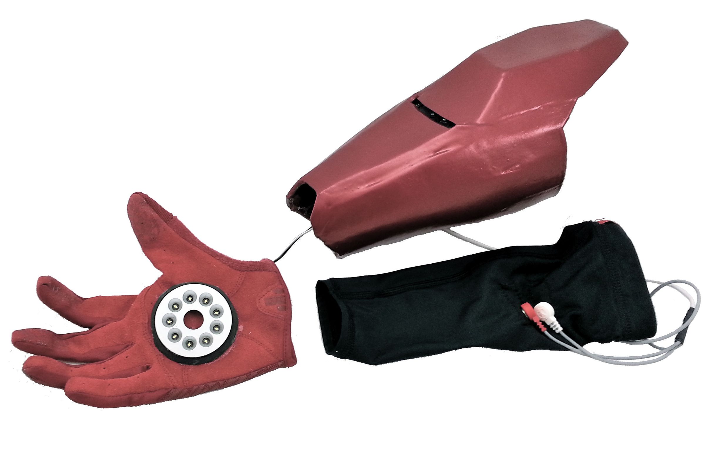

Step 11: Attaching the System to the Glove
If you aren't going to build the foam armor for the glove, the next step is pretty straight-forward.
- Grab either the hot glue gun or the sticky backed velcro and the glove you've picked out.
- Attach the Lilypad and the speaker to the back side of the glove.
- Attach the NeoPixel to the middle of the glove's palm.
Congratulations! You've just built your own bionic blaster glove. Now get started on the glove for the other hand!

- Hot glue the painted pieces to the base glove.
- Velcro the Lilypad MP3 to the back of the glove and fit the battery where ever there is room.
- Hot glue the NeoPixel to the palm.
