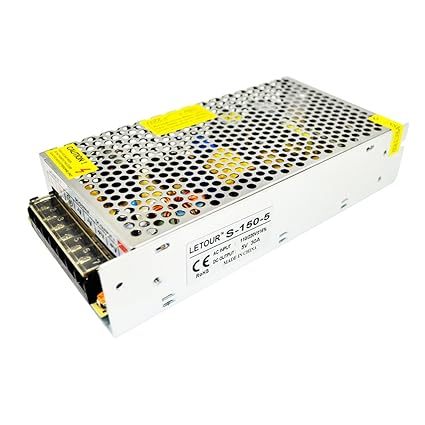

- A power supply. Most addressable LEDs on the market are 5V. The amperage needed depends on the size of your setup*. (~$10-50 depending on your setup)

Most of you, however, will probably need a power supply. The calculation is (Amperage) = 0.075*(Number of Pixels). This is with a safety margin built in (at full draw your power supply will be operating at ~75% of capacity. This will keep your power supply running cool and thus consistently for long periods of time). Going significantly below this runs risks of overheating and even fire. Some power supplies will also require you to attach your own AC wall plug. For displays that use multiple full led reels, I highly recommend you power inject. This will be talked about in the next section.
** Size your wire properly! SAFETY FIRST spending an extra few dollars might save your home.
(If you are curious I am using two 5V power supplies each with two 30A outputs, and 12 gauge speaker wire. This allows me to inject sufficient power at four points along my LED strip. I am using ~21 meters with density of 60 LEDs/meter.)

Many of the larger power supplies have multiple output pairs (Two as seen in the example in the seventh picture).
This is great for us since we can attach each output from our power supply to the beginning of each of our LED reels and distribute the power separately to each reel at much more manageable amperages. You will just need to get enough such power supplies so that each reel can connect to its own 5V output pair.
You could also use fewer, but larger capacity power supplies (30A, 35A, etc. although they get pricy). If you want optimal results in any power injection, you should try to distribute the power injection points as evenly as possible along the string. The only downside is that the injection points probably will not align with the pre-attached injection points, possibly requiring you to do some cutting and soldering.
