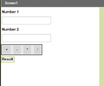

Step 2: MIT App Inventor
You can use the MIT App inventor to create an app that will send signals to the arduino if you have basic knowledge of MIT App Inventor. Or you can just download the app from here.
https://drive.google.com/file/d/1-DmnLtBzIBJTTe_ZWne-pzoZ5YK4l_Jw/view?usp=drivesdk
If you want to design your own app here's how you can do it.
Step 3: Designing the App
You will first have to add the elements such as buttons and labels as given in the above image. You will have to insert 4 buttons and 1 list picker (to show available devices.) as given above. After doing this you will need to move to the 'blocks' window where you need to code the app.
Step 4: Block Code
After designing the app, you need to code it. The block code is given above. It will help to select a device using the list picker and then send commands to the arduino using bluetooth. Based on these commands, the car will move forward, backward, left or right.
