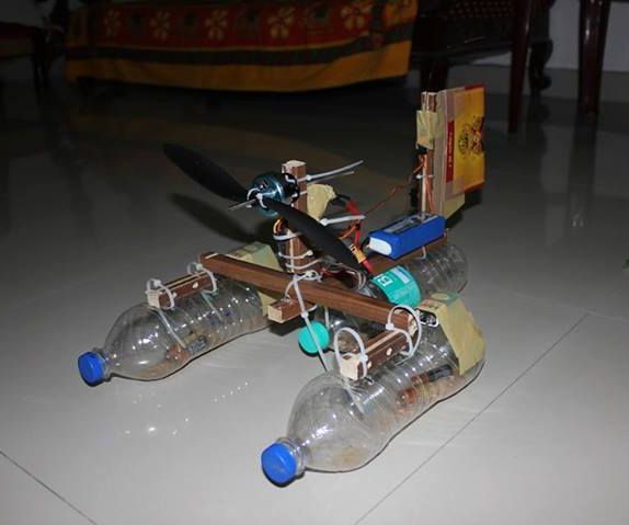

I've been planning to make an RC boat to roam the waterways that are present in my apartment complex for a long time. But one hickup or another kept holding me back. Most of the time, it was lack of required materials or time. Even this time, my soldering iron committed suicide under mysterious circumstances just before I started making this. But I put my foot down and decided to make it without soldering and using just jumpers, insulation tape and lots of double sided tape. So i present to you the SS Scrap v1.1

Step 2: Connecting the Servo
The servo runs directly of the 5V provided by the Arduino. But in some cases, as happened to me, the Arduino cannot provide enough current to drive the servo, especially when it starts moving. This leads to random restarts and your code will never behave as you want it to. So connect the capacitor along the power leads of the servo, making sure that the positive (ie longer lead) is connected to the 5V pin and the shorter pin to ground. This will store charge and provide the extra current required. The third pin of the servo is connected to pin number 9 on the Arduino.

Step 4: Motor Connections and Mounting
The motor I was from and old toy plane which gave a lot of power for it's size. I didn't have a motor driver so this motor would be kept running while only the direction would be changed using the servo. The motor can handle only a maximum of 4-5V hence a separate battery supply was used. I used 2AAs in series taped together to give around 3V. This motor was peculiar as it always required an external force to start, kind of like world war I era biplanes. Hence, once it started it had to be kept running or it wouldn't start again.
The motor was attached to the servo using double sided tape over which I layered insulation tape for further safety. The whole servo+motor assembly was mounted on one end of the plastic box on top of a rectangular piece of thermocol to provide room for the propeller during its full range of motion.

Step 6: Final Assembly
So the final assembly consisted of cobbling together everything and putting it in the box. The Arduino was fixed in the center using double sided tape and the Bluesmirf was mounted a little higher up using a piece of cardboard. The 9V battery was connected to the vin port of the Arduino and it was attached near the end opposite to the motor using double sided tape along with the batteries for the motor. The wires for the motor had to be long enough to allow freedom of movement. The batteries were moved around to ensure the CG was maintained and the boat did not have a tendency to topple over.
Step 7: And Done..... That Was Easy
That's it! The motor has to be push started everytime as said before. Connect through bluetooth using any android phone running the blueterm app. The controls are
1- left
2-forward
3-right
The motor keeps running independent of the arduino so if you lose connection, it still continues to move.
I haven't tested it outdoors as the winds are too high, but indoors or in calm water it handles pretty well and it depends on whether you can react fast enough to control it properly. It is quite responsive and the better the batteries are for the motor the better it will handle. This was a fun project which behaved as its supposed to for once. Please leave your comments below and vote for me in the contests i'm entering this in.
