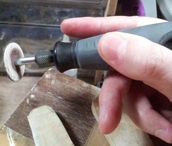

STEP 1: Handle the Tool Lightly and Work From Right to Left
Handling the tool lightly may mean you have to study just how you are holding the dremel. Loosen your grip and let the weight of the dremel be the driving force, not the pressure you put on it. Come at edges with care, nice and slow. Get a feel for how the carving bit reacts to edges. Don’t work left to right for a while; moving the dremel with the flow of the rotation (left to right) will only help it fly off the handle. Instead, working against the rotation, right to left, won’t allow the bit to jump around.
Work slowly until you get the feel for carving with a dremel. Think of it like a date, and go slow. You’ll be amazed how with more skill the faster you go. But pressuring the tool to work faster will cause frustration.

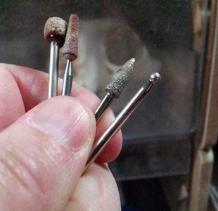

STEP 2: Use Sanders and Diamond Carvers to Remove As Little As Possible
Use diamond-coated bits and sanders to remove material in shavings instead of tiny chunks.

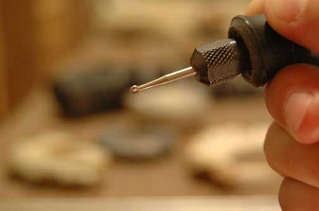

STEP 3: Beware of Those Edges
Beware of edges! Or, be very aware of where the edges are, so your burr cannot clip them too hard. This is the biggest thing people get stuck on: those edges are tricky and can really give you a scare.

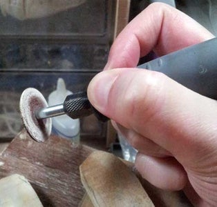

STEP 4: Lubrication
Lubrication is important as it will extend the life of your cutter. I keep this little bowl of liquid lubricant right where I am carving and I dip my cutters into it (still spinning) from time to time as I work. Try an experiment and carve a little completely dry. Then dip the cutter into the lubricant and try carving. Feels smooth as butter after the dry, bumpy ride.
