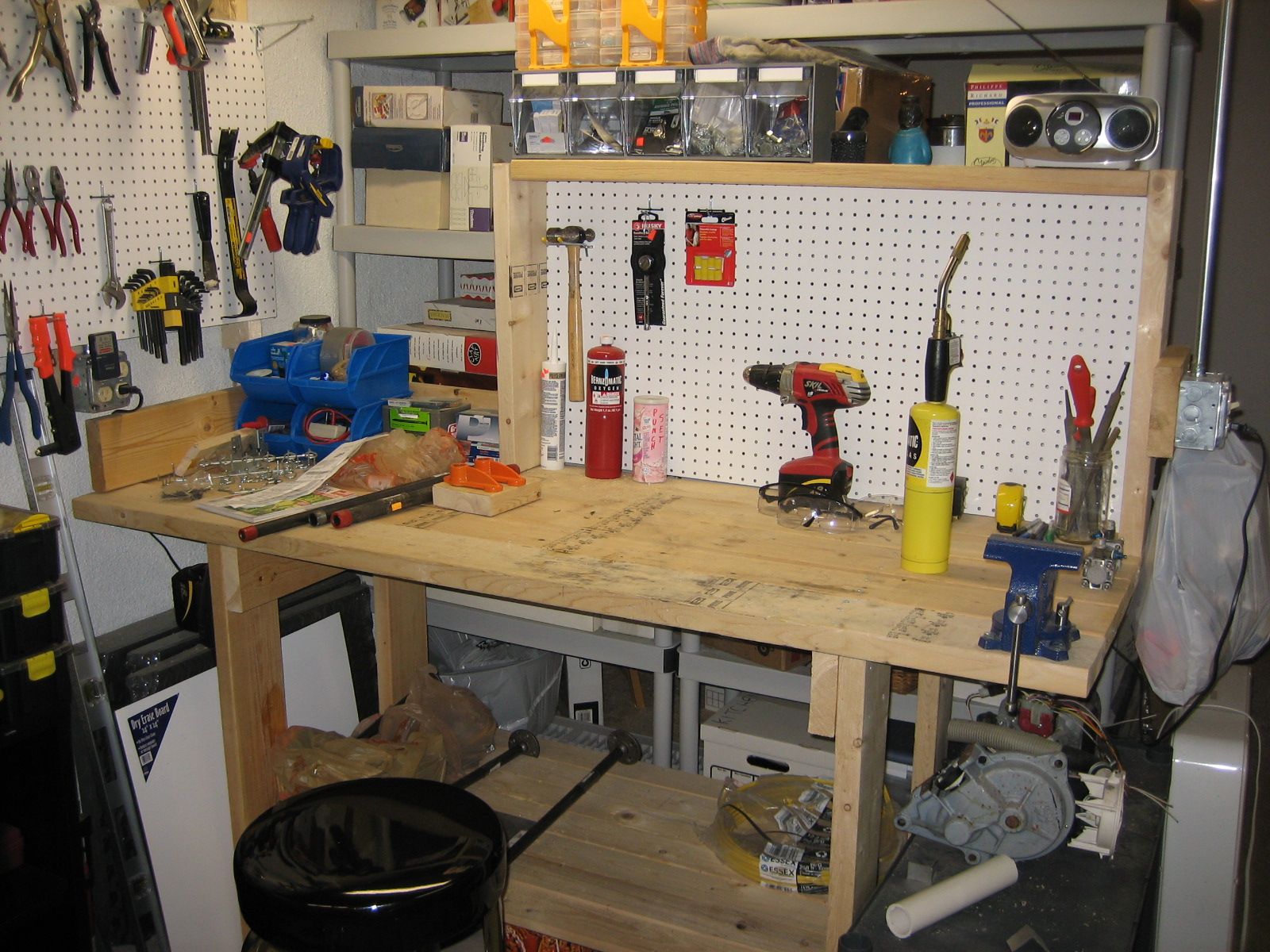

The base of the press needs to be made next. I used a spare piece of 2X6 left over from my work bench.
