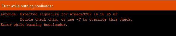

Each microprocessor has a signature – a unique code that identifies its model. When you bootload a chip (or even upload a sketch) the Arduino IDE checks that the chip selected matches the type it’s connected to. Even though the ATmega328-PU in essence functions in the same way as the ATmega328P-PU, it has a different signature, and one that isn’t recognised by the Arduino IDE.
(Behind the Scenes: The Arduino IDE actually uses AVRDUDE to programme the chips, so you’ll see error messages from avrdude)
If you try to bootload an ATmega328-PU, you’ll get a message something along the lines of:
avrdude: Device signature = 0x1e9514
avrdude: Expected signature for ATMEGA328P is 1E 95 0F
Double check chip, or use -F to override this check.
You could also get a more colourful version:
avrdude: Yikes! Invalid device signature.
The way to work around this is to “trick” the IDE into believing your 328-PU is in fact a 328P-PU. Disclaimer: I have tested this myself and it works – no guarantees however that you won’t have unforeseen consequences.
Workaround:
In your Arduino folder, find the subfolder: ..\hardware\tools\avr\etc
- Make a backup copy of the file: avrdude.conf
- Open the file avrdude.conf in a text editor
- Search for: “0x1e 0x95 0x0F” (this is the ATmega328P signature)
- Replace it with: “0x1e 0x95 0x14” (this is the ATmega328 signature)
- Save the file
- Restart the Arduino IDE
- Continue with the rest of the steps in the instructable, and once bootloading is complete restore the backup copy you made.
