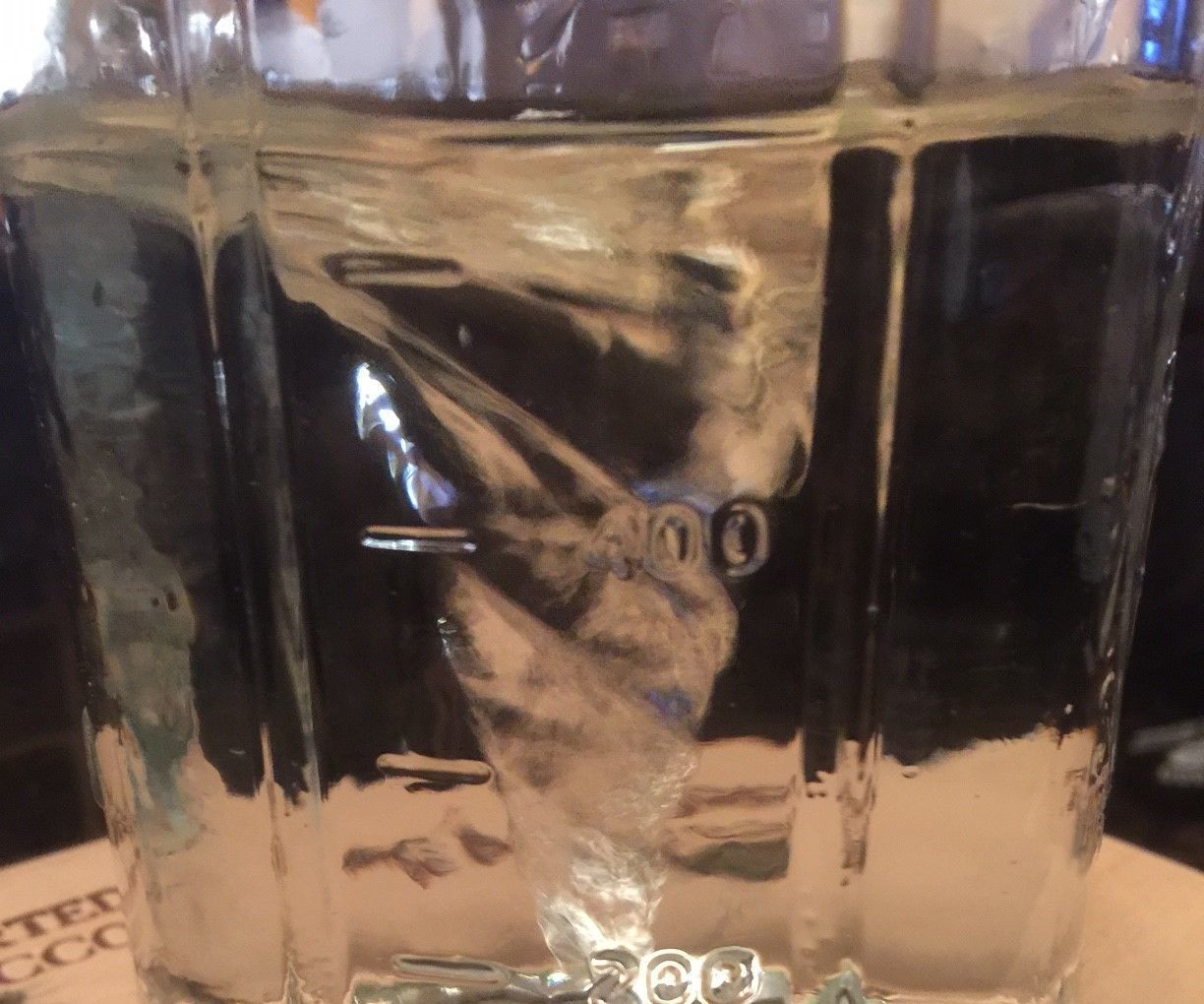

Step 5: Update
Okay, so today I washed a particularly grungy batch of bottles that someone gave me and I took a few pictures of the washer in action. First, I ran them through the dishwasher to remove the labels and clean the outside, then I used the washer. As you can see, the water shoots up nicely into the bottles and did a good job cleaning them. I ended up letting the washer run for 30 minutes just because I wasn’t really sure how long to go. The bottles all looked good so I am happy with that time. Also, I used a dishwasher soap pod for my cleaning agent and that seemed to work nicely. As you see it foamed up a little but not bad at all for all of the agitation.
Also, I added a quick disconnect to the pump. This really made it a lot easier to move things around and the big reason that I wanted it is because I plan to make a carboy washer and I would like to use the same pump. This has been my plan all along, that is why I added the extra valve at the top. When I get this finished, I will either make an update or I will make a new instructable.
Last, I hooked up the demo pen riser to see how well it would work, the water hit the ceiling in the shower so I didn’t get a chance to get a picture. I knew it would have better flow, I just didn’t know it would be that much. If I were to do it again, I would use the pen for sure! I may even go back and retrofit what I have. We will see. I am pleased with how well it worked so I don’t know if I will or not.
Step 6: Final Update
So I changed it over to the pen body. This has much better flow - so much that I actually closed the pressure relief valve all the way. This is the way to go. Much better flow. Cheap and easy way to do this.
