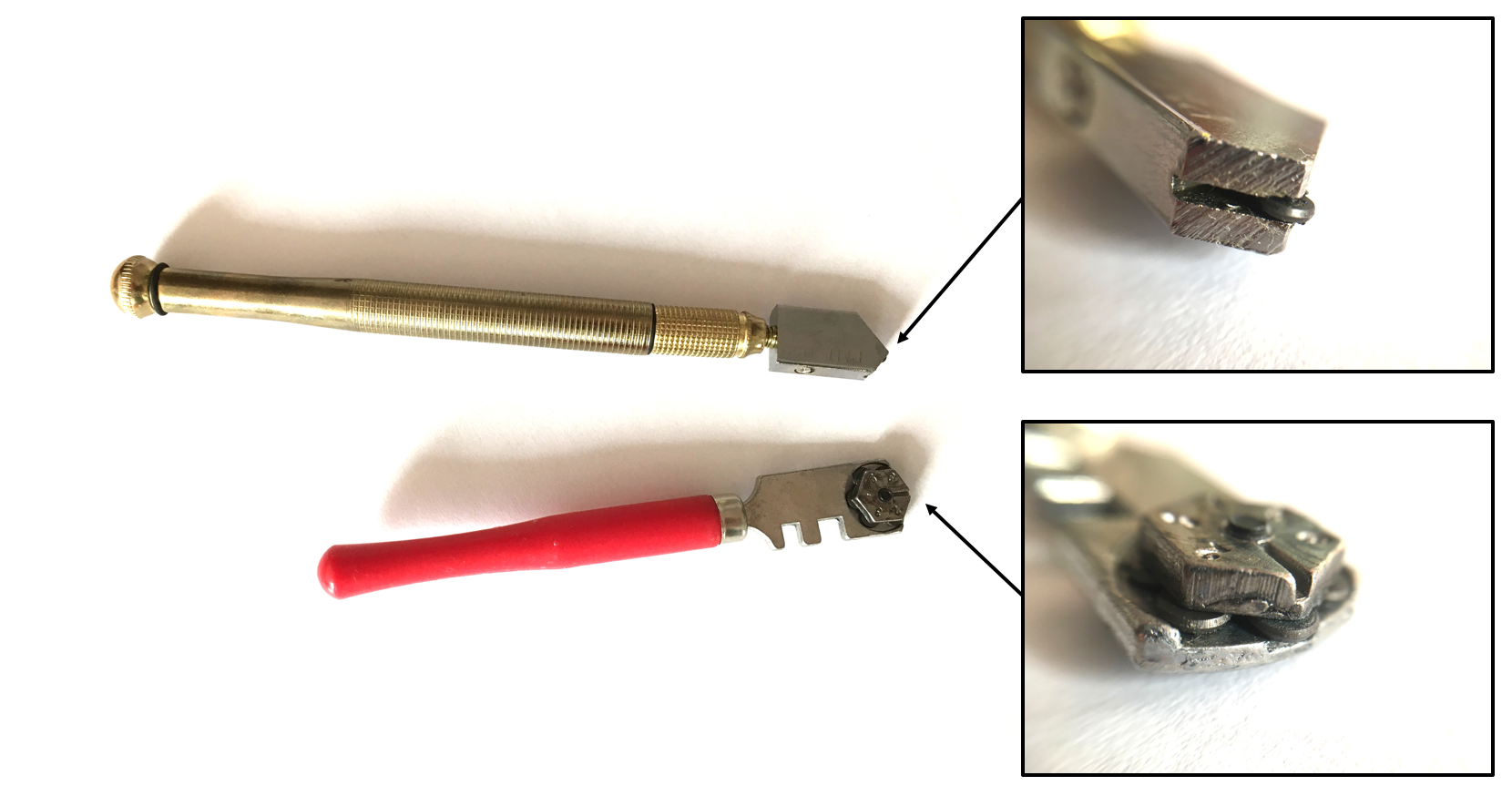

- With a glass cutter.
- With a rope.
- With a bottle cutter (highly recommended).
Be aware that if you use the glass cutter and the bottle cutter, a light score is enough to cut the bottle. During my first tries, I made the mistake to score multiple time at the same place, and I think it damaged both the cutting wheels and the bottle. Check the last gif of this step to see the kind of score you want to make.
And honestly, the bottle cutter is the best technique. It makes smooth and straight scores on the bottle, and the cut is perfect.

First, I tried to cut the bottle manually with a bottle cutter as follow:
- I scored a line with the cutter all around the bottle.
- I placed the bottle in cold water.
- Then in hot water.
- And I repeated these 2 last steps until the glass broke.
But the first step was really difficult and I had to try several times until I made a straight line all around the bottle. And the cut was not straight.

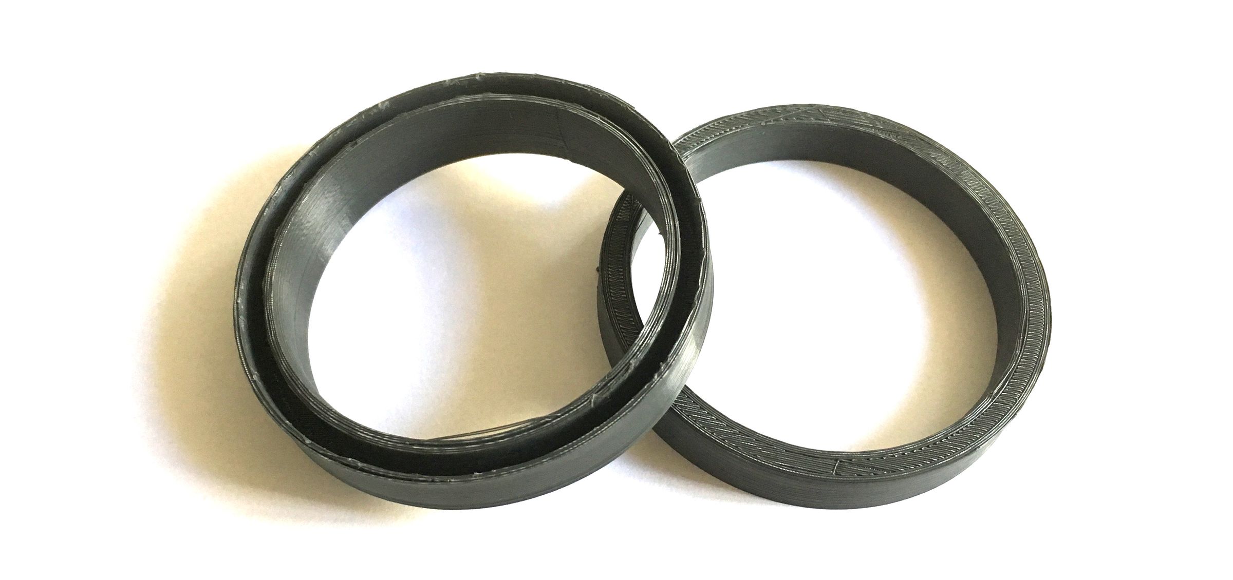

Now that the bottles are cut in half, it is time to join them back together. So I designed 3 different joints that I thought interesting:
- Simple joints. Just one joint on each half bottle. The upper joint is placed on the lower joint. And this is it.
- Hinge. I used the simple joints and added hinges.
- Screws. There are screw threads on each joint.
These joints can be used with large glass bottles (diameter of 80mm / 3,46457 inches).
I designed them with Fusion 360. I won't explain in details how I have done this. I basically measured the diameter of the bottles. Then playing with "sketches", "circles" and "extrusion", it is easy to make these joints. For the screws, there is a dedicated tool ("create -> thread"). If you are having issues making these joints, please leave a comment below or send me a private message, I'd be happy to help!
You can download the files on my account on cults3D by clicking here.
#1 Simple joints
You can see that there is a slot on each joint, to place the cut edges of the bottles.
