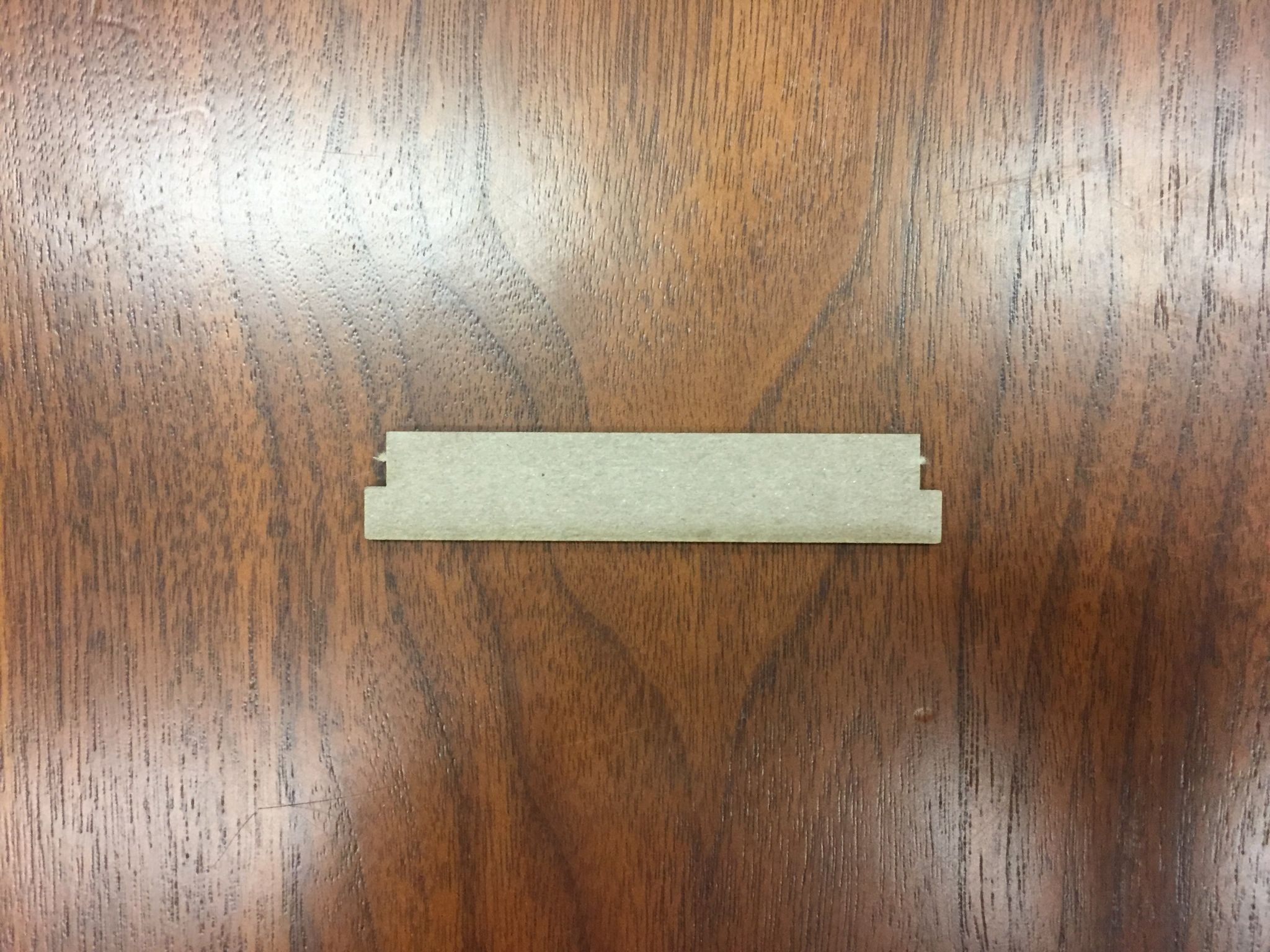

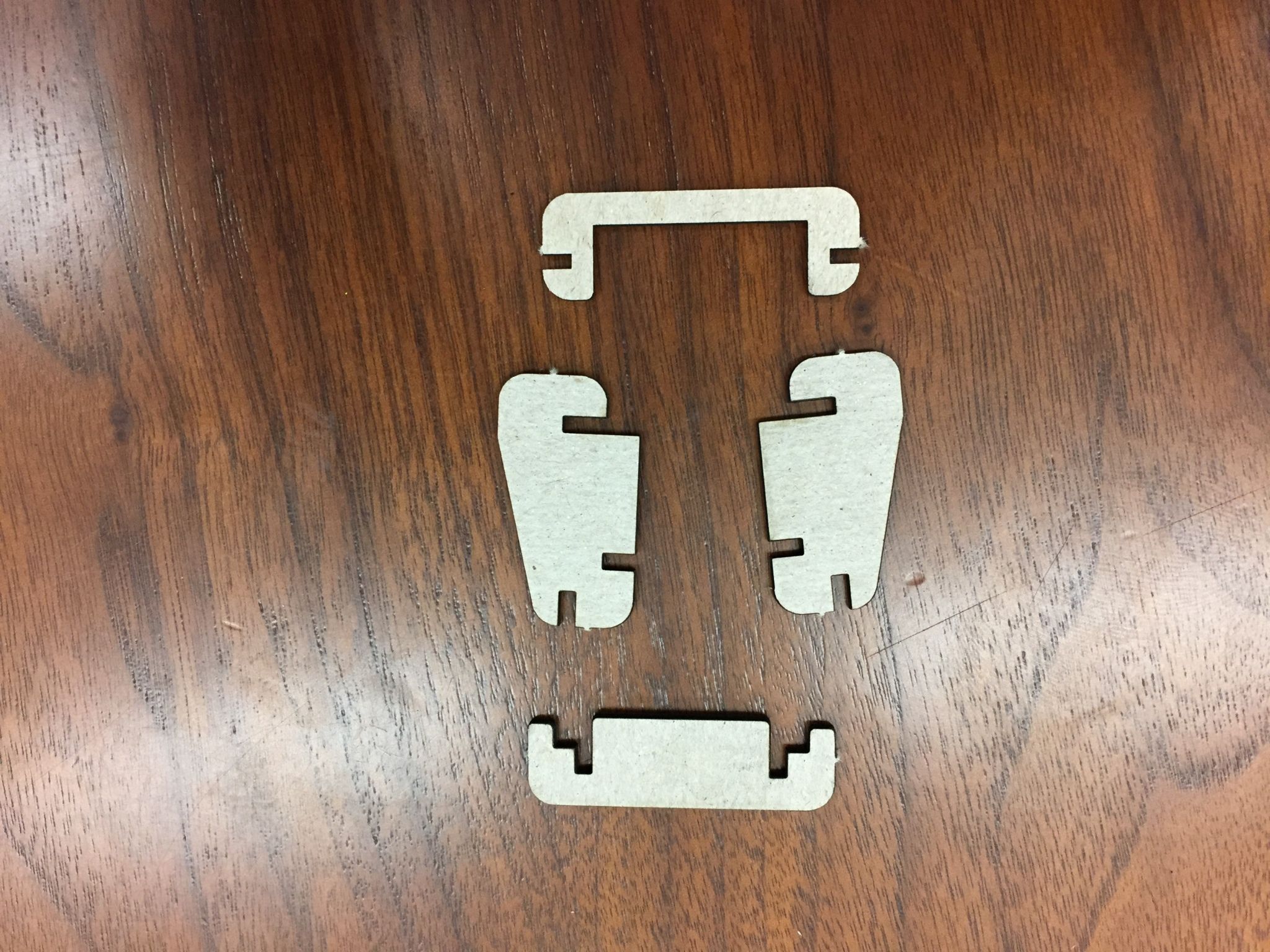

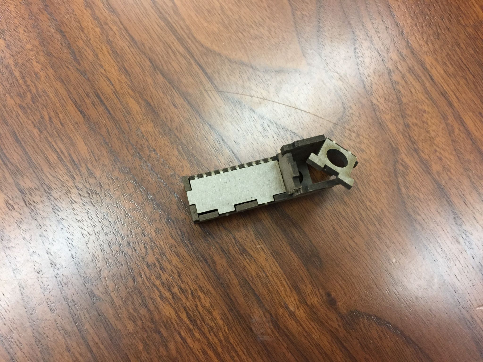

Camera insertion (optional). Remove the camera mounting bracket.
Slide the two camera side mounts into the notches on the front of the retainer.
Slide your Pi camera into the mount and then add the top & front reinforcers to keep the camera snug. The picture below shows the camera mount without a camera; please refer to the video to see how the actual Pi camera fits into TJBot.

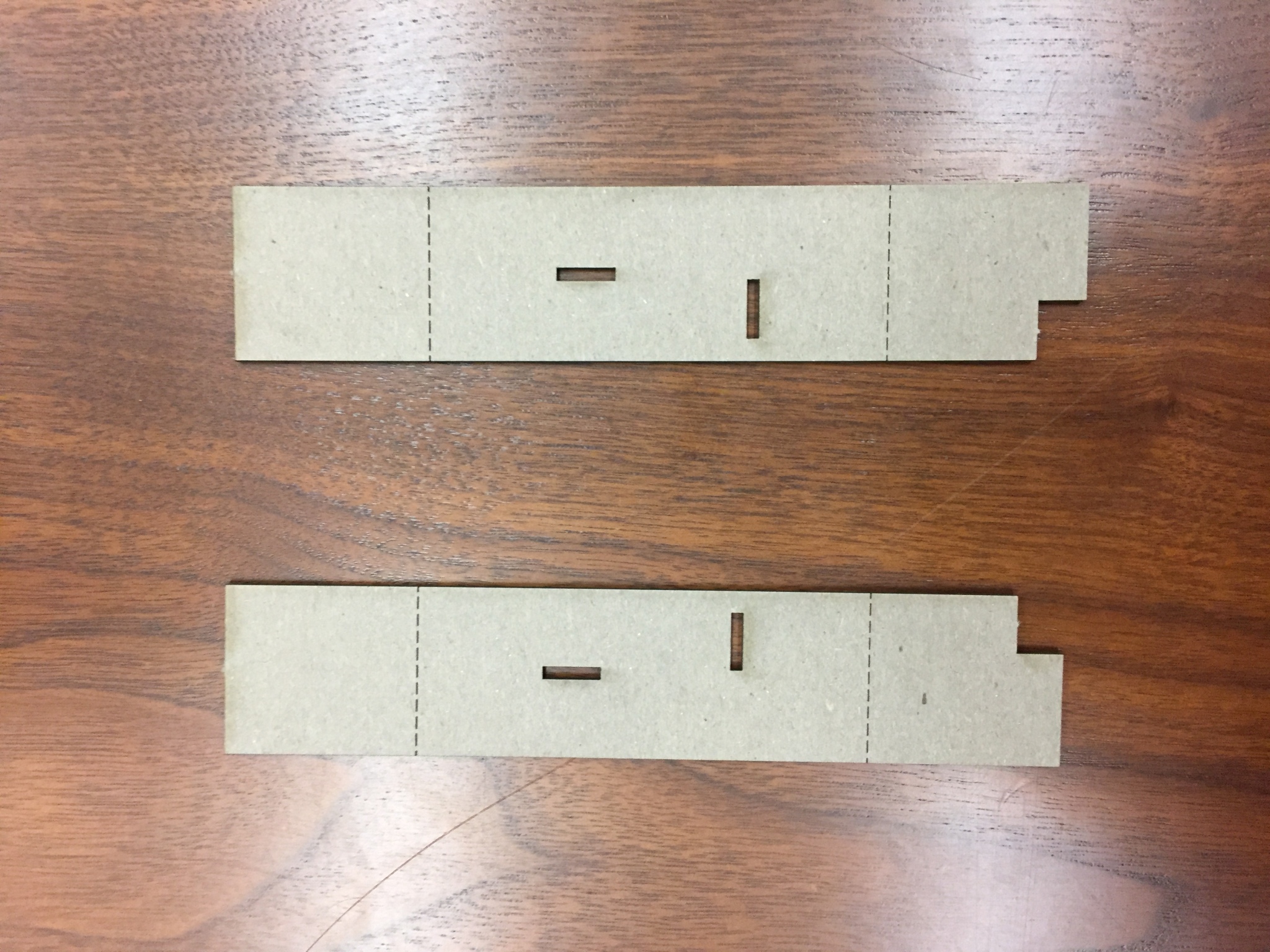

The last step is to fold TJBot's arm. Remove it from the main chipboard.
Beginning from the outermost seam, fold everything toward the center rectangular piece (the one with the circle).
Fold the small square piece with the hole inwards.
Fold the remaining pieces inwards.
Fit all tabs into the notches to complete the arm.
