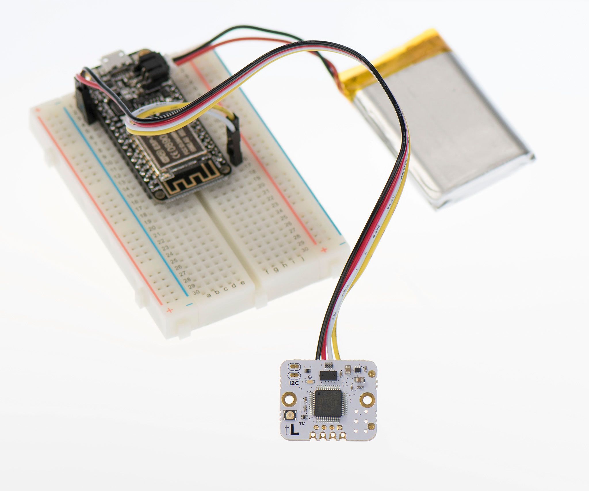

Step 2: Let's Build It!
The first diagram above shows the dimensions of the right angle bracket we made from a spare piece of .063" thick 3003-O aluminum plate we had in the lab but you can also try 5052 or 6061 alloys. We used two of M2 x 6mm socket head cap screws with 0.4mm thread pitch to mount tinyLiDAR to this aluminum bracket but any M2 screw longer than 4mm will work. Thread pitch is not important as the aluminum is very soft and will accept any reasonably coarse thread when you drill a 1/16th inch pilot hole first.
We then used double-sided foam tape to affix the bracket to the round plastic platform which screws into the analog servo. This round platform was included with the Seeed servo. Make sure to cover the mounting areas with insulating tape like Kapton/polyimide tape, electrical tape, etc. before mounting tinyLiDAR in order to prevent shorts.
The second diagram maps out some of the technology we put into tinyLiDAR and the Fritzing diagram shows connection details to the Arduino UNO.
Sketches for the Arduino UNO and Processing development environments are provided below. Please read over the code to become more familiar with it before using.
The Processing programming language/environment maybe new to you but it will look very familiar when you download (from processing.org) and install it as this was the basis for the Arduino IDE. Programs on this system are also called "sketches" but this language was developed more for the visual arts field. This is the reason why you see draw() instead of loop() for the central repeating code block.
Operationally, your Arduino UNO is used to control tinyLiDAR via I2C and then send measurement and angle data over a virtual com port to the Processing sketch for display.
The only Processing configuration detail you may have some trouble with is the error that says "OCR-A" font is missing. To install it, just go to Tools\Create Font\, then choose the OCR-A font, set the size to 30 and press OK. This will create the required ".vlw" file in a data folder inside of your sketch folder.
Also if you don't have a Microsoft Office product installed already on your computer then you maybe missing this font altogether. If so, then you can download the "OCRA.ttf" file from here. After this, you can go thru the steps outlined above to create the font inside of Processing. As the two sketches communicate via a virtual serial com port on your computer, you will have to change the assigned port number as needed in the Processing sketch. It will be the same com port number that's used by your Arduino.
