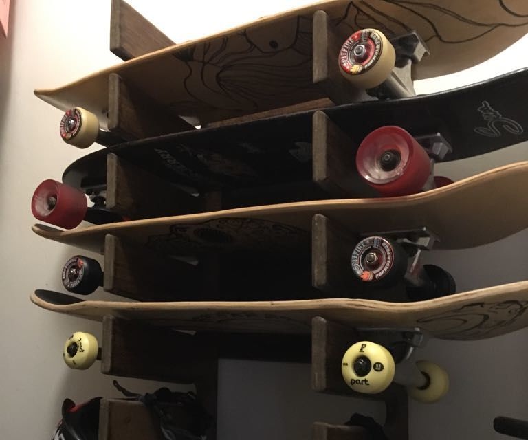

Step 5: Final Step
Once the grip is on and all steps are done, you just need to put the trucks and start riding.
I used Spitfire wheels and Indepedant/venutre trucks.
Enjoy!
Don'h how to store your boards? Try my simple skateboard rack
