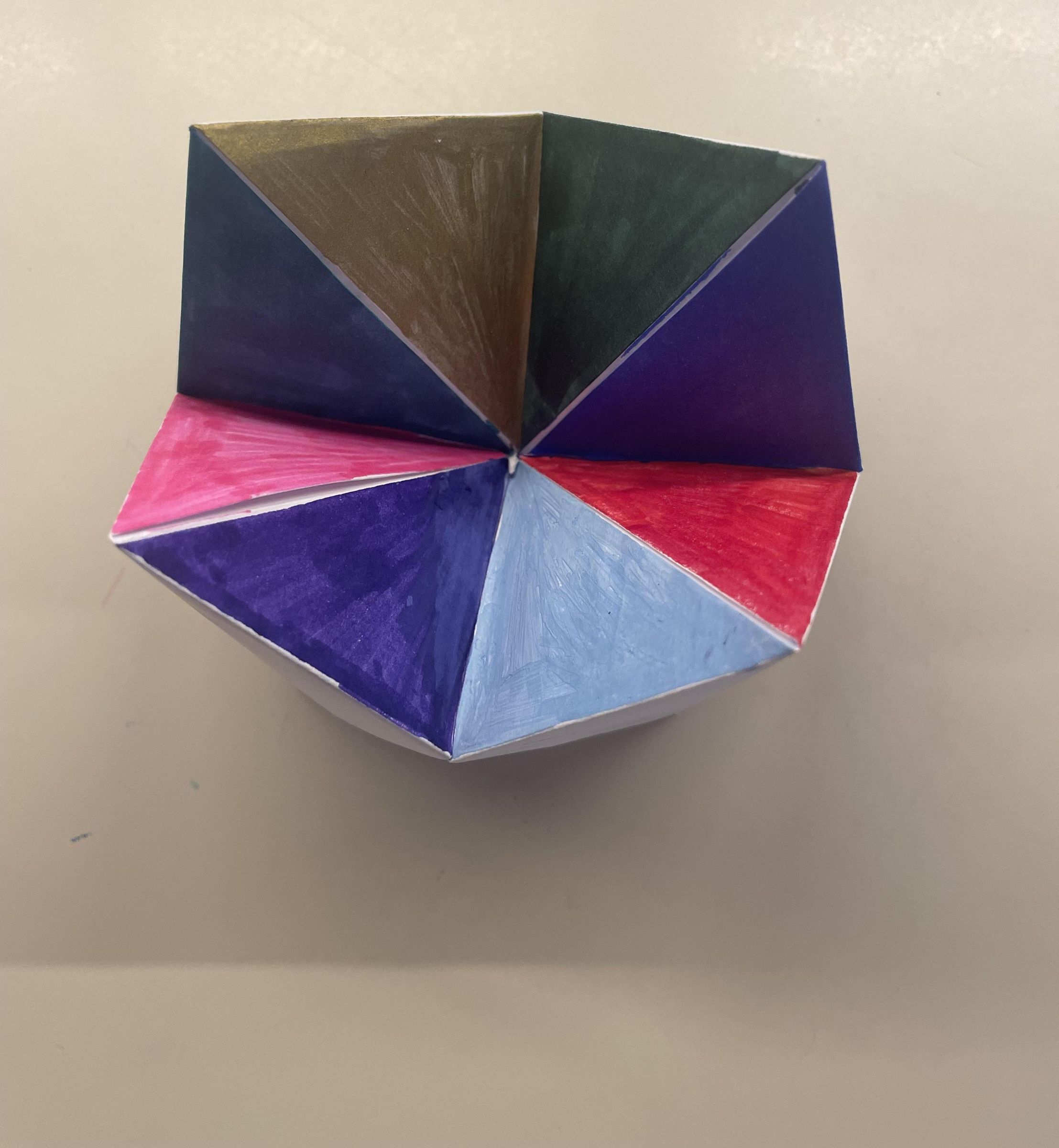

Step 10: Enhancements and Future Improvements
Now that you've successfully built and tested your learning assistant system, here are some additional ideas to further enhance and customize your project:
  • Enclosure for ESP32 and Components:
  • Create a custom box or enclosure to house the ESP32, LED strip, and other components. This will not only make your setup look more professional but also protect the electronics and make it more convenient to use.
  • Expand Functionality:
  • Consider adding additional modes like a Lunch Break Mode or Longer Break Mode (using the remote buttons). If you upgrade your MAKE.com account, you can create more complex scenarios to make the system more intelligent and tailored to your needs.
  • Enhance the Blynk Dashboard:
  • Add interactive controls like sliders or buttons to adjust study and break durations directly from the Blynk app, without modifying the code.
  • Personalize the Experience:
  • Customize the motivational messages in the Telegram Bot to keep you engaged. Adjust the Google Sheets data to better reflect your goals and track your progress.
  • Upgrade LED Strip:
  • Use an LED strip with more LEDs for more precise time visualization. You can modify the code to control additional LEDs, enhancing the feedback during study and break sessions.
  • Adjust Study/Break Durations:
  • Feel free to modify the code to change the study and break durations according to your preferences. Whether you prefer longer study periods or shorter breaks, the flexibility is in your hands.
  • Integrate Additional Sensors:
  • Add more sensors like a motion detector, light sensor, or sound sensor. For example, a motion sensor could pause the study timer if you leave your desk, making the system more interactive and responsive.
  • Explore Voice Control:
  • Integrate voice control using Google Assistant or Amazon Alexa, allowing you to start and stop study sessions with voice commands.
These enhancements will help you create a more personalized and effective learning assistant system, with endless possibilities for further development. Experiment with these ideas and make the system truly yours!
