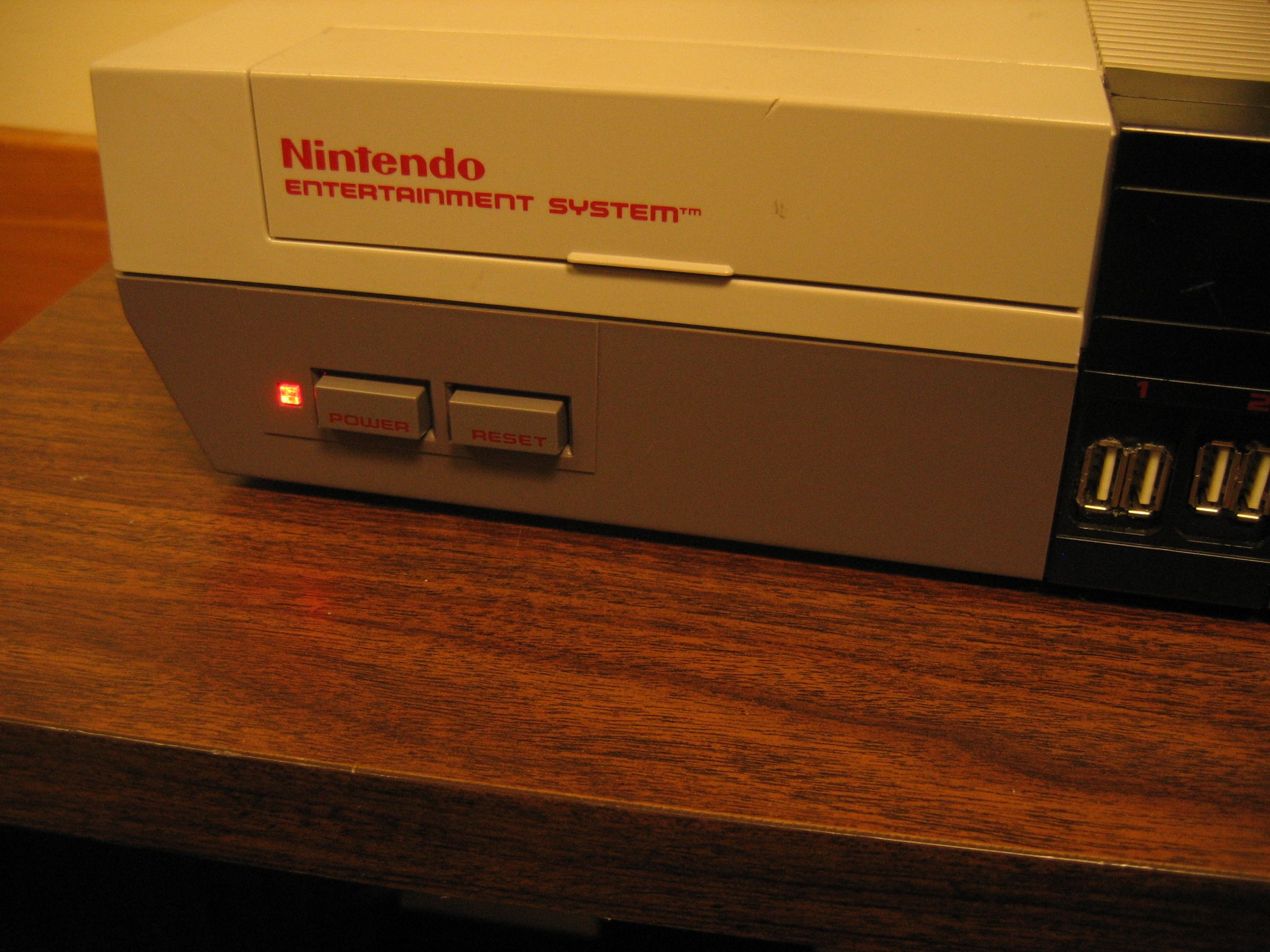

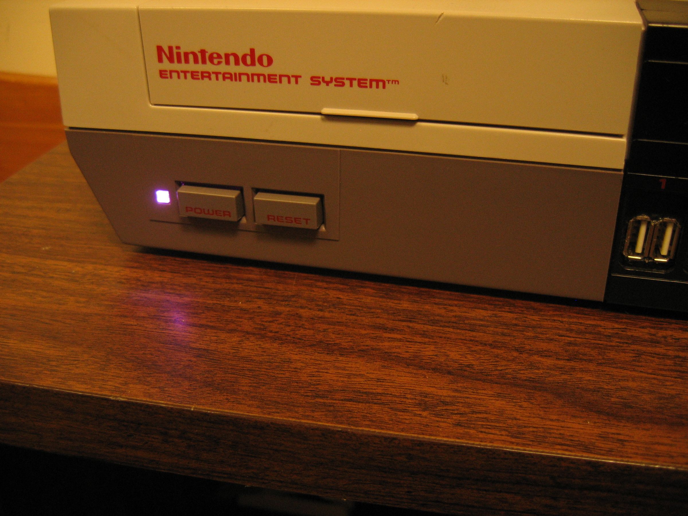

Step 10: Final Form
As requested, here's a few pics of how the NES PC looks at the moment.
