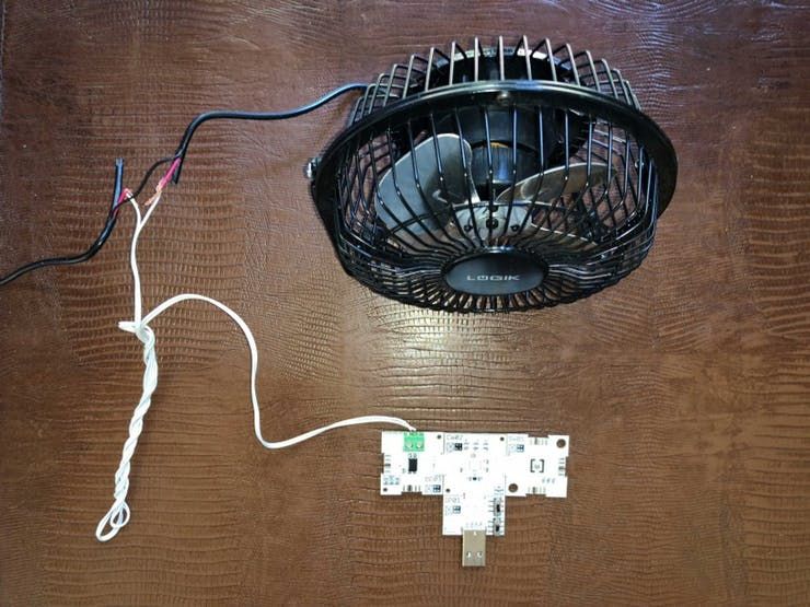

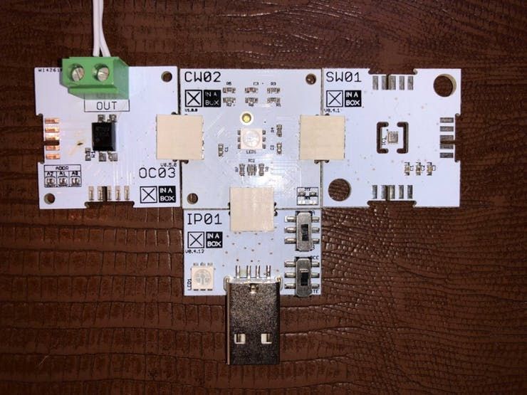

Step 3: Hardware Setup
Connect the xChips according to the photograph in Figure 1, making sure that the xChip name and XinaBox logo are all visible from the same side. Ensure that the switches on the IP01 xChip are in position “B” and “DCE”.
Figure 1: xChips assembled
Figure 2: xChips and fan
Connect bell wire to the OC03’s terminals. As shown in Figure 2, cut either of the Fan’s USB power wires and connect the two ends to the bell wire, creating a switch.

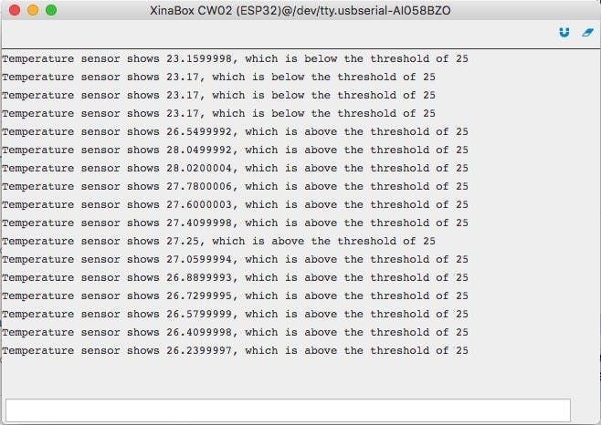

Figure 3: screenshot of Zerynth Studio
On running, the serial monitor shows the results of one of the print statements (see Figure 4), depending on whether the temperature is above or below the set threshold. This is useful to ensure our IF statement is working properly, and also to see the temperature data, so we know the sensor information is being properly received by the CW01 and being received correctly by Zerynth.
If the temperature is above the threshold, the CW01 LED will light, and the OC03 completes the circuit, switching on the fan.
Figure 4: Serial monitor output
Please see below video showing the fan operation; initially, the fan switches off again quickly, as the fan's airflow lowers the temperature sensor reading. When the fan is repositioned not to blow on the sensor, the temperature sensor stays above 25 degrees Celsius, and the fan (and LED) stays on.
