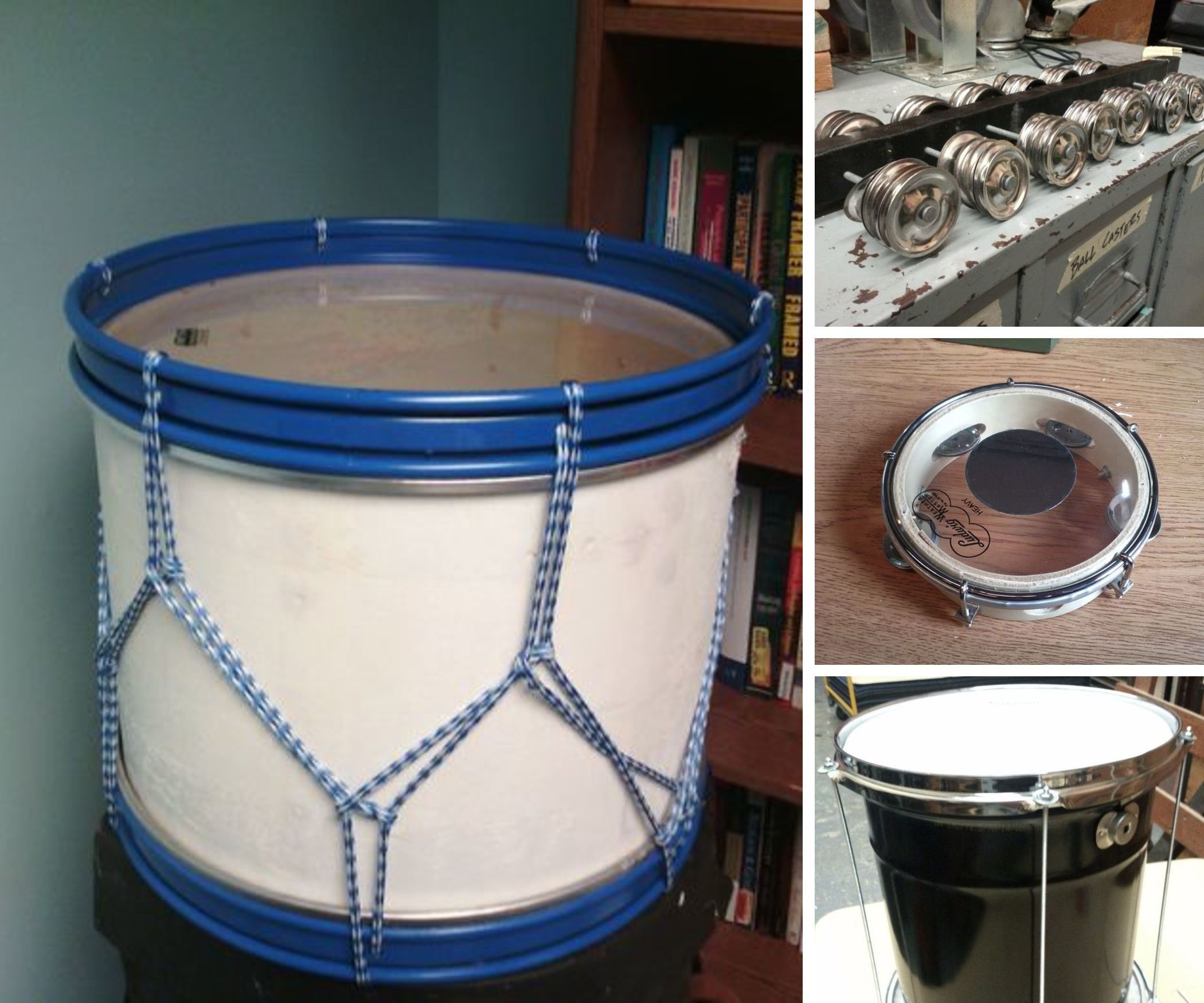

The next item in my series of DIY Brazilian instruments is my tamborim. This version includes jingles (like Meinl's "patented" tampeiro), but you can just as easily cut these out. I like the novelty of the sound, so I kept them on for this build. While my previous repinique build was mostly to save money, this tamborim build was mostly for the fun of doing something on my own. A new Meinl tamborim will cost you $30 retail (http://goo.gl/YXTA4s), while the total cost for this build will come in around $20 or so depending on the cost of the hooks and lugs.
