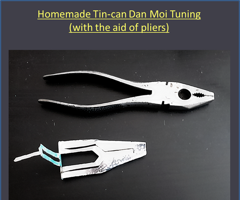

Step 8: Extra Mechanical Machining
You need here to finish the work undone by the current. The reason you do not wait until the end is to avoid a too intense corrosion at some location, it could be very unpleasant.
So you need to scratch again with the screwdriver, but this is done quite fast and with little effort, eletrical fairy did a good´but unfinished work.
You will be then able to separate each prong subpart.
Sand off the edges of each subpart with the aid of the file.
I also cut a bit of the side of the outer prong subpart.
You can already notice the difference by eye. This operation turns the prong to be weaker near to the base, to get a larger amplitude when it will vibrate. But as a near effect it will be at lower frequencies.
Step 9: Final Stage: Folding the Dan Moi
You need to fold the metal sheet at different locations with the aid of a pliers:
on the base (upper part), you need to fold 90° (but after the "cut" location, so that those stay together)
This fold allow then to fold the middle prong subpart as follow:
the middle prong subpart is fold at 180° from the outter prong subpart.
The inner prong subpart is fold at 180° from the middle subpart.
Middle and inner prong subpart are forming the plug of the dan moi!
the outter prong subpart the tongue!
(you can use a flat surface to help you to get 180°)
Fold the side of the frame of the dan moi at 90° or little more. But avoid any hinderance of the vibration of the main prong part: the reed.
Do not fold the whole side, let 1/third of space from the base (this is the spring frame part! the folded part will be the rigid frame part of the dan moi!)
Try to keep the frame part straight with the reed during that operation!
So then this is a serie of trials and errors to place the central reed/prong to vibrate freely without touching the frame. Once you get there, you will enjoy your new dan moi with a modern living hinge design!
