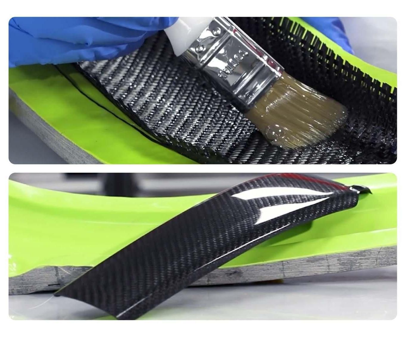

Next, accurately measure and thoroughly mix up a quantity of hand laminating resin (according to the manufacturers instructions) to attach the peel ply and in turn the carbon fibre. Always ensure that you double-pot the resin to avoid unmixed resin getting on to the project.
As a rule of thumb, the amount of resin needed in hand layup is approximately the same as the weight of the fabric reinforcement:
  • Brush apply a layer of resin on to the former
  • Drape the peel ply over the resin and then wet out the layer using the brush to drive the resin up through the fabric
Step 5: Laminating the Reinforcement
Now that the peel ply had been wetted out, the layers of carbon fibre can be applied and wetted out one layer at a time.
Repeating the process with each layer or 'ply'. Take special care working the resin into the fibre of the fabric and if needed use flat spreaders, squeegees or a finned rollers to spread the resin. The aim is to wet out the fibres fully but without leaving an excessive wet film or causing the resin to pool on the surface.
Once the layers of reinforcement have been applied, the edges of the fabric can be trimmed off to neaten the edges. The laminate is then left to fully cure according to the manufacturers instructions.
If like in our project, you will need to prepare for the second half of the layup, the edges of the carbon are de-nibbed and keyed up using 120 grit sandpaper and cleaned up before completing the 2nd half of the lay-up.
Repeat the process for the top half of the lay up and once complete leave to fully cure.
