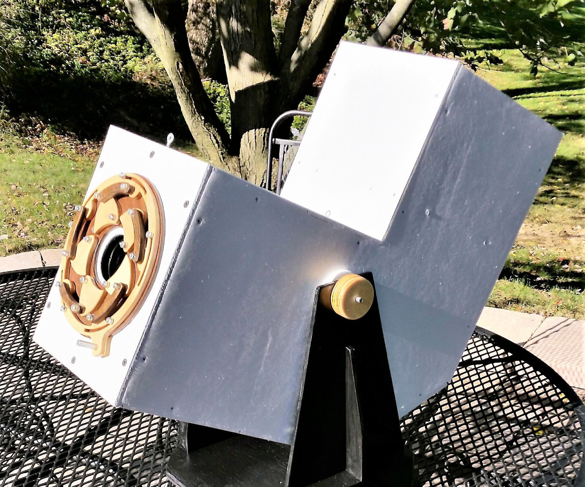

Step 17: A Photo of the Completed Solar Projector
Here is the photo of the final design.
The lens cover is based on an iris mechanism by Carl Bass on Instructables, https://www.instructables.com/id/mechanical-iris-1
Should you decide to build the iris mechanism for either a solar projector like this or just because you think it is neat (that's really why I built it!) don't feel that you have to have the pieces cutout with a CNC machine. There is nothing wrong with doing that, but I just printed out the design on paper, glued it to some "good" 1/4" plywood and cut it out with a scroll saw. CNC is obviously easier, but the scroll saw did a good job...it just took longer.
