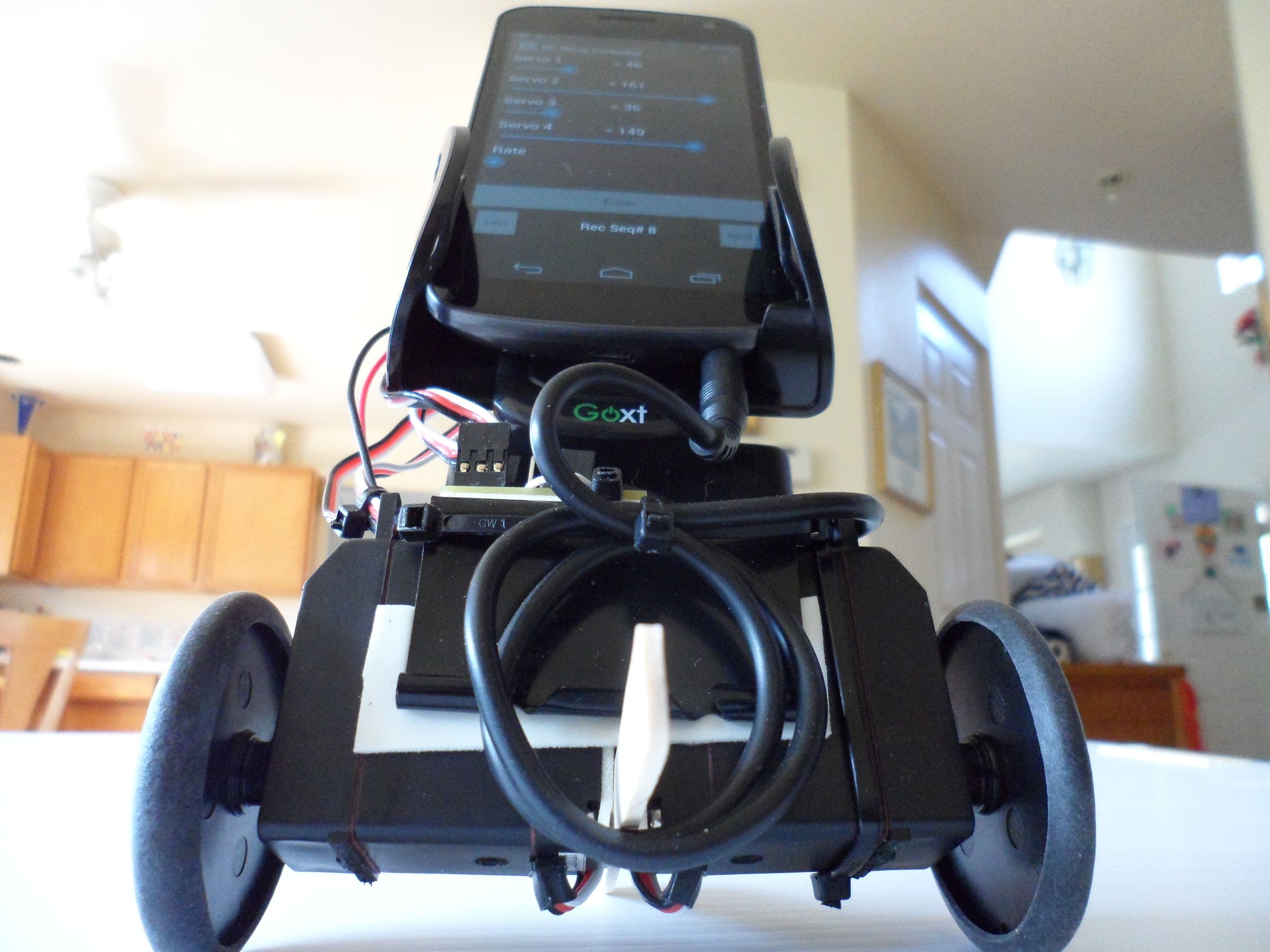

Step 7: Modify Plastic "Over the Door Hook" to Mount Smartphone
Purchase a plastic over the door hanger. Snap hanger in half. Mount hanger (as shown) to tank using double sided tape. Stick velcro (hooks) squares to vertical portion of plastic door hanger (as shown). Stick velcro (loops) to the back of your Android device.
