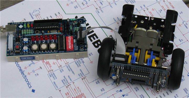

Introduction: Building the Mongoose Mechatronics Robot: Part 1 Chassis & Gearbox
This is the first of a series of illustrated instructions for assembling the Mongoose Robot kit available from blueroomelectronics

Step 1: Preparing the Gearbox for the Dual Rotation Sensors
The Mongoose uses a Tamiya Double Gearbox. Part T4 requires a simple modification to allow the optical rotation sensors to monitor wheel rotation.
Simply remove by sanding or cutting away 5mm of material (plastic) from the main gearbox casing as shown in the illustration below.
Step 2: Adding the Rotation Encoders to Two Blue Gears.
The blue gears as shown below are IR transparent, so we're going to add IR opaque aluminum foil to a set of gears one for either side of the gearbox (the blue gears are all identical so any two will do)
The kit includes a small piece of self adhesive aluminum foil with a hole punched in the center.
You will need two of the blue gears as supplied with the kit.
- Cut the foil into four pieces using the hole as the center.
- Remove the adhesive backing from the foil only when you're ready to apply it
- Apply two foil pieces to each gear, each foil piece should be opposite each other.
- Carefully burnish the foil onto the gear with a toothpick or soft burnishing tool (the example below use a piece of spruce from the gearbox assembly)
- Carefully trim away excess foul by slowly running a sharp hobby knife through the foil as show in the pictures below.
