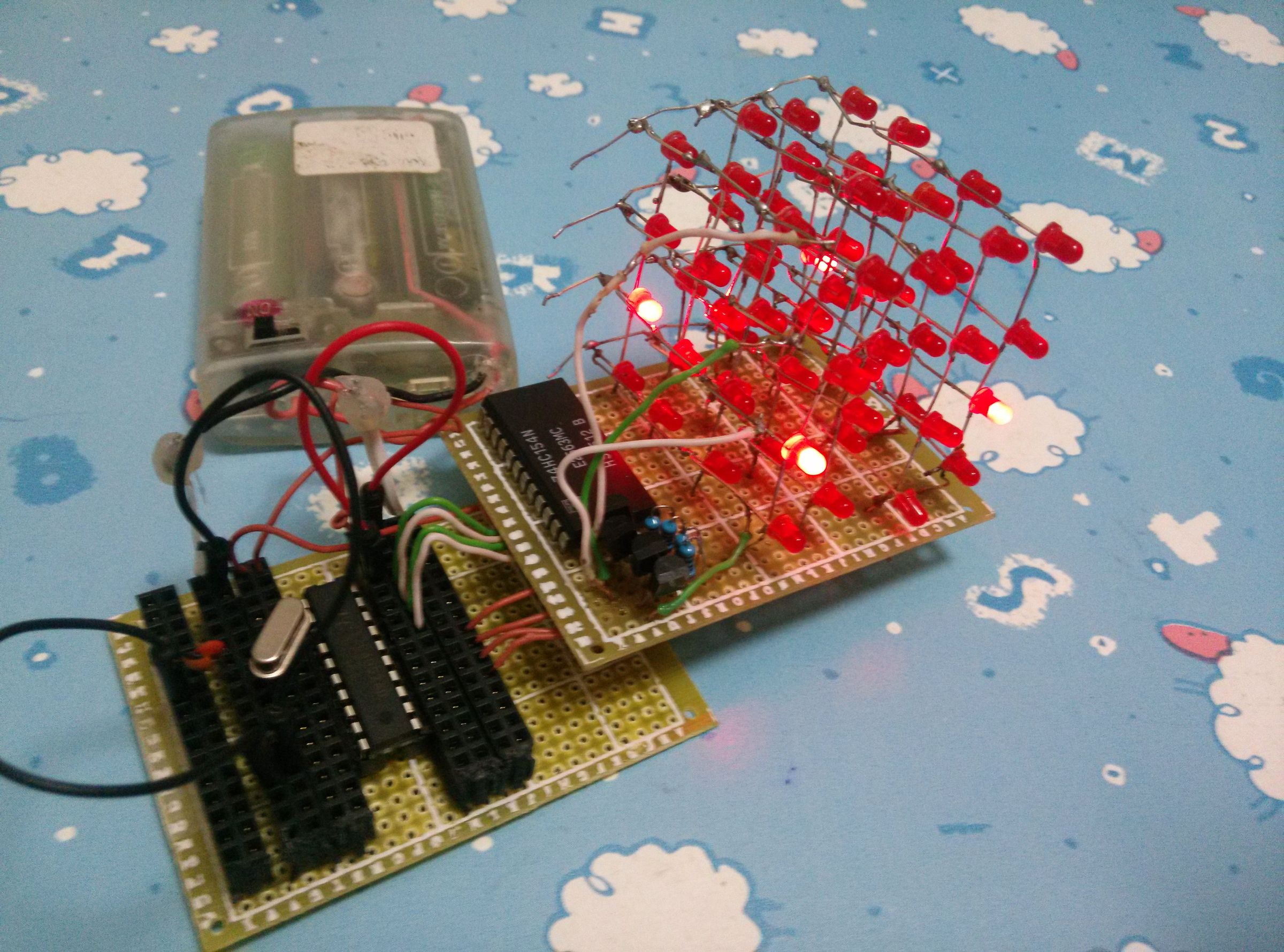

Step 1: Open Sketch ArduinoISP and Setup Wires
So I open the ArduinoISP sketch to check. Then found most instructables have missed one link: connecting pin 10 of Arduino to pin 1 (reset) of Atemega328P. I connect that then everything works. Of course that is afer serveral trials.
Connect as captured. First column refers to Arduino Diecimila, second column refers to pin of Atmega328p
Pin 10 -> pin 1 (this is very important for my case, without it the IDE prompted error then failed to burn)
Pins 13, 12, 11 -> pins 19, 18, 17
Pins 10 -> pin 1
Vcc -> pins 7, 20
Gnd -> pins 8, 22
And connecting crystall and capacitors to Atmega328p
Crystal 16Mhz -> pins 9, 10
Capacitor 22pf -> pins 8,9
Capactior 22pf -> pins 8, 10
Now hardward parts set. Then plug the Arudino Diecimila to your computer and following the steps next.

Step 2: Upload ArduionISP Program and Start Burnning Bootloader
I know my Arduino is Diecimila with Atmega168p and I am going to burn Arduino UNO to my Atmega328p. Here it goes.
First upload program to set my Diecimila as ArduioISP
1. select Tools -> Board -> Arduion Diecimila or Duemilanove w/ ATmega168
2. select Tools -> Programmer -> AVR ISP
3. compile then upload the ArduinoISP sketch. You should see "Done upload"
4. now select Tools-> Board -> Arduino UNO
5. select Tools -> Progammer -> Arduino as ISP
6. click Burn Bootloader. In a minute you should see "Done burning bootloader"
If you are lucky, you easily reach step 6 in one minute. To burn a second Atmega328p, unplug usb cable, swap a new one in your breadboard then plug in usb cable and run step 6 again.
If any error found, check the wirings then follow the steps one by one again.
