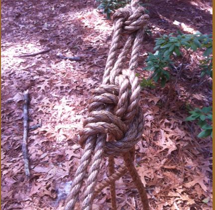

Step 2: Form Loop 1
Form a large overhand loop (Loop 1).
Step 3: Form Loop 2
Twist Loop 1 forming a second overhand loop (Loop 2).
Step 4: Working With Loop 2
Pass Loop 2 under both Loop 1 and the Standing Part. (Loop 2 is now the "running end.")
Click here for Knot Tying Terminology.
Step 5: Tying the Knot
Pass Loop 2 back over the Standing Part and down through Loop 1.
Step 6: Forming the Fixed Loop of the Butterfly Knot
Pull Loop 2 completely through Loop 1.
Step 7: Dress the Knot
Finish the butterfly knot by tightly pulling Loop 2 and both sides of the Standing Part.
